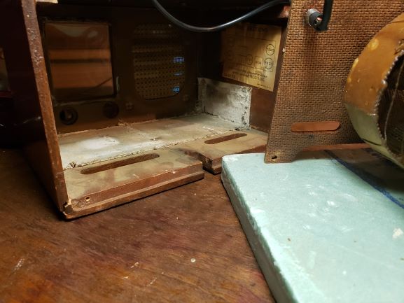

Picture of asbestos layer.  There is fraying along the edges.
Looks like that asbestos layer is glued to the cabinet. If so take it out would be problematic and cause lots more fraying putting fibers into the air. If it were my set I would not attempt that. I know at my previous workplace there would be asbestos insulation that was coated from time to time to keep it intact and not breaking down. I would probably coat it with a shellac (others may have other thoughts on this) and leave it as is.
One thing. If you do coat it (and I agree with Bob that you should), PLEASE take the cabinet OUTSIDE and spray the asbestos with shellac! DO NOT do this indoors!
Also, use a respirator. You don't want to breathe those fibers. While only a small amount probably won't kill you, why take any unnecessary risks?
Thank you Ron and Bob for the feedback.  I reinstalled the cabinet to await Phorum input.  I have no desire to remove it and will shellac as recommended, outside.
