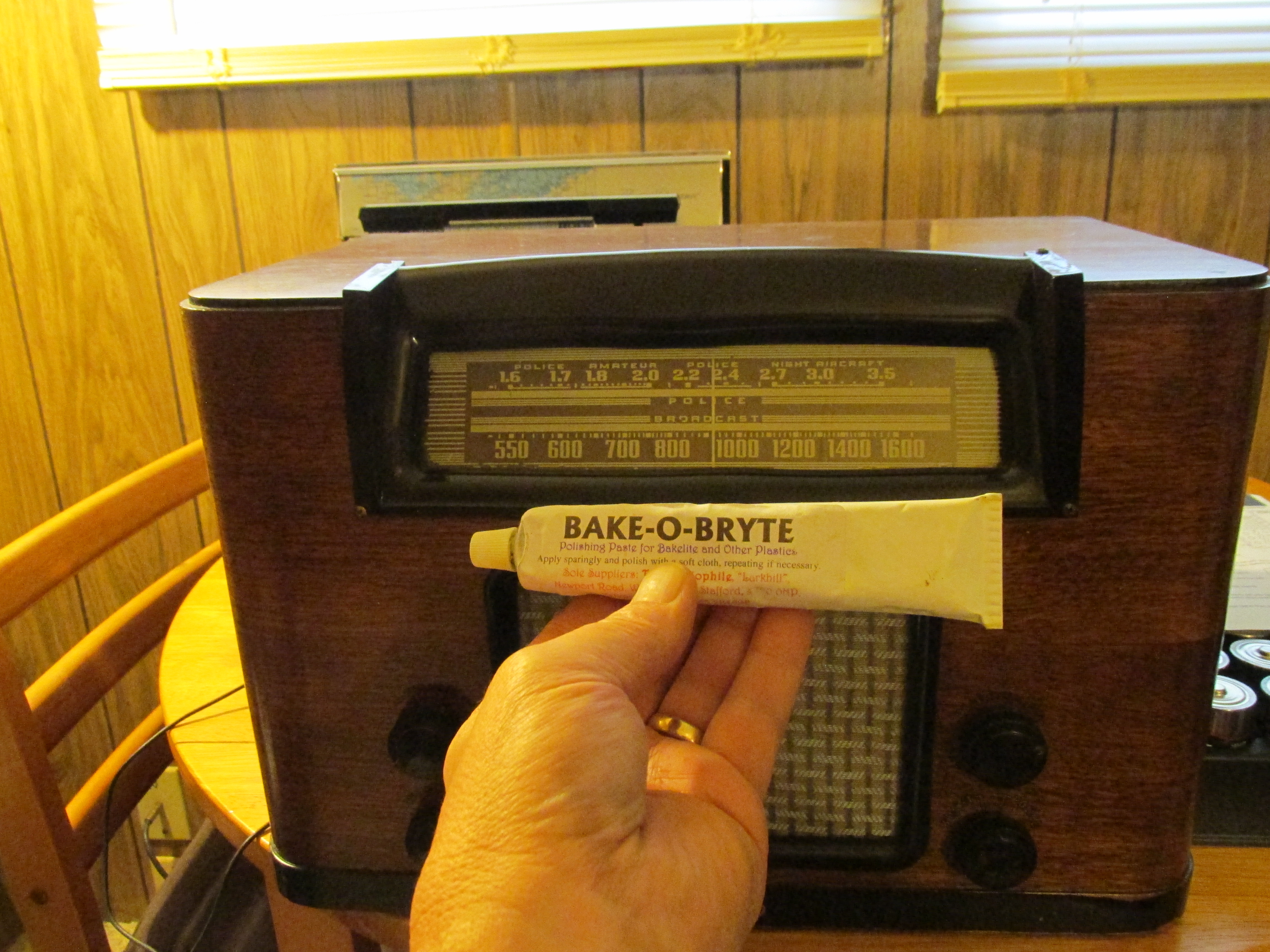

It is called Bake-O-Bryte.  And it works great on all Bakelite and soft plastics.  It come in a tube about the same size as toothpaste, it does not take much to get a positive result.  Give it a try.

Pardon the condition of my tube of the stuff....it's well-used and LOVED Heart

This stuff really kicks rump!  Yes, I use Johnson's Paste Wax in the final step.  Getting off the oxidation is where Bake-O-Bryte comes in.  It has been over few months and the finish on my bits and knobs sure does look swell!! Icon_biggrin Icon_biggrin
Buy the stuff, YOU'LL LOVE IT!!  Notes to the wise....(Don't use a Dremel on high speed setting...OWWZA!). Icon_eek Icon_eek   Use a cloth.

You do realize that the escutcheon of the 1941 Philco in the first picture, first post, is Tenite and not Bakelite, yes?
Other than that...thank you for informing us about Bake-O-Bryte. Icon_biggrin I have some knobs that could use the treatment...
