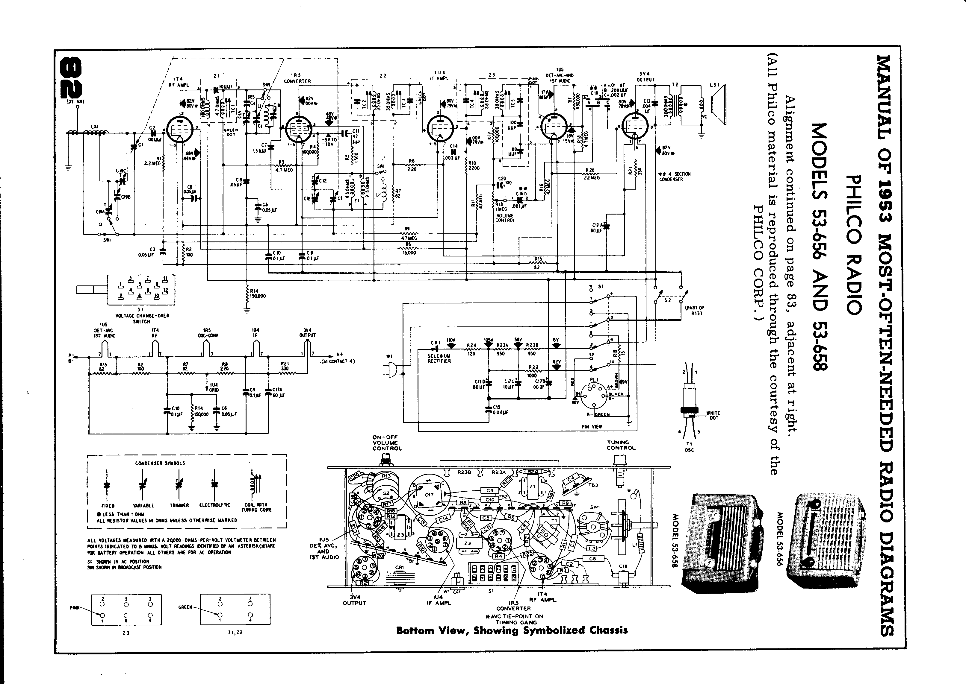

Gezz that an awful schematic.
Thanks Terry. Appreciate your help.
Yes, the schematic is tough on the eyes, even printed on 11x17. Photofact is on it's way.

There were a few discrepancies between the schematics but the culprit was the a bad volume pot.
