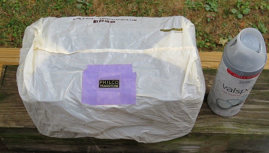

I did exactly that on my PT-2. Clean and polish first, apply decal, spray with clear coat. I used Valspar satin clear coat.
Thank you. That's the way I did it and it came out great. Didn't mask off, just covered the general area with a few light coats.
