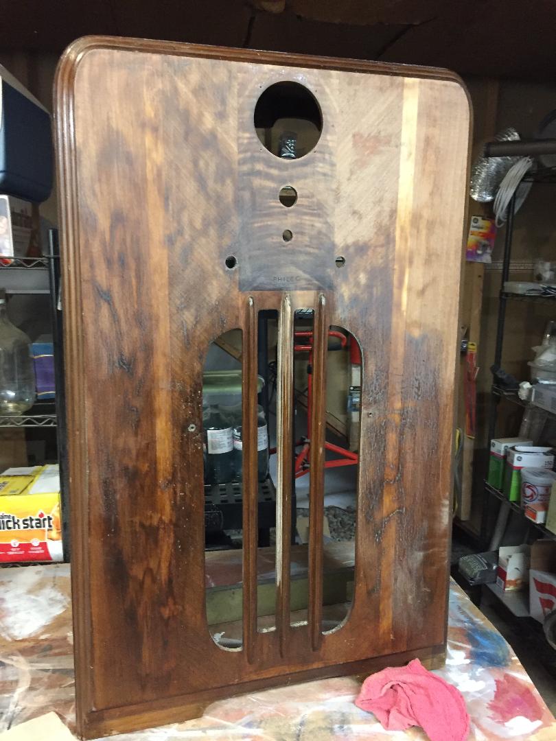

I have never restored an antique radio, but I am excited about my project. I found a 37-610J cabinet at a swap meet with a terrible finish on it. I have sanded the old finish off and I can tell it's been restored before.

1st thing.. No sanding off the finish.
Use lacquer thinner and #0000 steel wool and the finish will melt off.

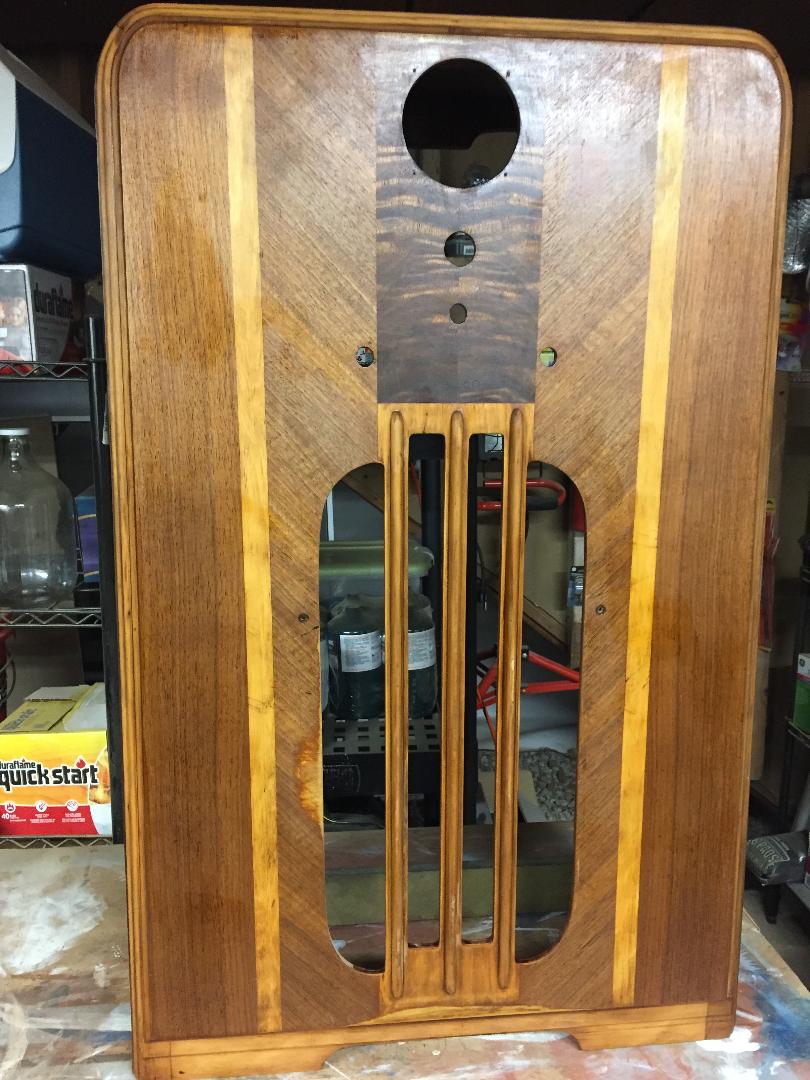

Here are three pics. The way I bought it for $5.00. I sanded and found several spots that a prior restoration had sanded through the veneer. I really don't mind. Not looking for a perfect restoration. I like it with all it's scars. I finished getting the old finish off and then the latest pic with one coat of amber shellac.

Very nice job! The cabinet is beautiful.

Looking good!
