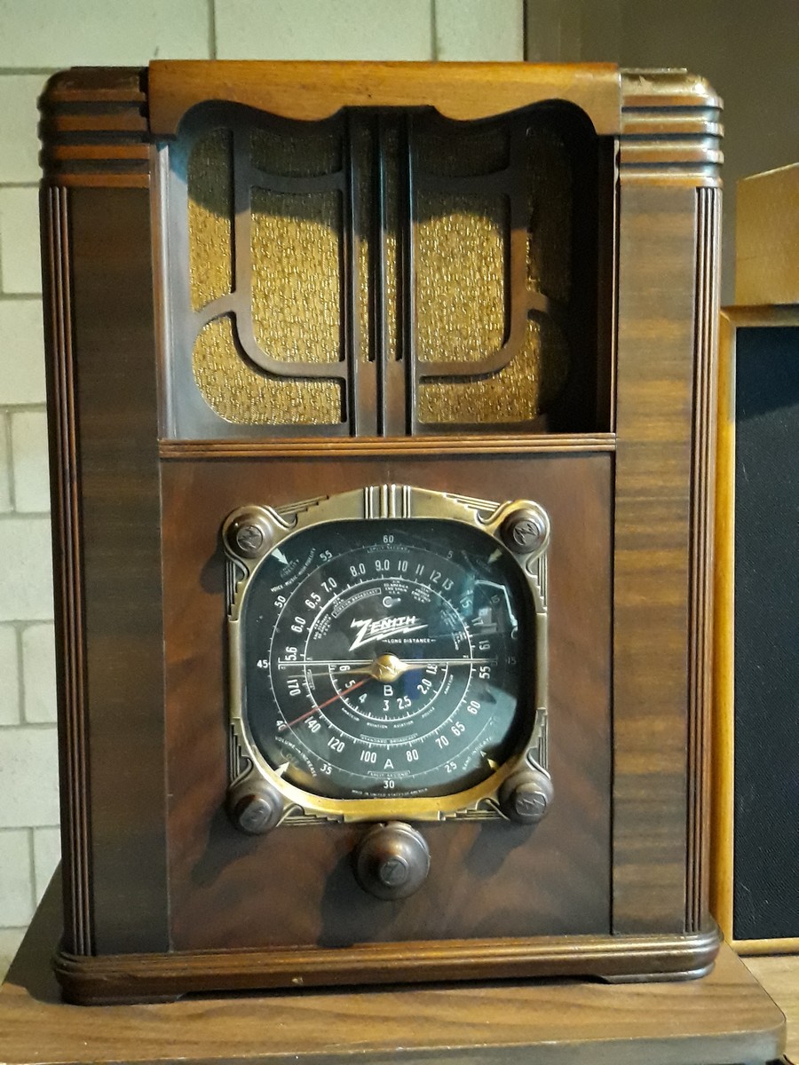

Last weekend I picked up this neat Zenith tombstone.
The cabinet is a 6-B-129. The chassis is AC powered and is either a 6-S-128 or 6-S-137. Zenith chassis 6-S-147, 6-S-152, and 6-S-157 are identical.
Only the 6-S-128 and 6-S-137 use 8 inch speakers, the others use 10 inch speakers.
The 6-S-128 and 6-S-137 were originally in (different) tombstone cabinets. The 6-S-147 is a chairside. And the 6-S-152 and 6-S-157 are consoles.
I am therefore going to call this chassis a 6-S-128 since its rubber-stamped model number is not visible.
So let's get going on its rebuild.

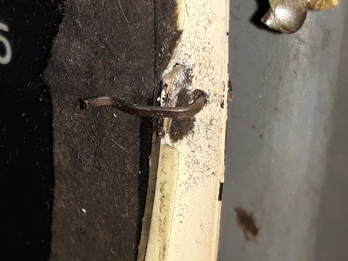

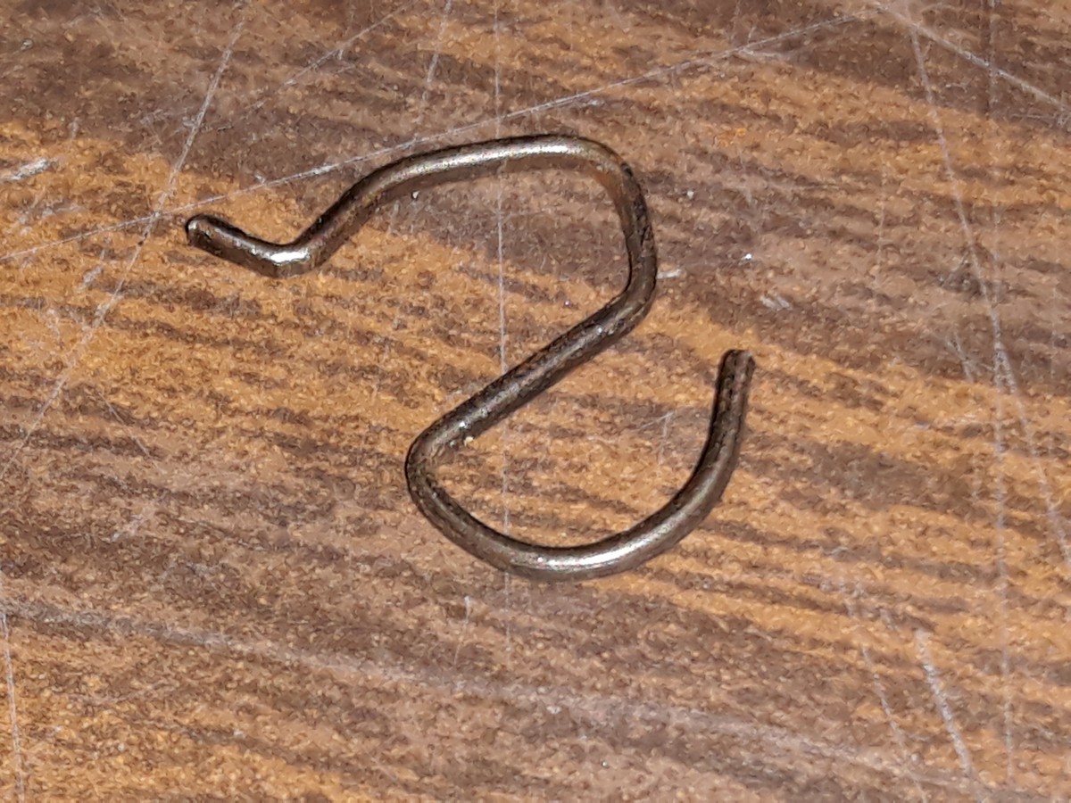

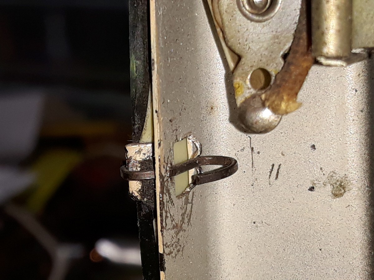

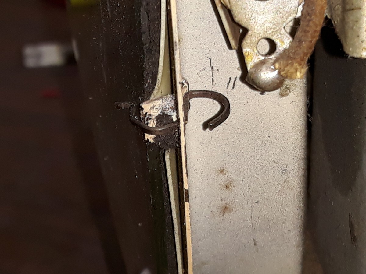

I took the following photos so I would remember how the clips attach which hold the dial glass in place.
Now a close-up of one of the clips:

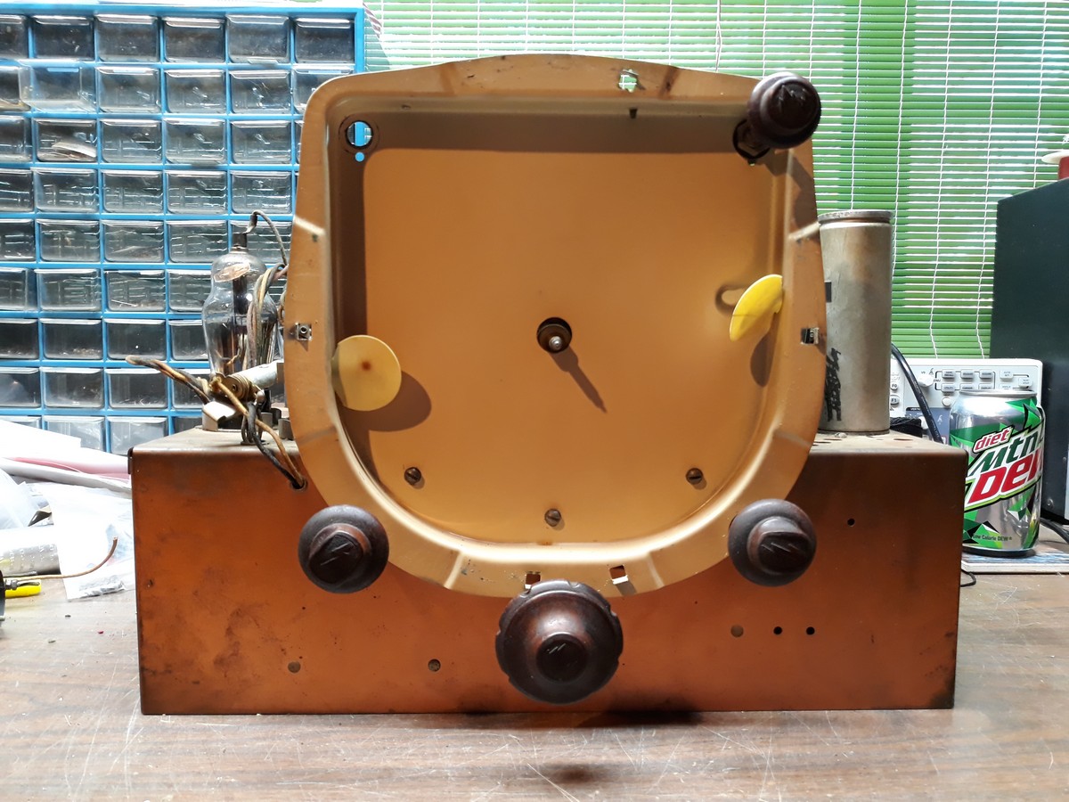

...and then realized I would need to turn the chassis upside down to work on it.

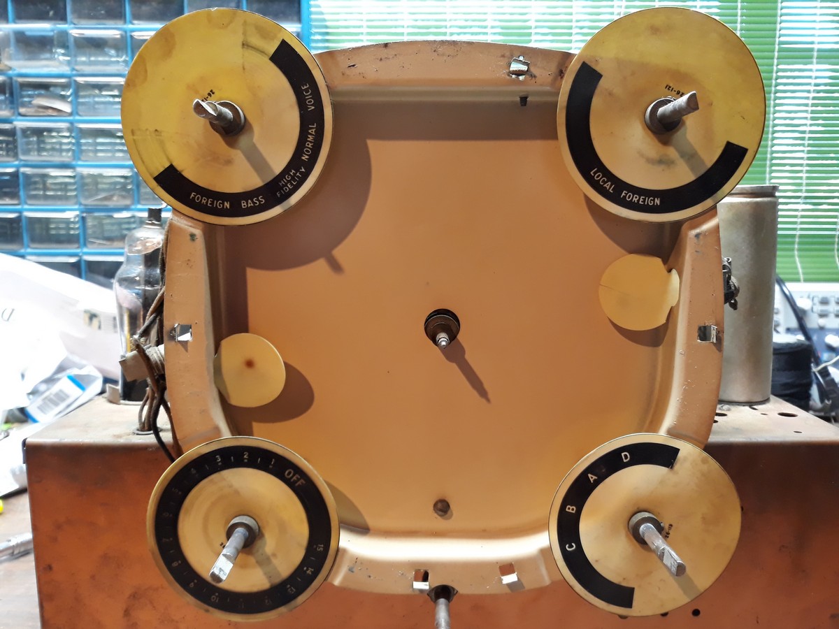

So the four indicators were removed and put in a safe place with the dial, dial glass, gasket, and the two small bags which hold the pointers and the dial glass clips.
I also removed the tone control from the dial assembly so it would not get broken.
The front then looked like this:

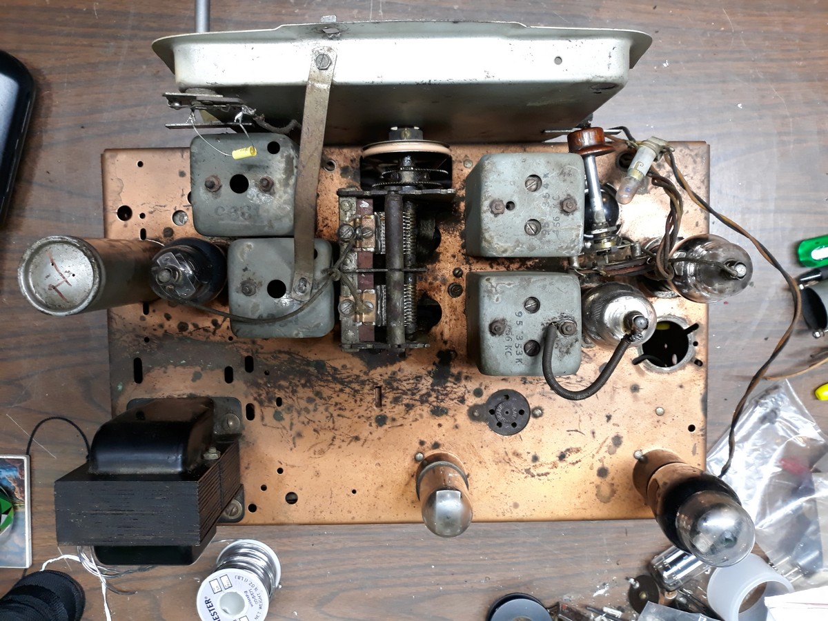

Let's take a look at this chassis.
Kind of grungy on top. Hopefully I can clean it up somewhat.

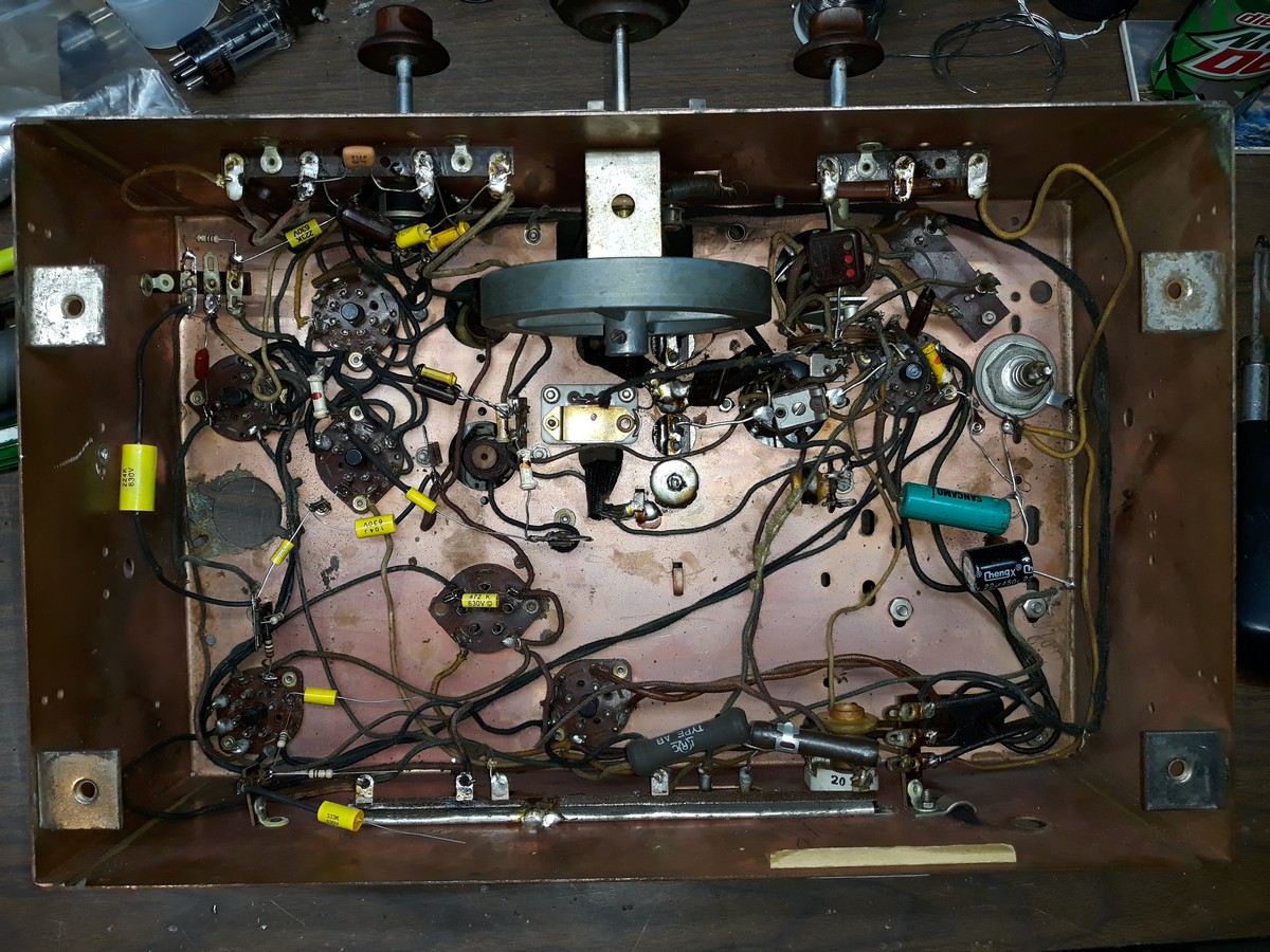

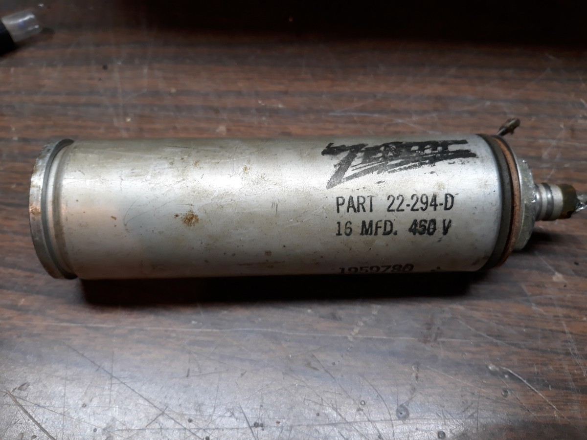

Underneath...it has been worked on before but the work was sloppy. When I took this picture I had already started working on it, replacing many of the components on the left side of the chassis and removing the replacement electrolytics which were dangling in the chassis on the left and right.
Fortunately, the original electrolytic cans were still on the chassis.

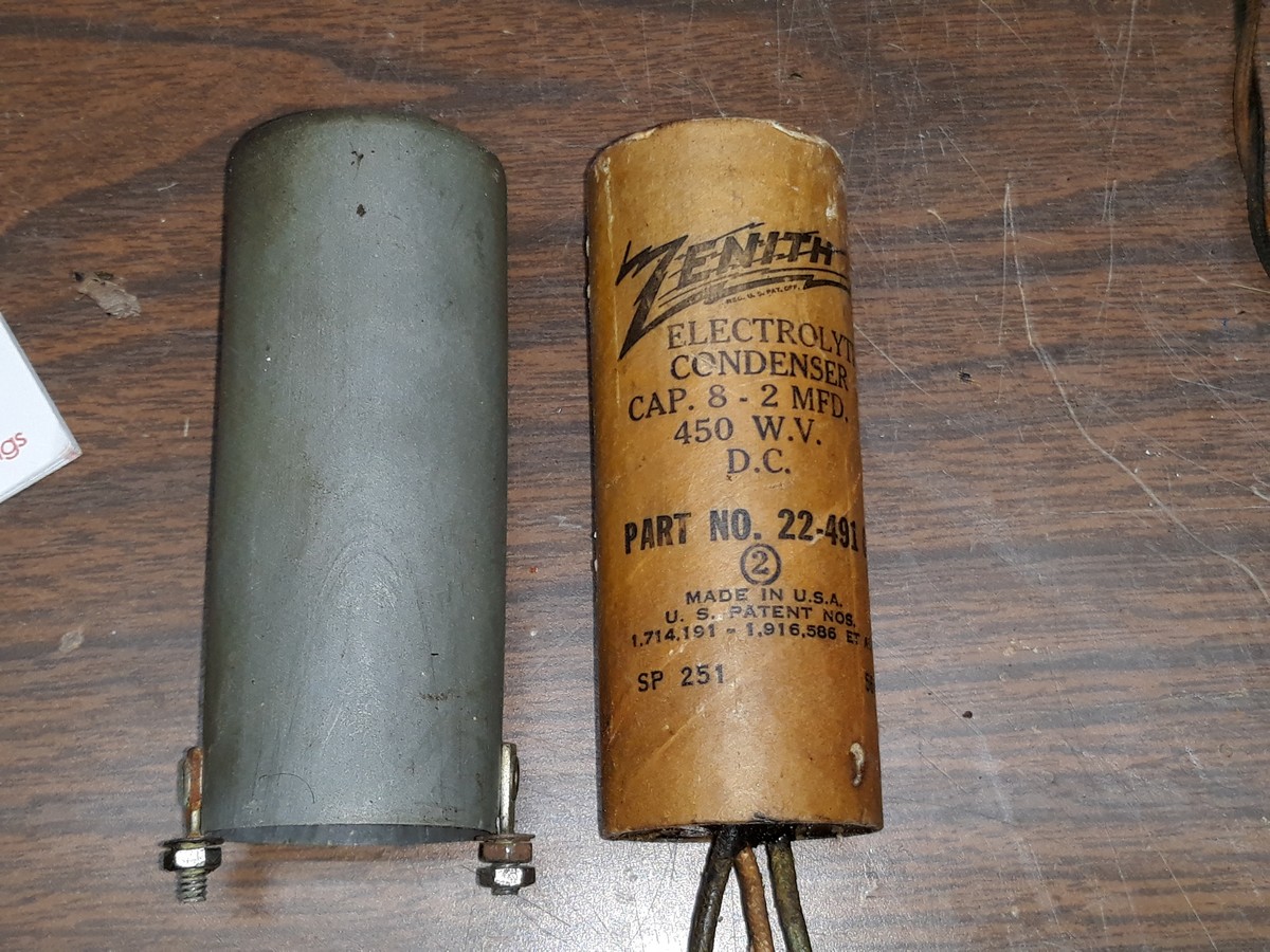

Here's one of them, which mounts to the chassis with two studs, nuts and lockwashers:
After removal of the can, with the nuts and lockwashers removed from the studs, the actual dual section electrolytic simply slid out of the can. Easy.
Here's the other electrolytic can, 16 uF. I really wish people wouldn't cut off the positive solder lug at the electrode - I like to reuse those lugs as it makes soldering wires to the positive end much easier.
I had a very difficult time getting its mounting nut loosened up to remove the can. Perseverance finally paid off, however.
I won't be polishing this can as I usually do, for to do so would make the Zenith logo disappear.
Both cans will be restuffed - the single section with two Solen 8 uF film caps to equal 16 uF; the other with new electrolytics.

Excellent work, Ron. Having just went through my 6S152 back in August, the "drill" looks very familiar. Regarding the chassis, originally they were copper flashed I think, and later on they were painted, so there's not much that can be done other than stripping it down and have it re-flashed, or mask it off and paint it. I opted for the latter on most of the Zenith's I've done. I've used both of these paints....some of the Zenith's had a more "hammered" appearance to the paint, while others were just plain copper. You can find this paint at Menards, Home Depot, even some auto parts store chains carry it.
Good idea taking photos of how those dial glass clips go in. They take some finagling to get out...even more so to get back in! Thankfully the following year they stopped using those easily lost clips.

Thanks. (Thank you too, PhilcoJohn.) As I recall the 1938 models have the "hammered" appearance. This chassis is simply copper plated steel (plated both sides). I have a 9-S-262 chassis I hope to get to eventually. That chassis has a lot of corrosion on one side and will need serious cleanup and then painting with the "hammered" copper paint.
Good idea on the paint...but it's too cold here to do any painting now.
