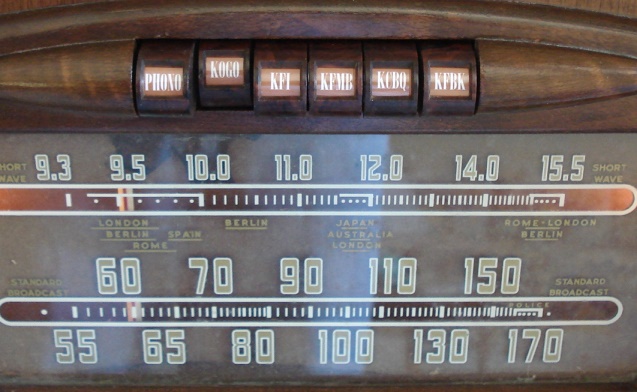

In 2018 I performed the electrical restoration of my 46-1209 set that had last worked in the 1980's. The cabinet was restored by a professional restorer following a flooding event in 2014. Now the set is working great. It does not have the turntable, however.

I made a set of station labels and clear covers for the pushbuttons.
