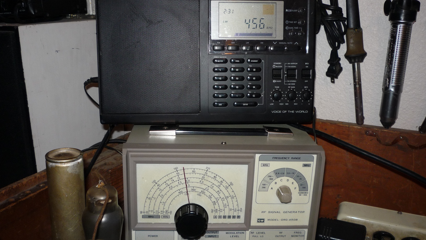

Heres my setup, i used the DX-390 to peak the generator to the exact frequency..
Seems like its in the ballpark, but the morse wont pick it up with the tuning gang fully meshed. I have to back the generator down to 390khz on the same scale before the Morse hears it..
Hooking the the 456kc signal to the ant is fine. Set the generator for 456kc and set the modulation on. Turn the attenuator to high and adjust the IF trimmers till you hear the signal from the generator. As the signal get louder adjust the attenuator down to a minimum.
If you can't get a peak at 456kc you may have a bad IF transformer.

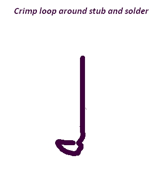

I've repaired tubes like yours before.  Solder a wire onto the stub, then use a solder sucker or wick to get the solder off the top of the tube cap to expose the hole.  Glue (super glue works well) the tube cap on with the wire sticking out of the hole.  When the glue is dry quickly fill the top of the tube cap with solder.  Be quick or you'll undo the wire that is soldered to the stub.  Try it, you've got nothing to loose and might get a good tube again.  Good luck....
