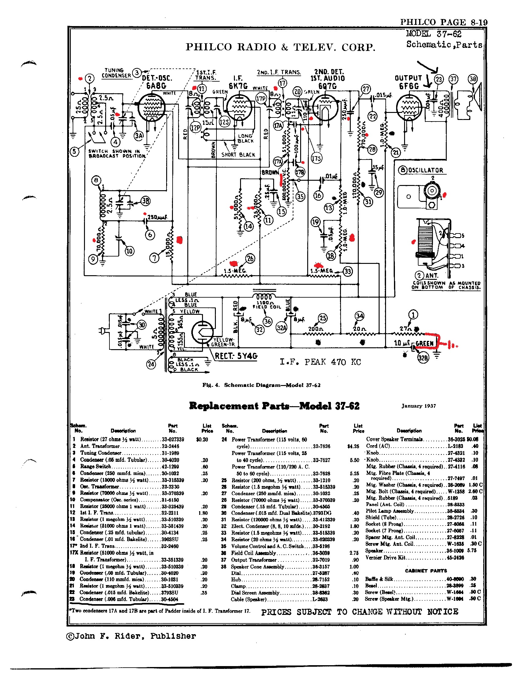

Been working on my ebay buy but one thing i noticed is there is little to no bass in the audio. I am wondering if i can change No# 23 .006 to a .01 would that improve the audio and give it more bass?
Ignore the red and black dots that is where i have been checking good and bad parts. The part i am referring to has a black arrow.

You can certainly change part #23 to a .01 condenser with no real ill effects. What it will do is cut down the higher frequency tones, cut the treble. It won't actually increase the bass. You can give it a try, and see how you like the sound. I would try the chassis on the case first, and see how that sounds. If you still want more bass sound relative to the treble, then change it, but realize you will lose some of the brightness of the highs.

If you have replaced the caps, recheck C16 and C22. Recently I was working on a radio, and the cap on the volume control wiper was bad. It was already replaced with a .02 yellow cap. New mass produced caps can be bad. I had the same issue you have, poor bass. Sometimes C27 the 250pf mica cap goes bad, but that would not likely cause low bass.
A quick swap of the 6Q7 and 6F6 tubes is not a bad idea if not already done.

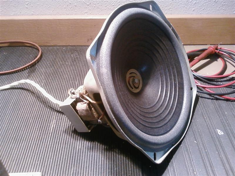

I did this a couple of times, before I found some good paper suspension cones which are much more authentic.
Just in case somebody doesn't know what I am talking about - the replacement cone above has a very compliant foam surround.
This makes for a very nice improvement over stock, especially in bass response.
I believe that if you are going to change something, this(!) would be the most effective. You don't need to change anything in the radio, not even the speaker, just the cone.
The only paper caps i have changed so far is no# 15,16 and i checked the replacements before install and they tested fine. My order should be in about dinner time so i will have to wait till tomorrow.
