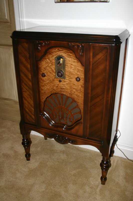

This cabinet?
1. Yes
2. I believe, mahogany, surrounded by bird's eye maple
3. Clean, but don't polish the brass.

Yes that is the cabinet. My hope is that mine will look as nice one day. Going to take my time, and try to do this right. Always wanted one of these, so It will be a labor of love. Thank you for your very helpful reply! ☺

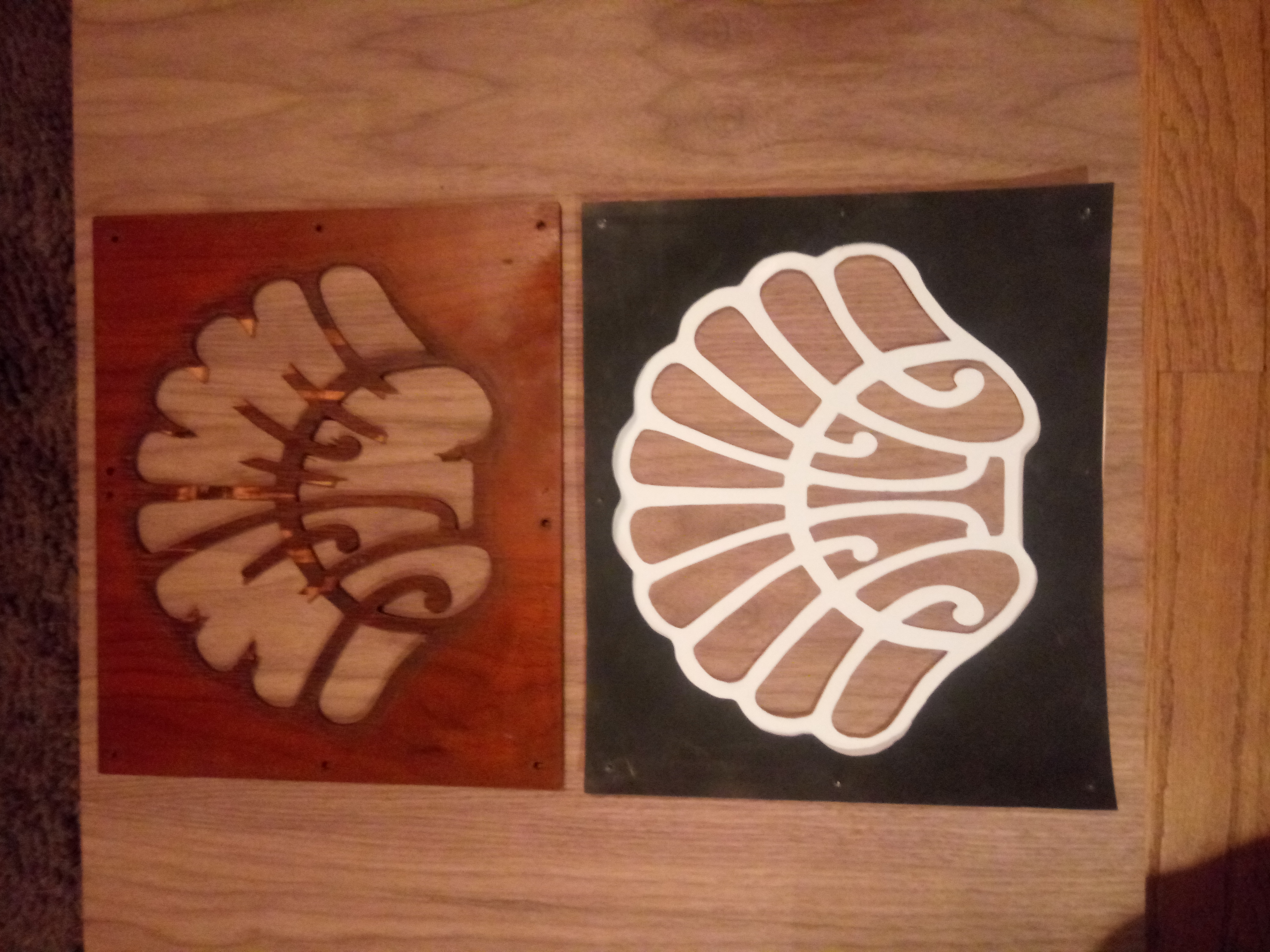

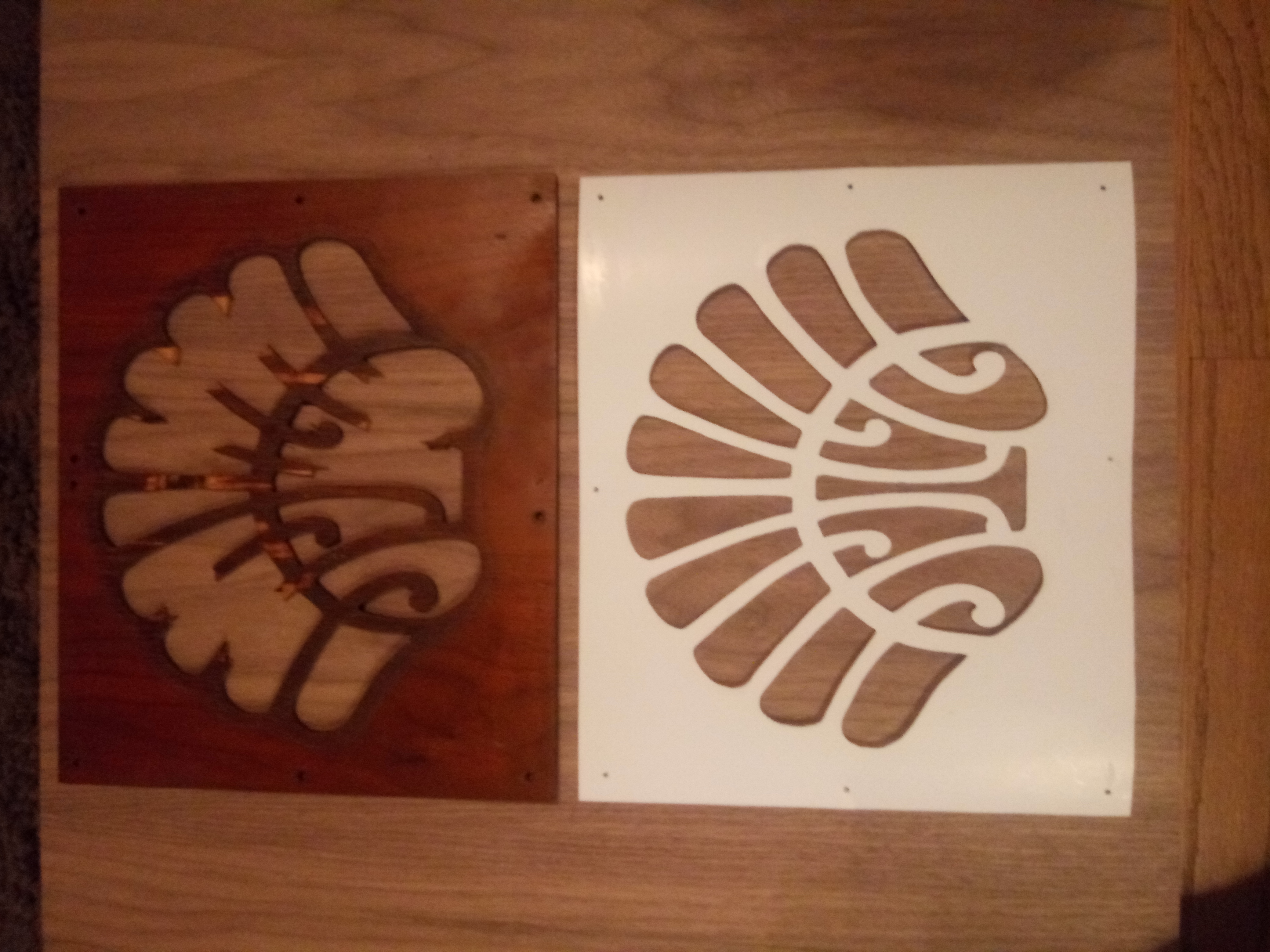

I'm currently working on replacing the broken "fretwork" speaker grille. There was enough left of the old grille to trace half of it onto poster board. I folded the pattern in half and cut it out with a razor. I dry fitted into the cabinet, and found the original grille was not symmetrical. The design really did not match the scalloped opening, and the reveal was off in spots.
I started over by making a pattern of the scalloped opening, and tracing the symmetrical pattern onto a new pattern, then made some adjustments to the reveal. I think I'm pretty close now, and ready to transfer onto my walnut plywood. Off to the scroll saw next. I think my radio may have been assembled on a monday. The bottom trim doesn't line up either. ?

Nice work, the folks at Shell World in Key Largo would be proud.
That looks good, and, probably makes this irrelevant at this time, but, some of those cabinets were sold without the scallop, jjust grill cloth.
That's right - later versions did not have the scallop cut-out insert. Only early versions of that cabinet had the scallop cut-out insert. Most likely, Philco bean counters decided it was an unnecessary expense, and the cut-out insert was dropped.
Thank you for your responses, compliments, and info! I was aware the later versions were made without the grille insert. I like the way it looks and I'm up for the challenge. Never tried using a scroll saw before, so we'll see how it goes.

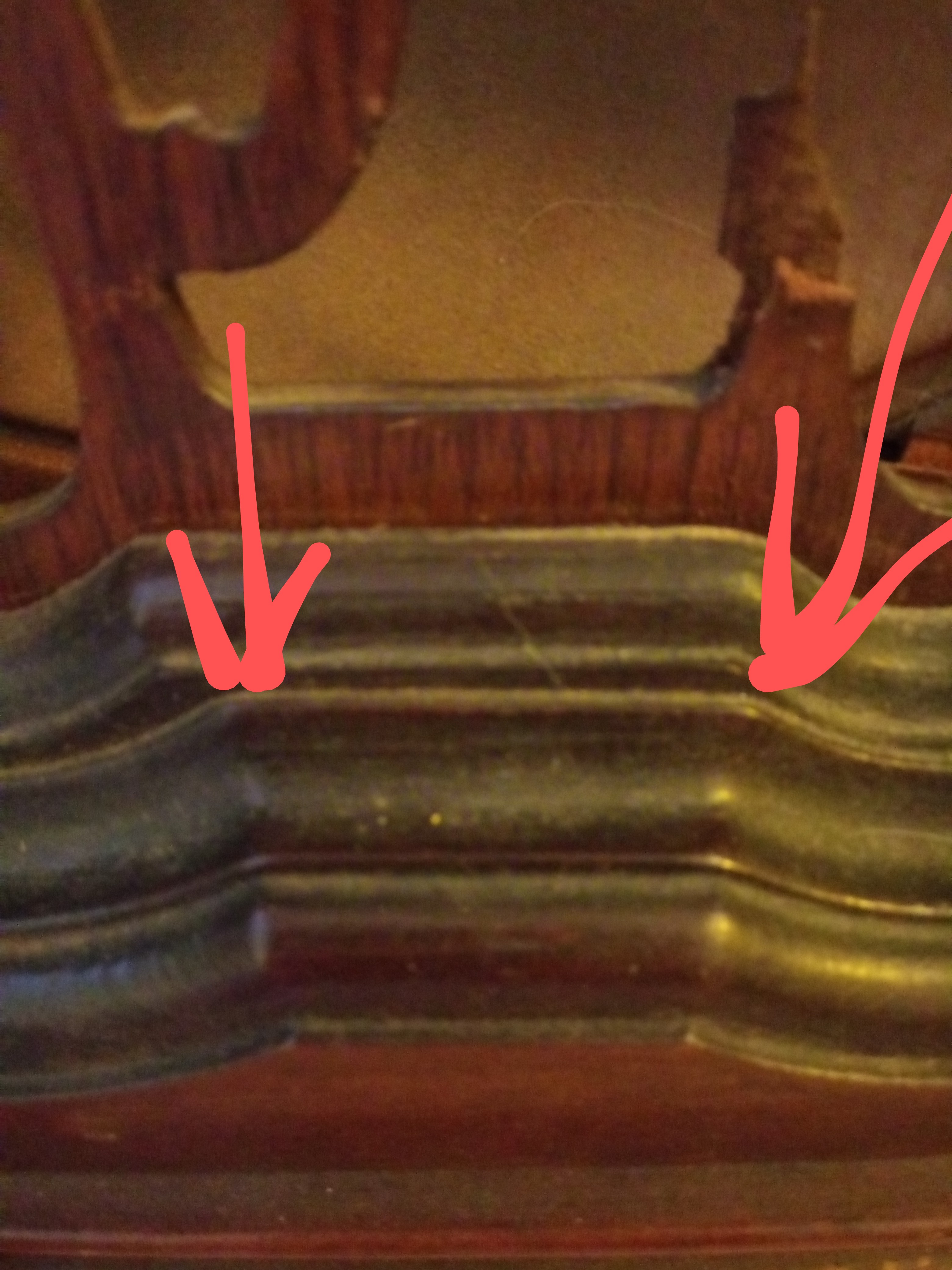

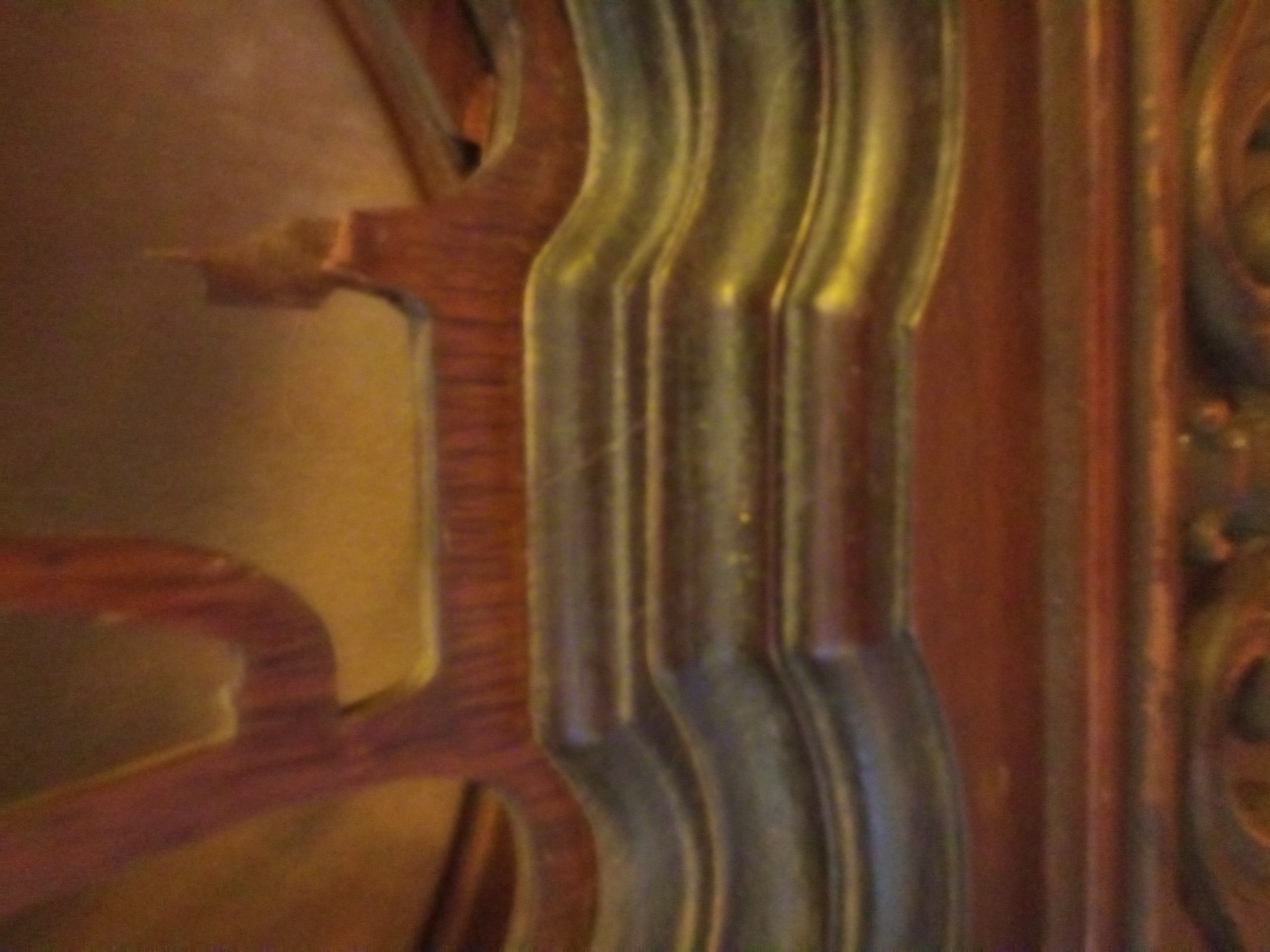

Anyone ever seen such a mis-aligned molding at the bottom of the speaker opening? It's actually the "bird's eye" center panel that was installed crooked.
I might be wrong but I don't think they built these things using micrometers...
My 87 is pretty good the front panel is slightly off center but you really have to stair at it to notice it.
Terry, lol.
Looks like they didn't use tape measures, or eyeballs the day mine was being built. My center panel is off by a good quarter of an inch at the bottom. The knob shafts are touching the holes in the panel as well
No big deal, was just curious if this was a common thing. I'm still ecstatic to finally have one of these, and I still think it is still a beautiful work of art!
Easy enough to fix (I think). Looks like the center panel is held in by screws. I'll just have to be very careful removing the glue blocks, and any laquer residue on the face where the pieces meet and might be stuck together. Thanks again!
