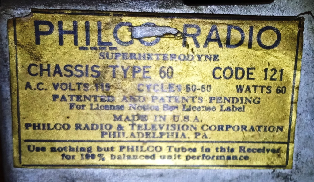

I recently had a Philco 60B given to me.  I'm pretty competent in modern electronics but I've never restored an antique radio before.  This one appears to be in pretty good shape - dusty, but not much rust or corrosion.  The antenna and oscillator coils have continuity (nice that the schematic gives actual DC resistance values for these!), as do the power transformer windings, so I figure I've got a good sporting chance.

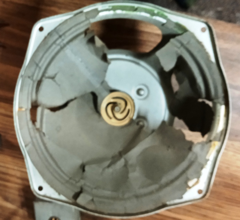

  My first problem, though, is that the speaker cone is trashed.  It looks like somebody stuck something thru the grill at some point and ripped out the cloth and speaker both.  The field coil, voice coil, and OPT appear to be OK.  Is there anybody who re-cones these speakers?  Alternatively, is there a source for replacement cones so that I can try to re-cone it myself?

  The Philco speaker has an unusual spider arrangement that I've never seen before.  Don't know if that'll be a problem or not, but I'll ask them.

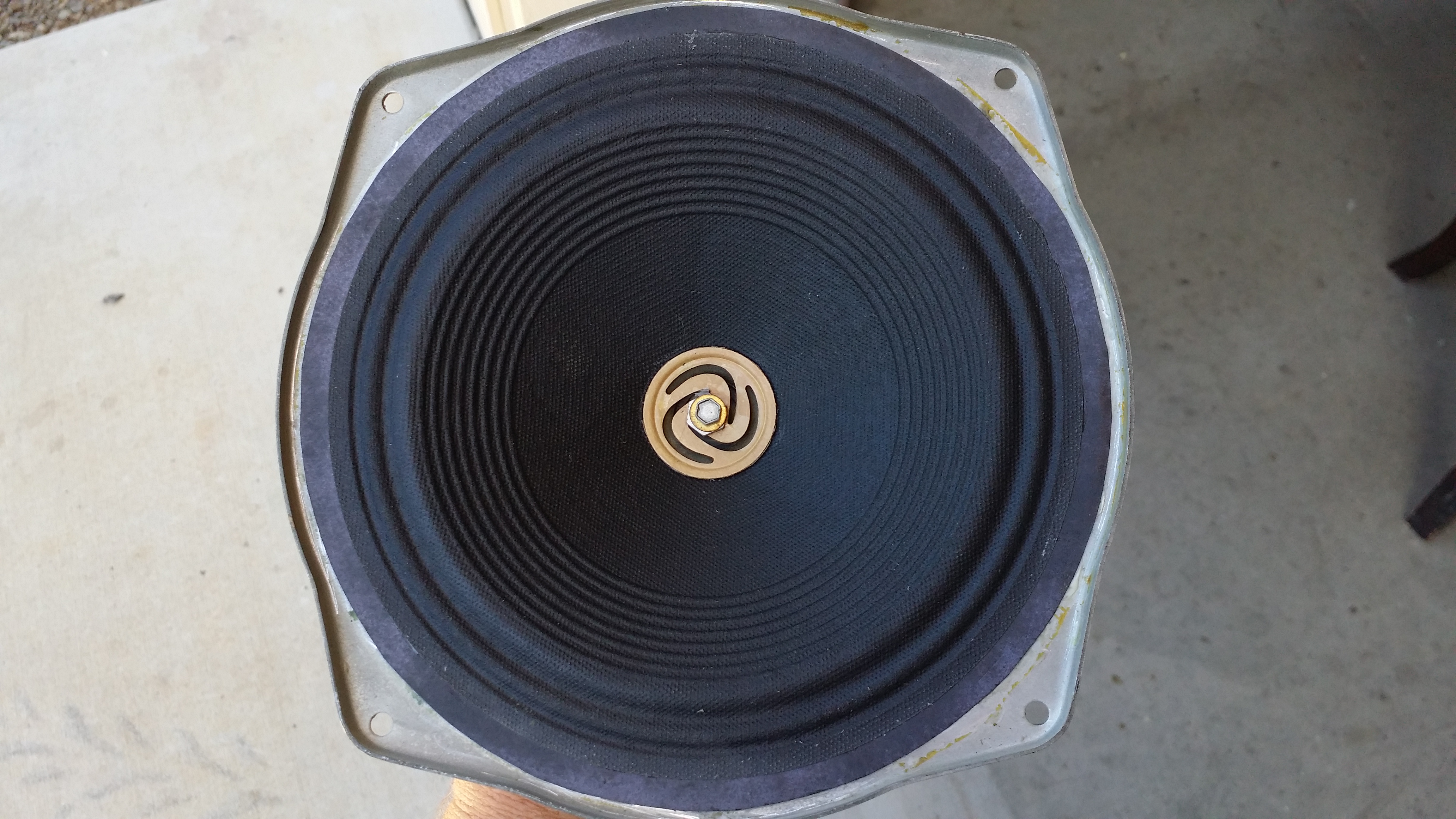

You can also replace the cone yourself.
Sellers on E-Pay, usually a couple of $.
Russ, you do nice work!
Yeah, that's beautiful!

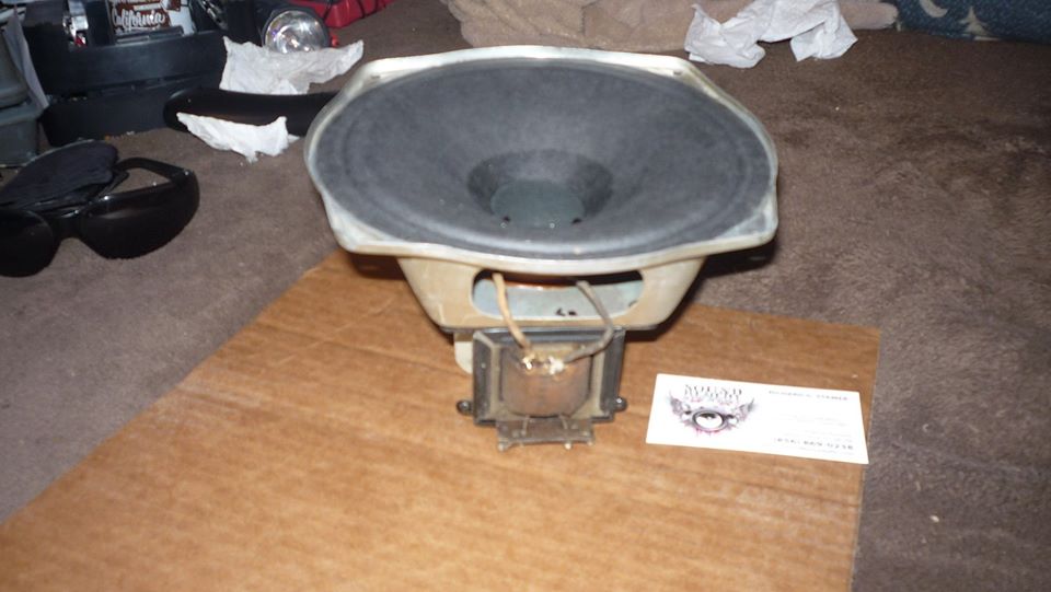

Sound remedy did several for me. The last ones were 16 cathedral and 38-690 tweeters, plus they patched the woofer for free when they realized they could not replace 14" cone.
They do not carry 14"-ers. They suggested putting a ring and thenfitting 12" cone but then agreed to patch the existing one and didn't charge me. Did a fne job at that.
