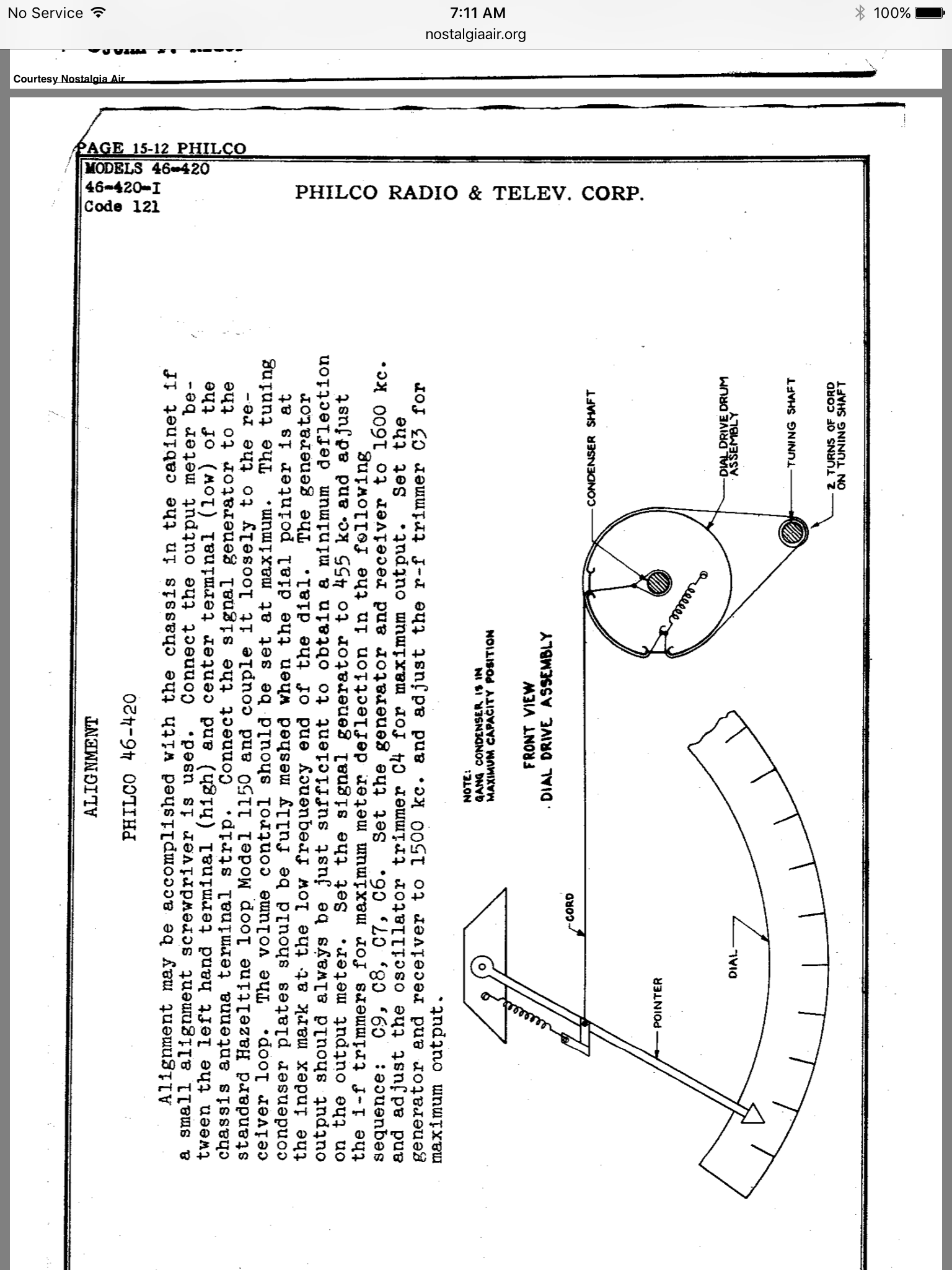

Last issue is the arm that moves the dial pointer is disconnected so the pointer doesn't move when tuning. Searching for documentation on how its connected.

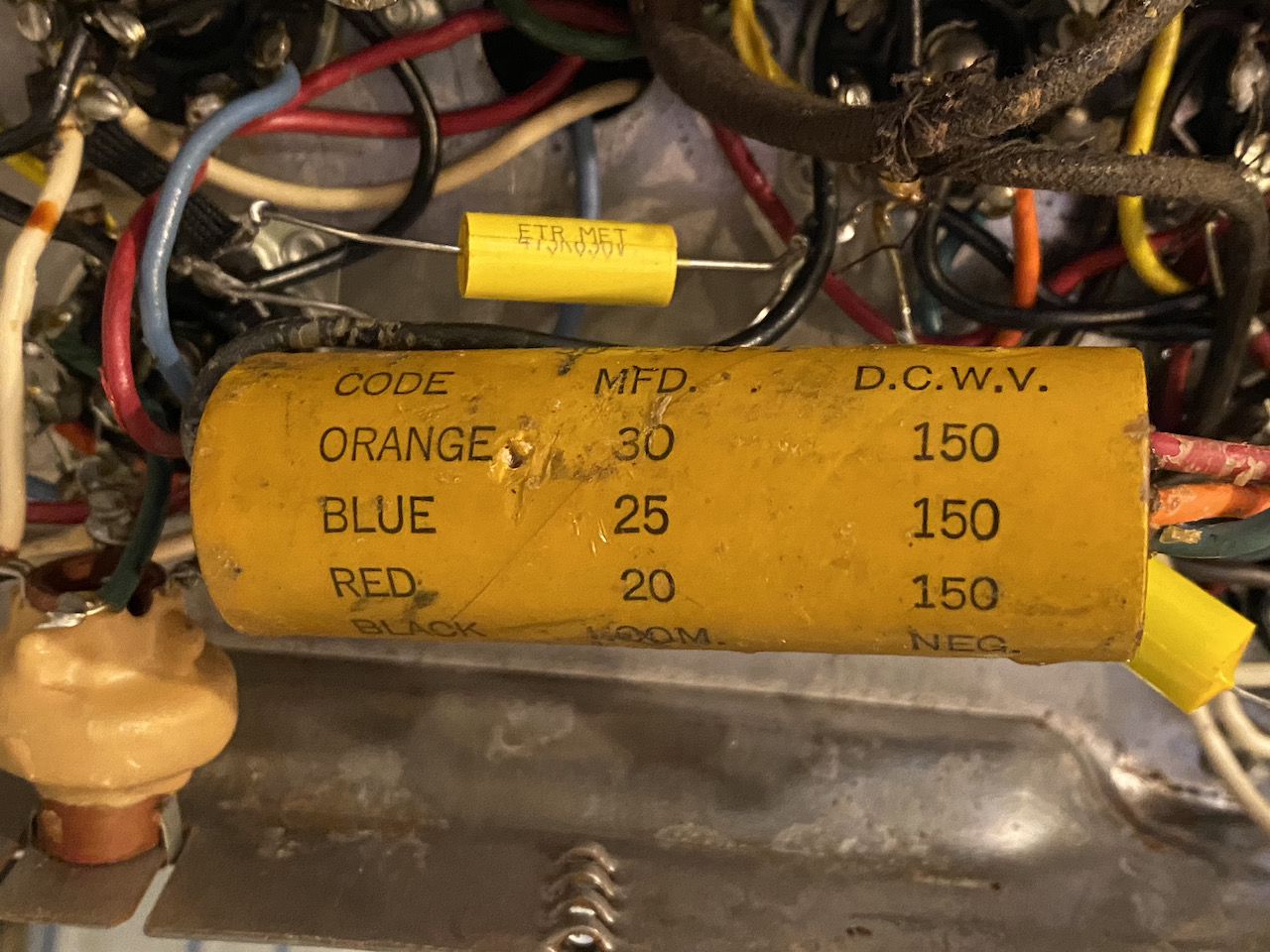

Hey Guys, so I am a real newbie here but just wanted to chime in, even though I just found out that after I finished my first recap yesterday - FAIL the radio doesnt work right.  the reception is garbled.  But I wanted to note for "morzh", the Code 121 has a pair of 20ufs and the code 125 has three (20-25-30u) e-caps. see pic.  I will post a separate thread to beg for help.
