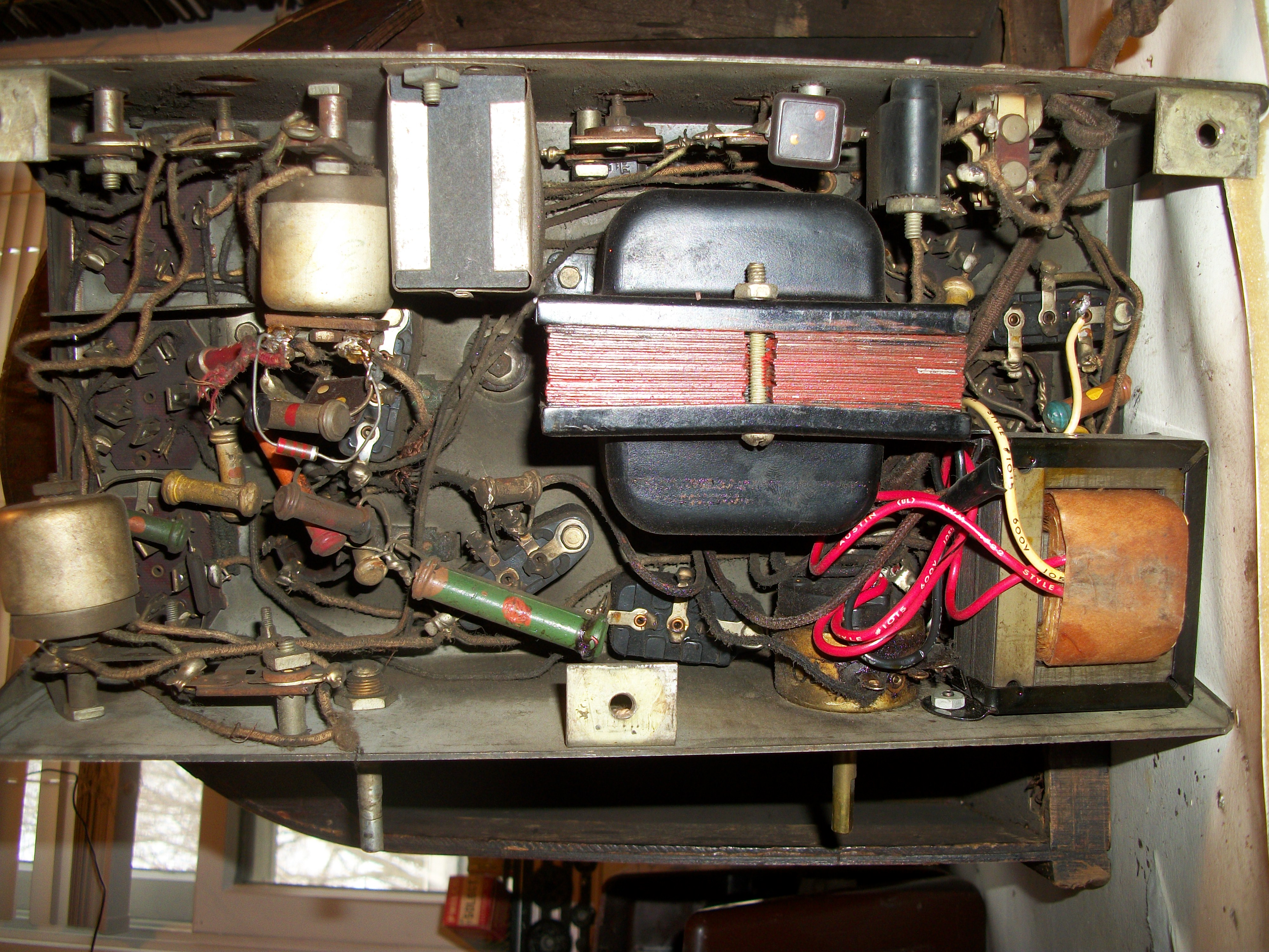

It came in today.

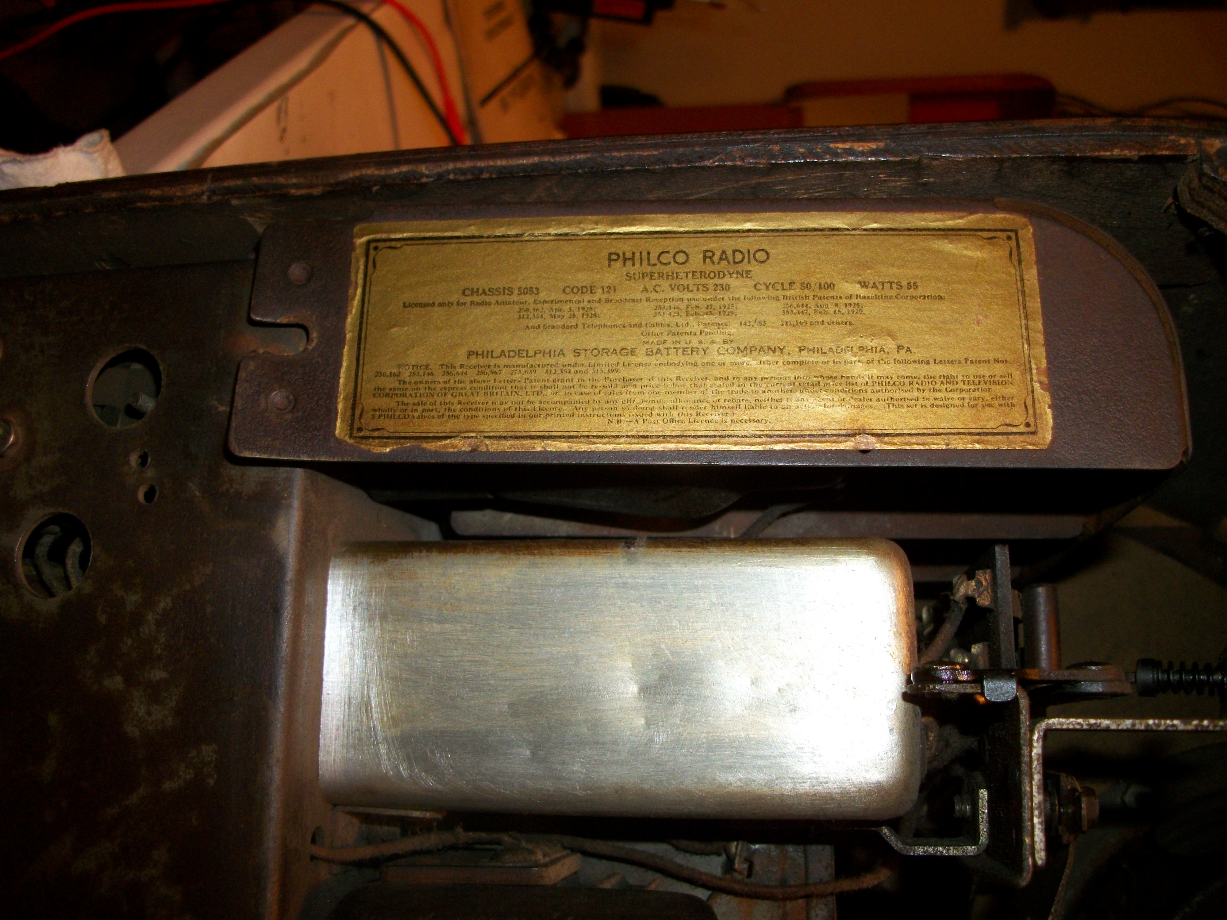

It was listed as a 52 and it looked like one

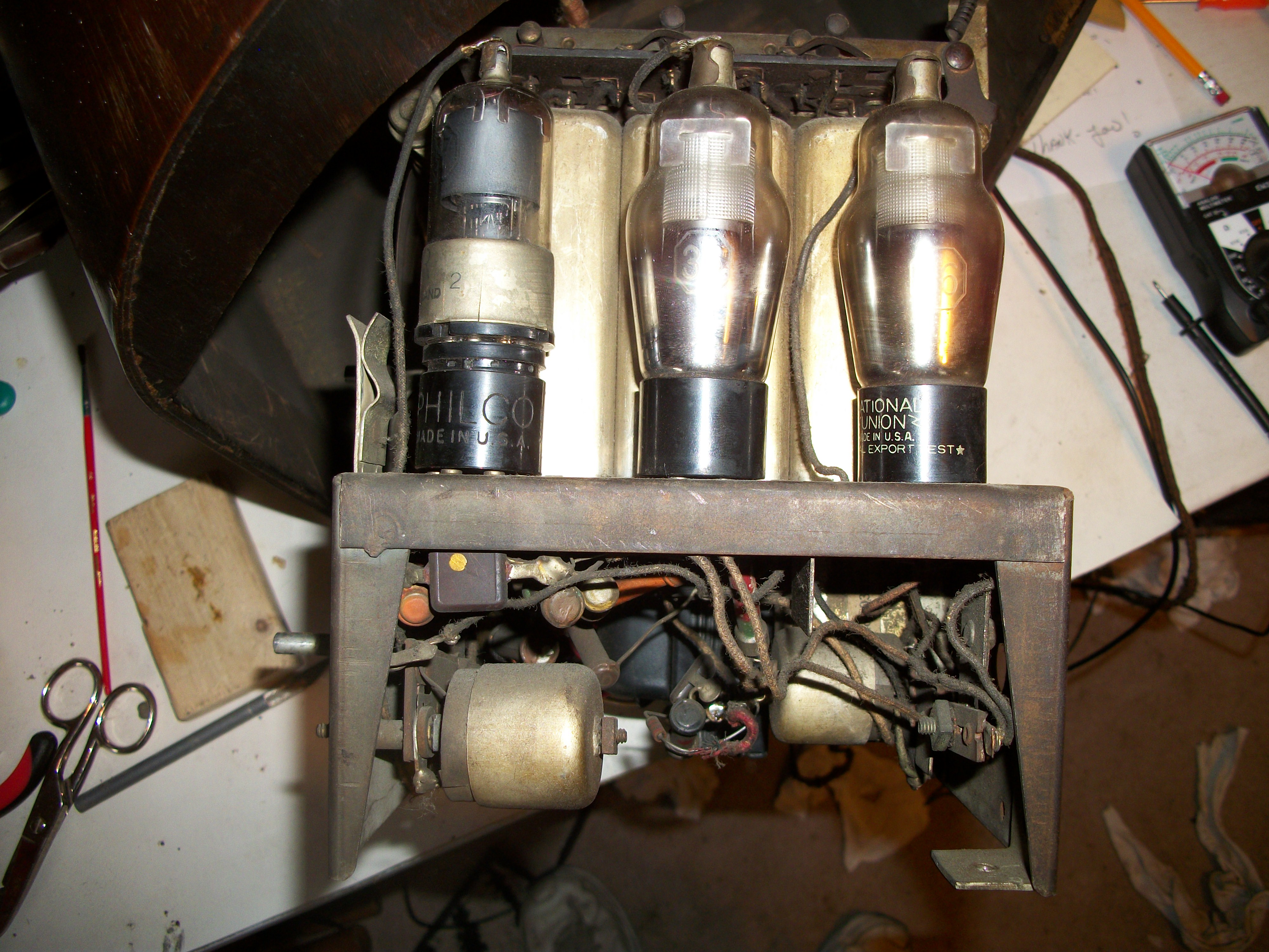

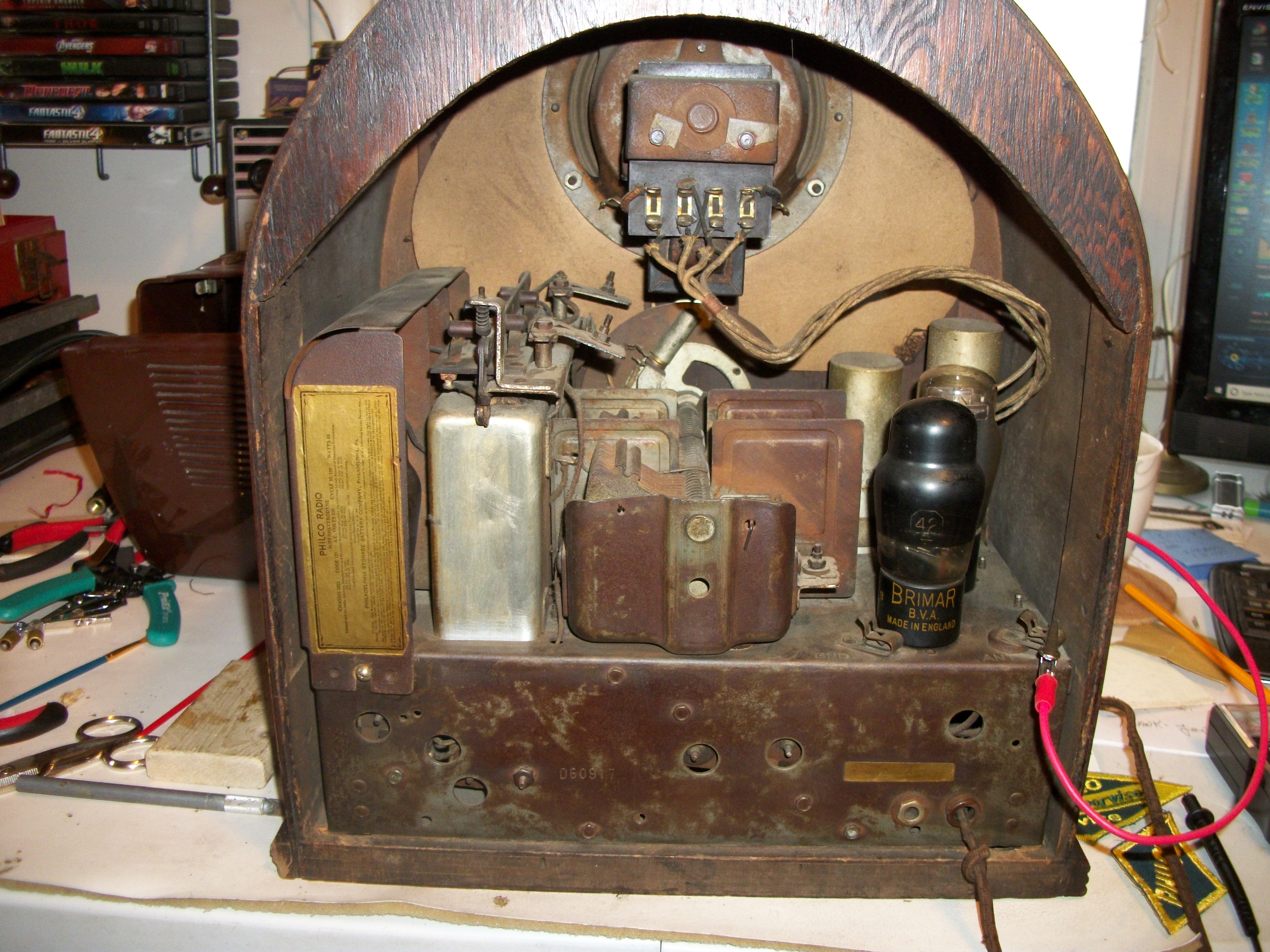

in the pic's. But when I open it up to check tubes
and thinks before powering it up I started to wonder.
What do you think. is it the right chassis? Just looking for
some good info this is the oldest radio I have gotten.
I will let you know it is working great.

VERY interesting, and puzzling. The label is obviously correct. It must be a model 56, although I cannot find this model in the gallery, nor find its schematic on Nostalgia Air, nor does a Duck-Duck-Go search produce any real information about this model. I defer to our Phorum experts. Perhaps they can shed light on this question. I'm intrigued. I have a feeling this must be a fairly rare model. I'm going to keep an eye on this thread.
Model 56 was made for export to the UK. There is no USA documentation since it was not intended to be sold in the USA.

The authors image of the tube lineup gives a clue, not tubes, but Valves.
Certainly looks like it has been serviced in recent times, the transformer with "pvc" lead-wires. Possibly a conversion from 220 ac to 120 ac?

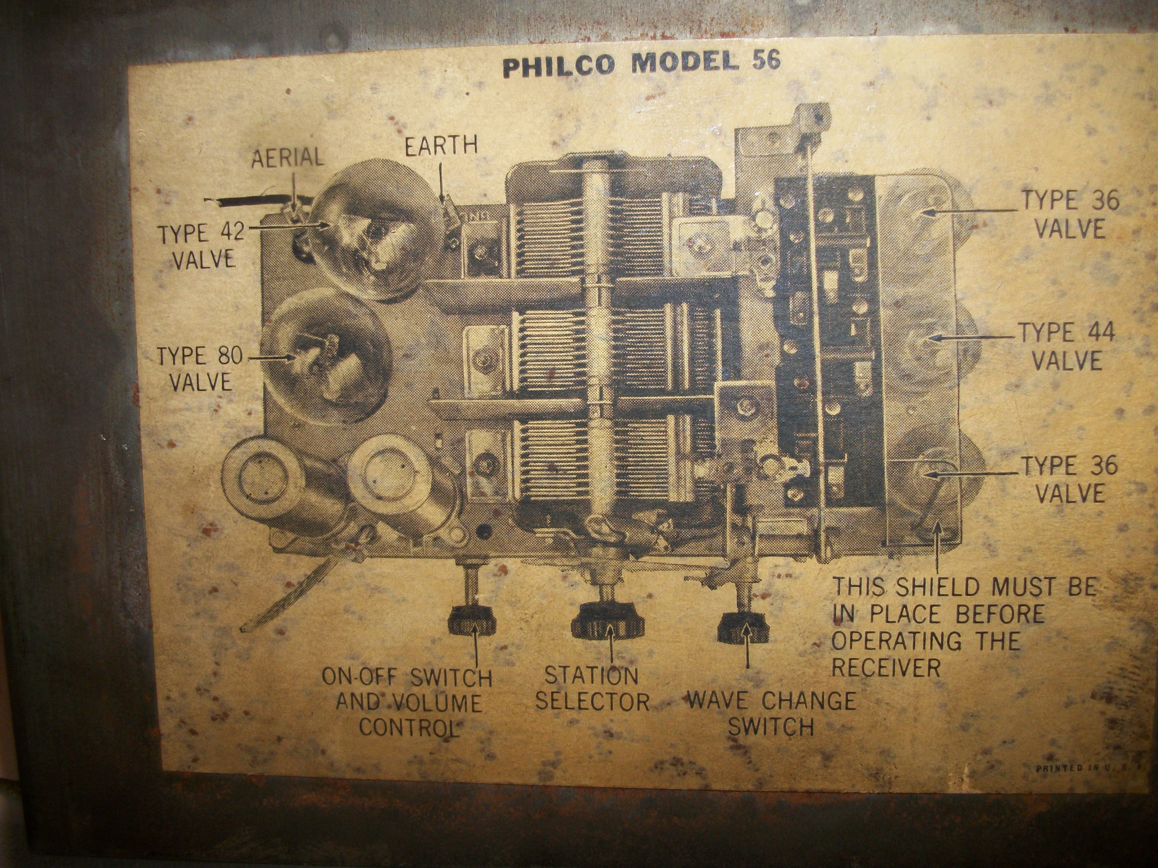

This is on the side of the tube sheild

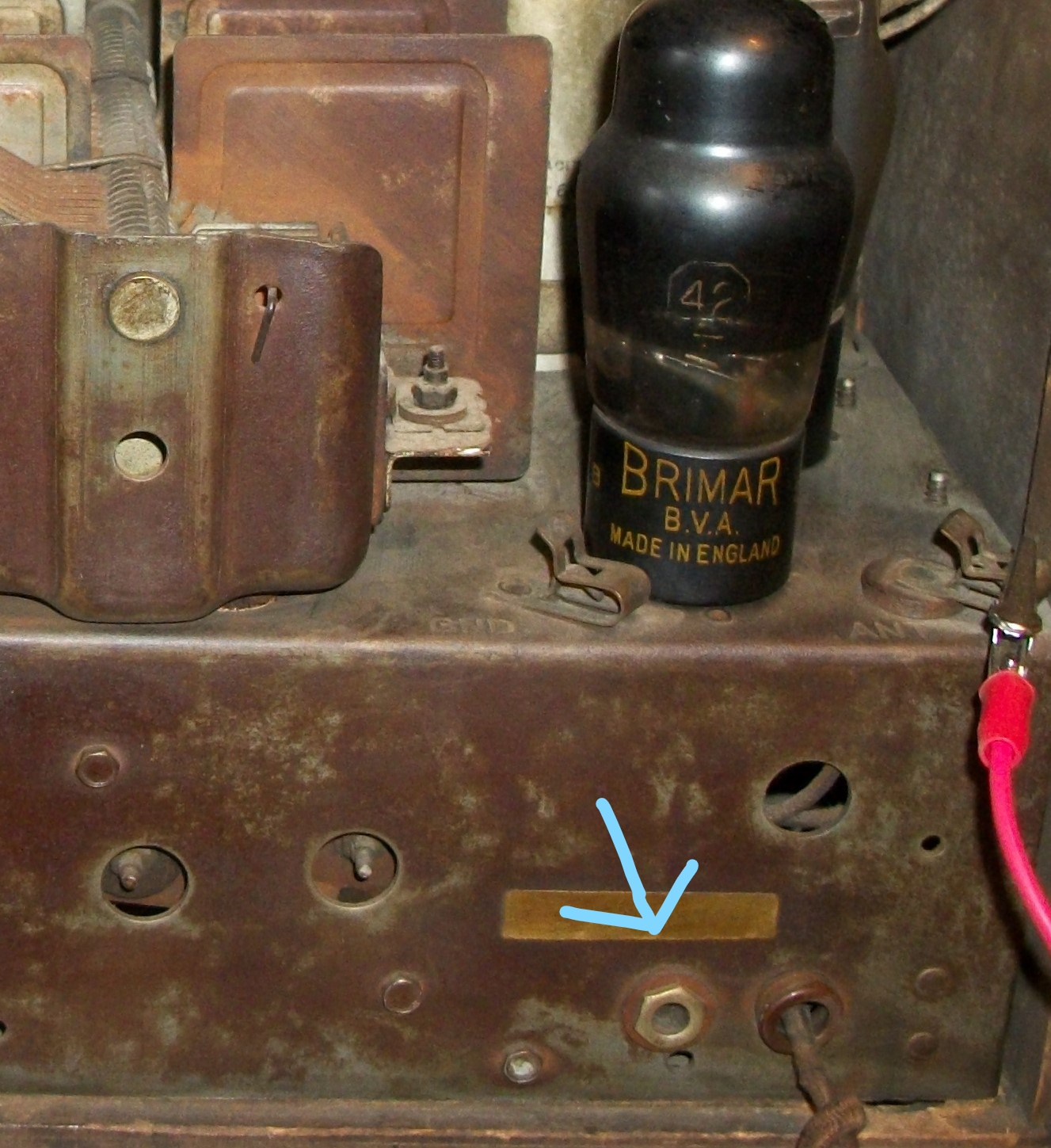

Second clue is the 42 "valve" in the picture. In small print "made in England." Take care, Gary

and the tubes behind the shield have been changed

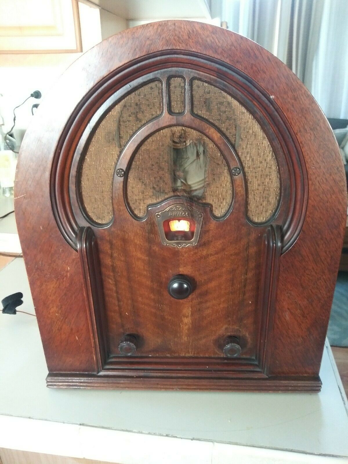

It came from California and said it wasn't working.
But it s working now, after adjusting and lubing the band switch.
