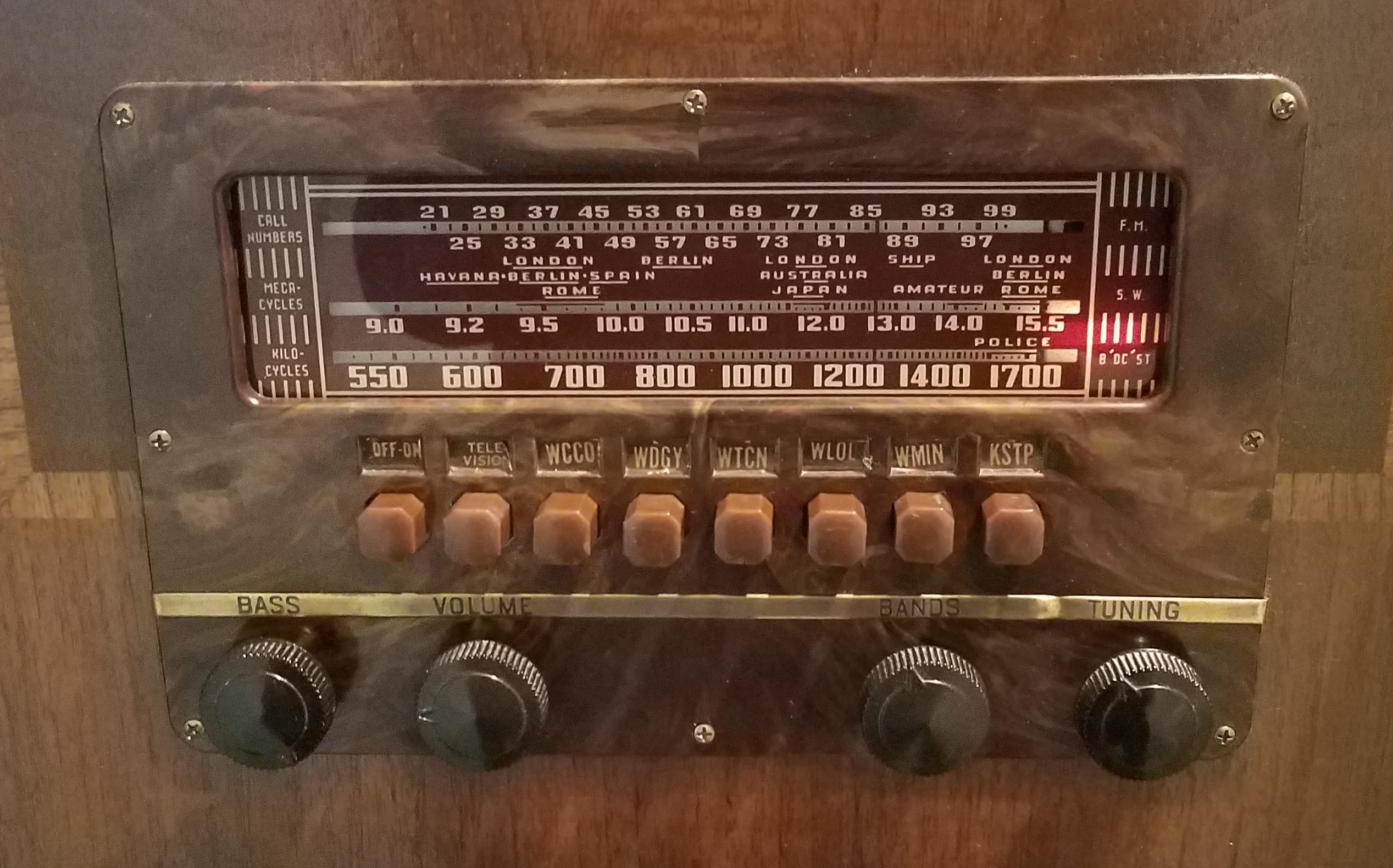

My dial face must have been replaced with a non-original at some point.  Attached is a pic of mine.
Yeah that plate doesnt look like mine.
