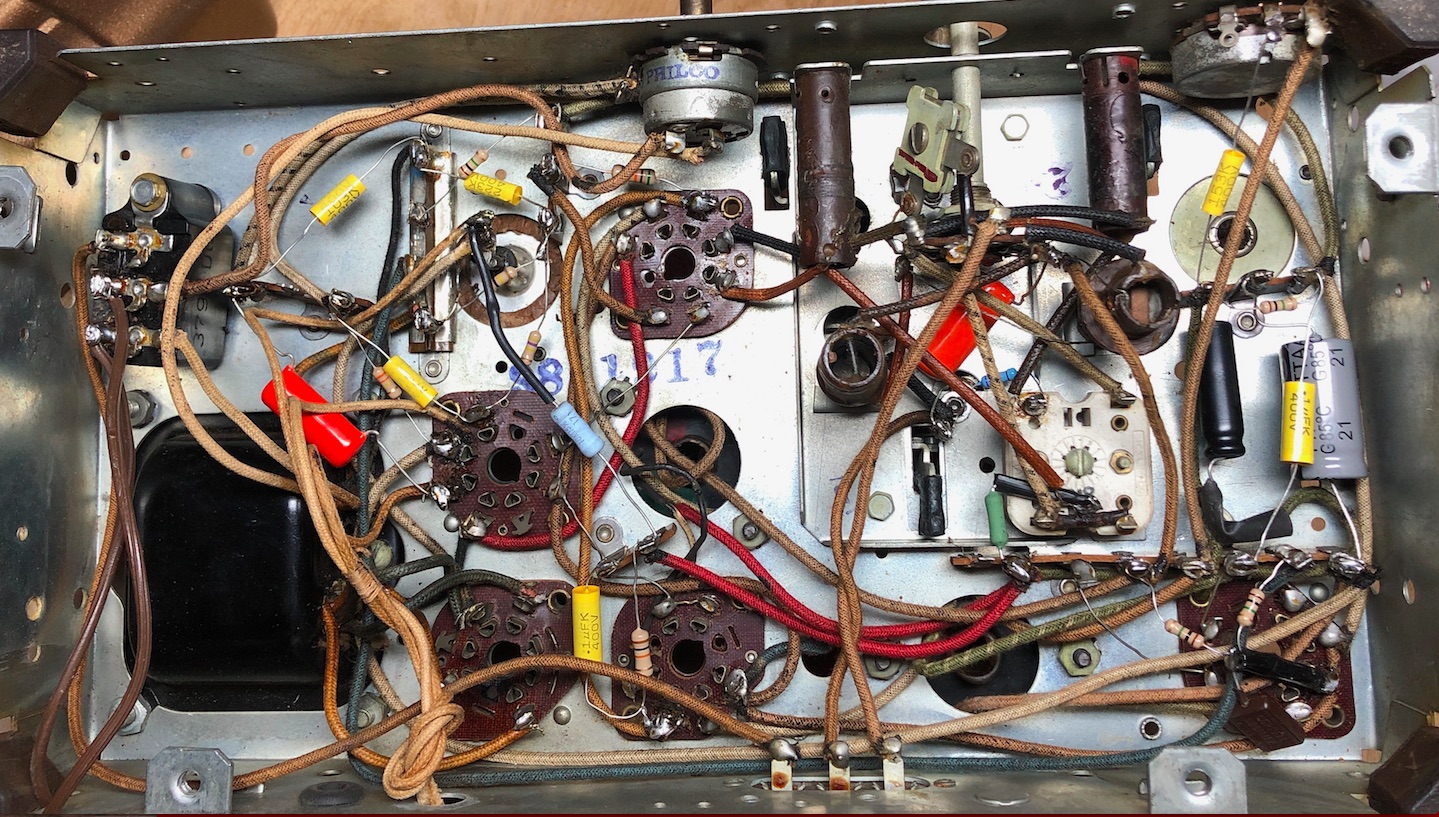

Hi all,
I've completed my first overhaul, replaced all capacitors including cans and bakelite block, (except mica), all resistors, new rectifier socket and tube. (this pic taken before I replaced the socket)
The good news is that it did not explode or burn out after powering up. All tubes lit, but I do not have a way to check if they are all good. Bad news is that I get no reception on AM or shortwave. I get a little air through speaker, nothing much else. 10' of 22G wire attached to red antenna terminal. Nothing attached to black.
What are the next steps to sorting this out? Thanks for any help you can lend this beginner.

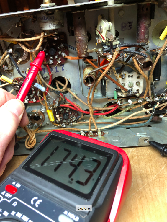

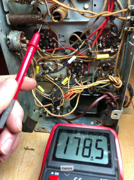

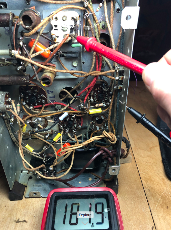

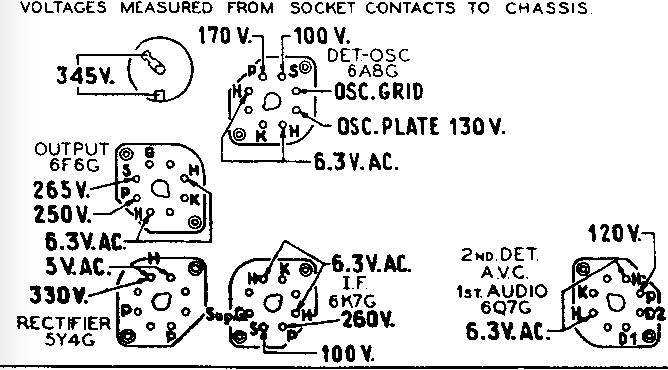

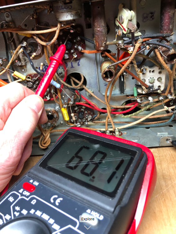

tube 6A8: pin3: 179v pin 4: 68v
tube 6K7: pin 3: 272v pin 4: 67v
tube 6Q7: pin 3: 232v (this one is double what the schematic lists)
tube 6F6: pin 3: 283v pin 4: 266v
tube 6A8: pin 3: 173v pin 4: 67v

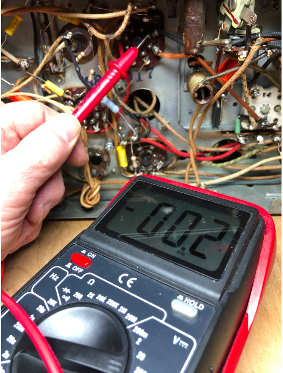

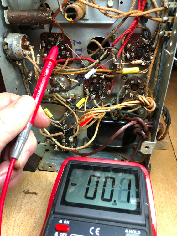

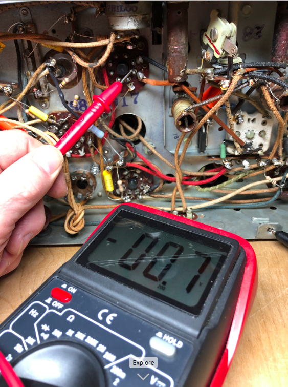

Pin 6 of the 6A8?
Also have a look@ pin 5 should see a little bit of - voltage there with a modern meter.
And are #19 and 26 within tolerance?

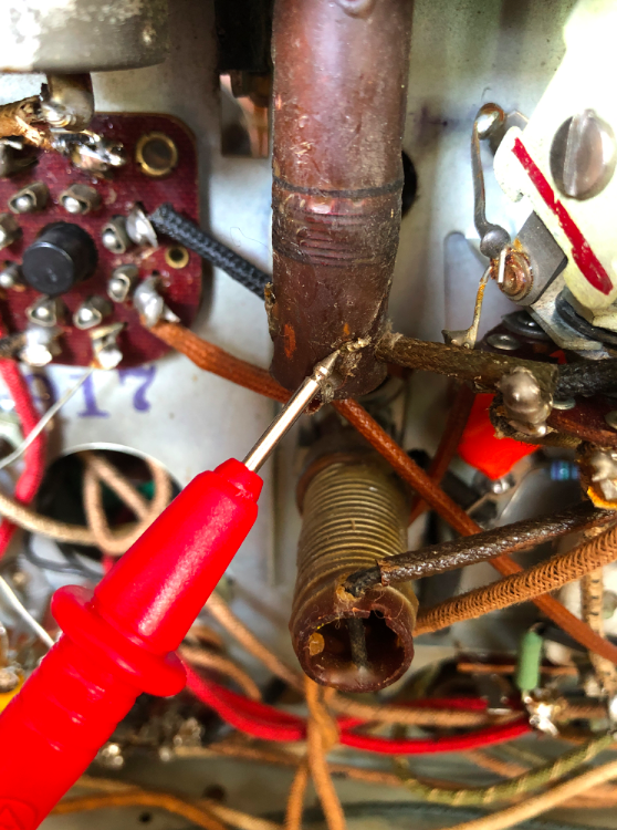

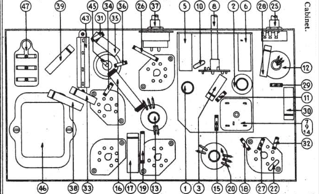

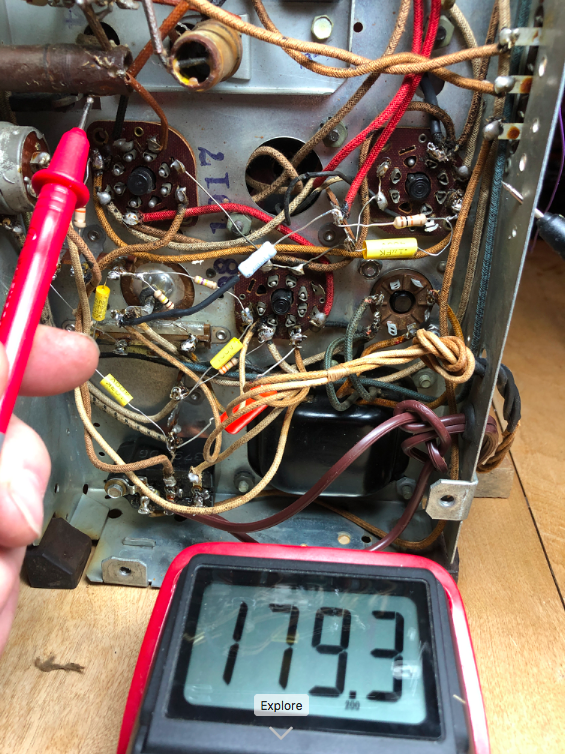

Tada! we got it. It seems that either #15 is open or #5 between pins 4 and 3 are open. Which ever you need the 130v or so on the plate pin of the oscillator section of the pentagrid mixer and it's getting lost down by #15.
With the set off measure the resistance across pins 3 and 4 of #5 (oscillator coil). Should see a low resistance like an ohm or so. If not remove the coil and give it a close inspection for rot (green spots) or a break in the wire.
(This post was last modified: 02-22-2020, 10:53 PM by Radioroslyn.)

Thanks, Terry. Are you referring to #15 resistor and #5 Osc. Transformer? What am I looking for... bad connections to/from either? bad component? Not sure how to rectify this.
Posts: 7,323
Threads: 270
City: Roslyn Pa
Correct!
You can follow the hv from the bottom end of #15 (5000 ohm resistor) to the top end of 15 then to terminal 4 of the oscillator coil then to terminal 3 of the oscillator coil/pin 6 of the 6A8.

It would seem that your wire is open from the coil to the tube socket or a bad solder joint where the wire is solder @ the socket. If that is ok pull the 6A8 out and measure pin 6's resistance to the chassis w/the set off. Should see a high resistance like 20 or 30K this eliminates a shorted socket. Measure the voltage @ pin6 w/o the tube in place maybe your tube is shorted.

Got it! Seems Bad connections at these pins are the culprit. I was able to get 160v to the tube when I moved these a bit, making a connection. Can these be secured/soldered?

Not sure which connections we are talking about but the coil you can gently scrape the wires at the solder connection and re solder. If it's the tube socket you can use a pair of needle nose pliers and gently pinch the connector on the socket w/o the tube in place. Be careful the metal can be weak and fold easily then your looking at a new socket.
