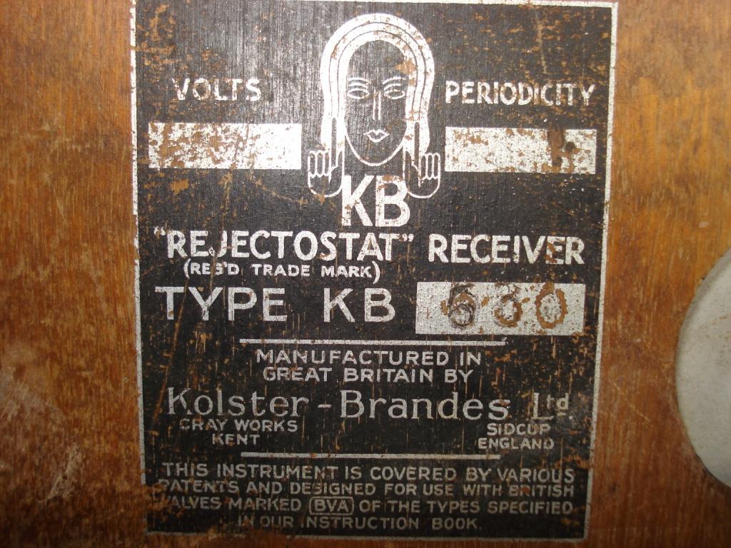

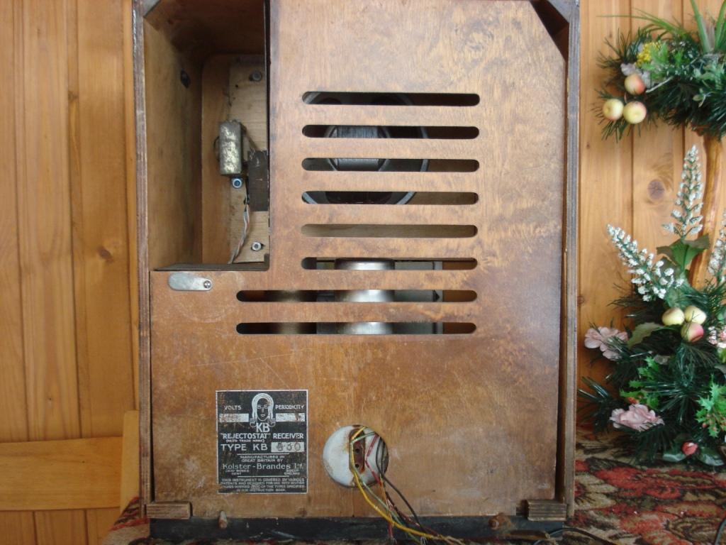

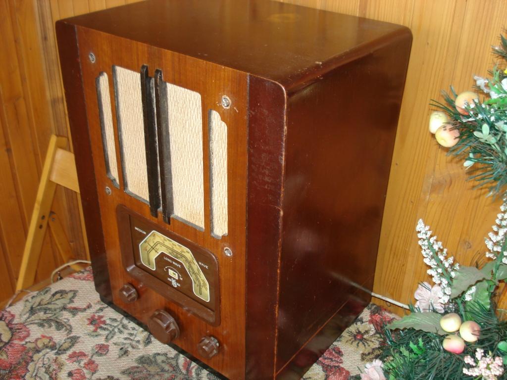

I have a Kolster Brandes KB530 and its case also has a similar inscription.  This is a battery regenerator
