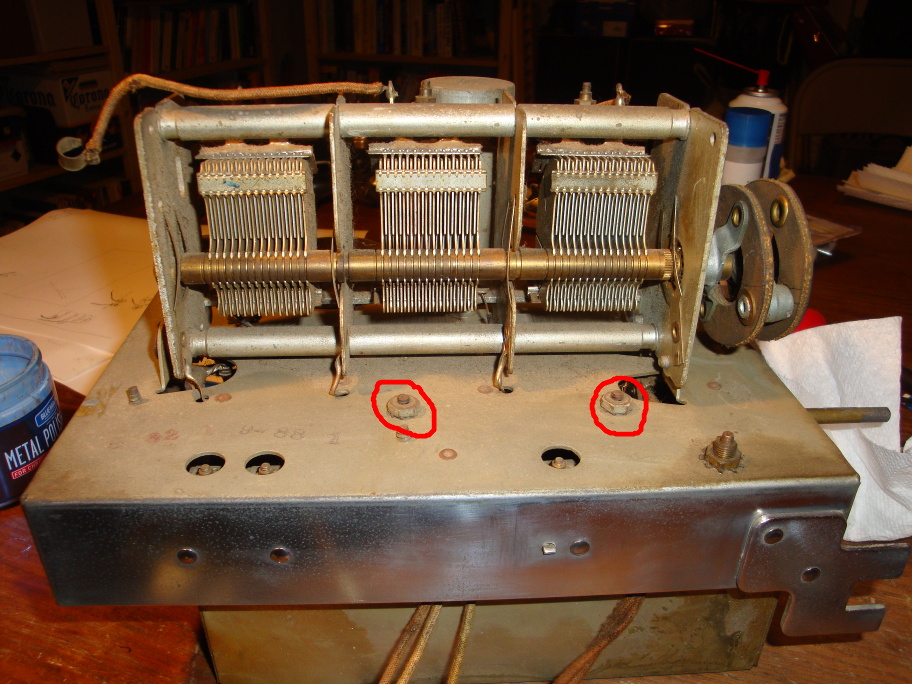

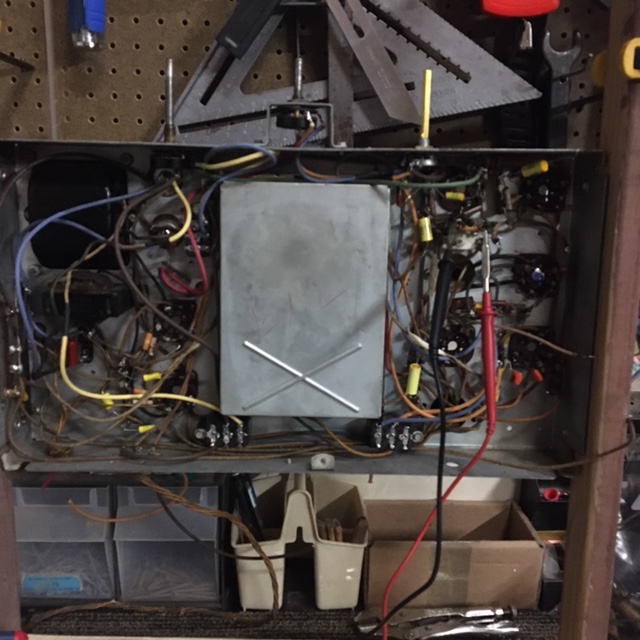

Thanks Terry, sounds like great methodology. I'd like to start by just getting the cover off to take a look, that's the part holding me up. If I can't get beyond the cover, it's no use cutting and marking wires.
I may not have explained adequately, I've attached a top and bottom pic of the chassis. It is floating between the two front supports in rubber and one bracket on the back. When I removed the aft bracket, the tuner was free to mover about 3/8ths of an inch, but not enough to move it up or down.
There are three nuts located on top, along with some trimmers, but they don't appear to be structural, more like holding a component inside. Not sure I want to try them. I'm a bit stumped!

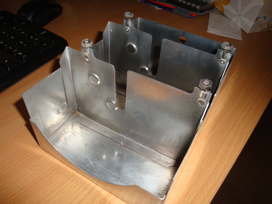

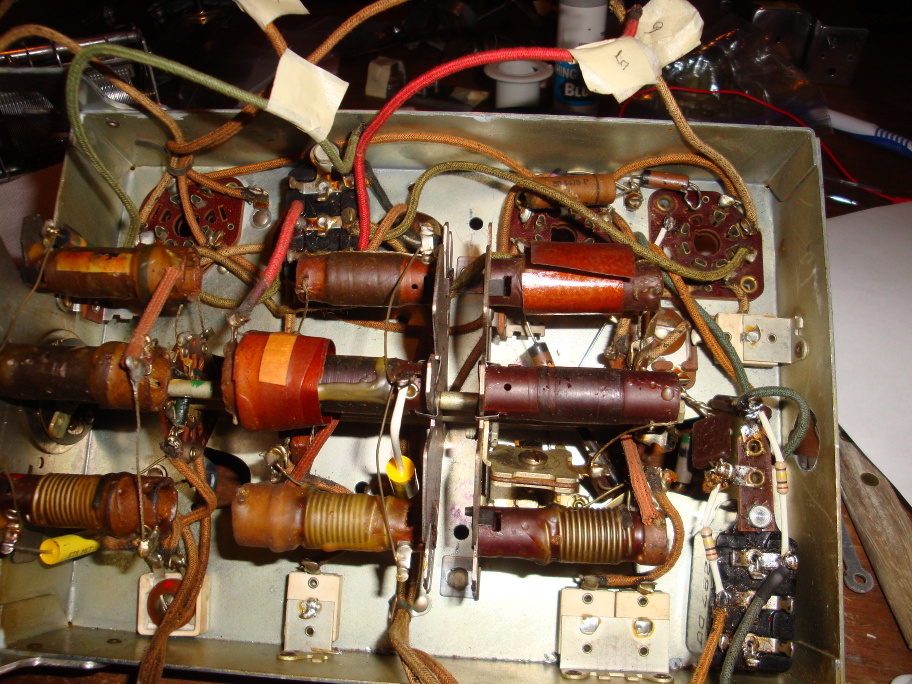

There are 4 nuts on top of the RF chassis that hold the bottom cover on. Remove them and off it comes.
The cover looks like this:
This is what's underneath, or should I say above:
I usually label the wires and draw a picture showing their destinations and their assigned number. I think there are 16 wires that connect the RF chassis to the rest of the radio. I would also recommend taking photos if you can.

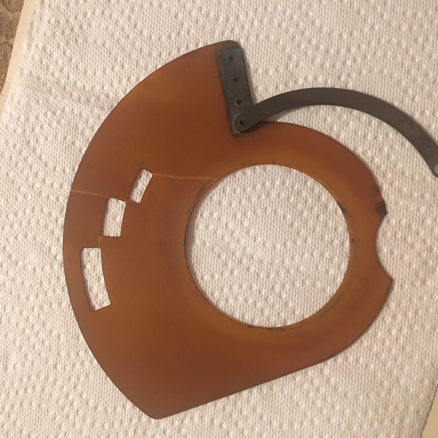

Hi folks, this is not an electrical question. All the energy put into being careful with the dial parts and I went and bumped it with my elbow and broke the Dial mask.
Anybody out that know of a source for one or a good technique to repair without impacting the illumination to much?

I've used clear packing tape on the back side to hold it together.
Posts: 4,429
Threads: 418
City: Boston
There are clear epoxy products on the market, I have not used them no experience. I have primarily used epoxy on bakelite cabinets on the inside to secure cracks or do a repair with good results. I usually put it on thick and even with the clear that may not look good when dial is lit.
You could always do a few tests on similar materials and see what you think before you do on the dial. Good luck.

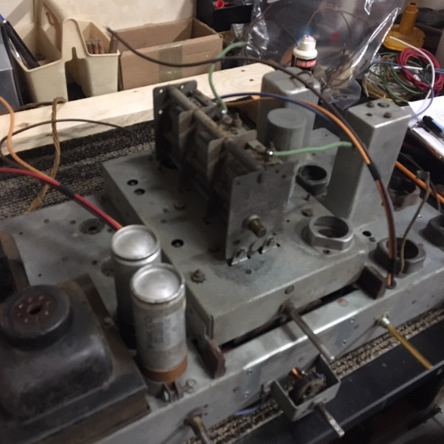

Well, my 38-2 is all back together, came back to life. I brought power to the chassis in stages; without tubes, with tube but no rectifier, than all tubes. All I could get out of it was a very low hum. I've rebuilt all the electrolytics. My plan is to disable the audio shorting mechanism in the dial assembly, pretty simple and I did have to work on it for a bit as it was in pretty rough shape, and kept shorting out. I thought I had it working well prior to reassembling it, it is the only thing I can think of as it has a full set of new tubes as well, all tested good.

Success! I want to thank the folks who had suggestions for fixing the Dial mask. I ended up doing a combination of them and got it back together nearly flat. It was warped before so it is actually turning in the chassis much better.
