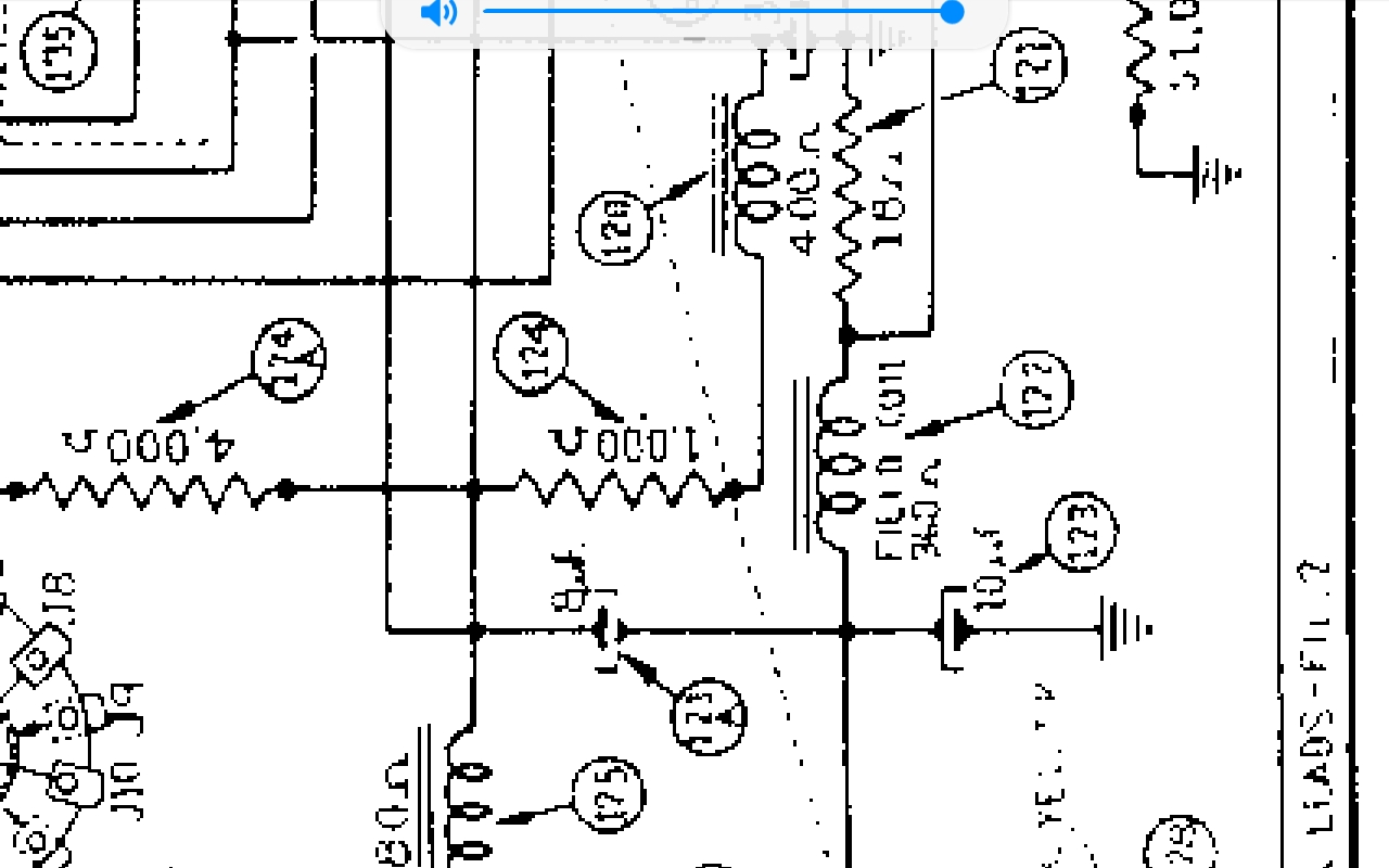

Yes, the Riders parts list for the 37-116 code 122 and 38-116 code 125 list the voice coil and field coil as the same part number, yet they list the resistance on the schematic as 400 ohms and 350 ohms respectively (I have high res scans that clearly show the part numbers.) I suppose the discrepancy is of little consequence considering it's a small percentage. Just wonder why the discrepancy. Probably different people with different sources drawing up the schematics. Regardless, the 37 and 38-116 speakers do seem to be interchangeable. Thanks morzh!
Probably more info than you wanted, Miken!!!
This is Riders 37-116 sch, I cut out the field coil part.
Doesn't look like 400 to me.
The one that says 400 is the choke, the FC, part #122, says 360.

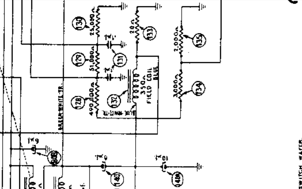

Now to compare, 38-116.
Part #132
But the best part is, bith radios list the FC as PN 36-3788. Which means, they use the same field coil.
Coupled with the same cone/voice assy, it makes it the same exact speaker.

Oops!  I'm cross eyed.  I was looking at the choke, which is 400!  Mea culpa!
