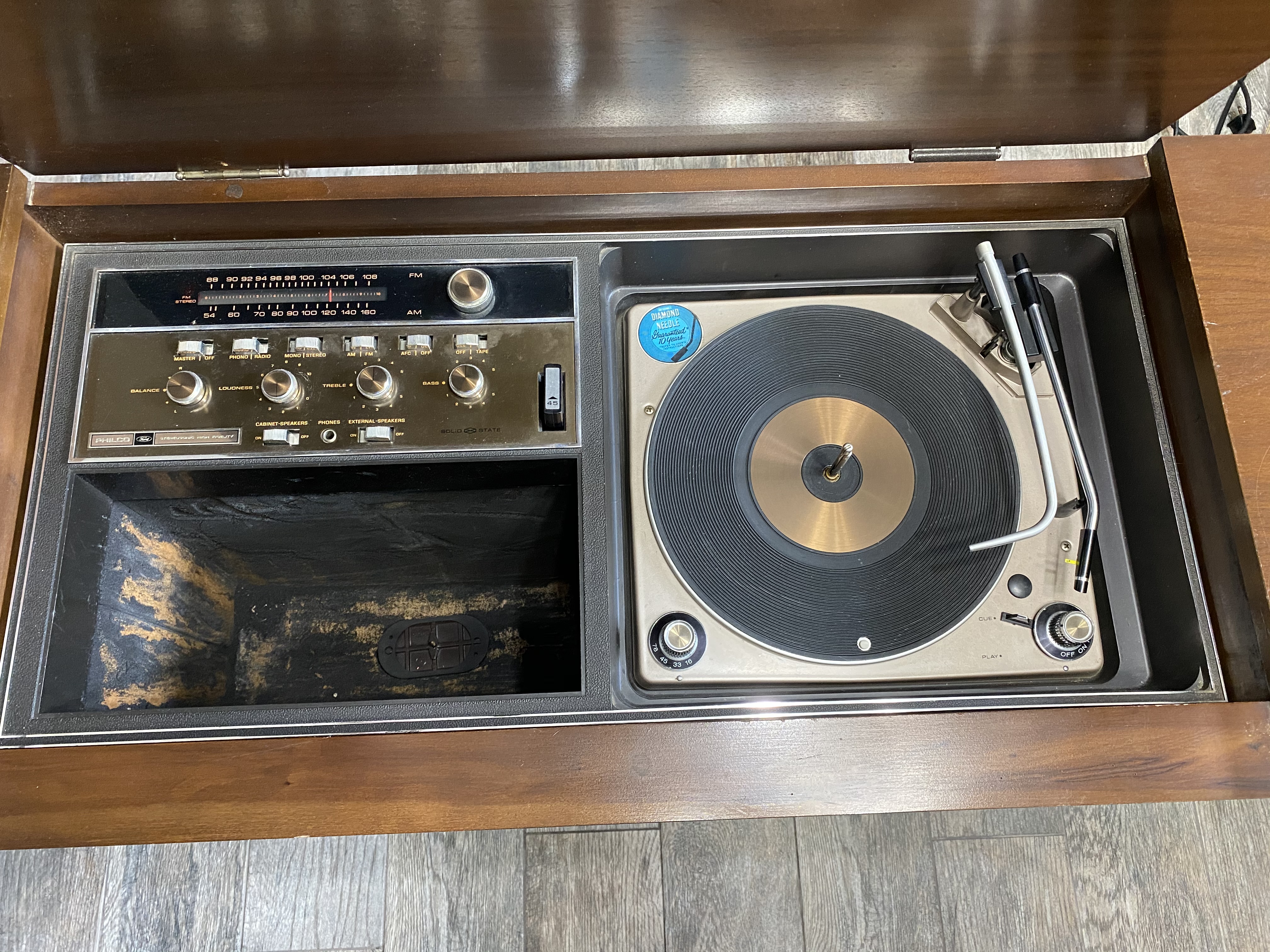

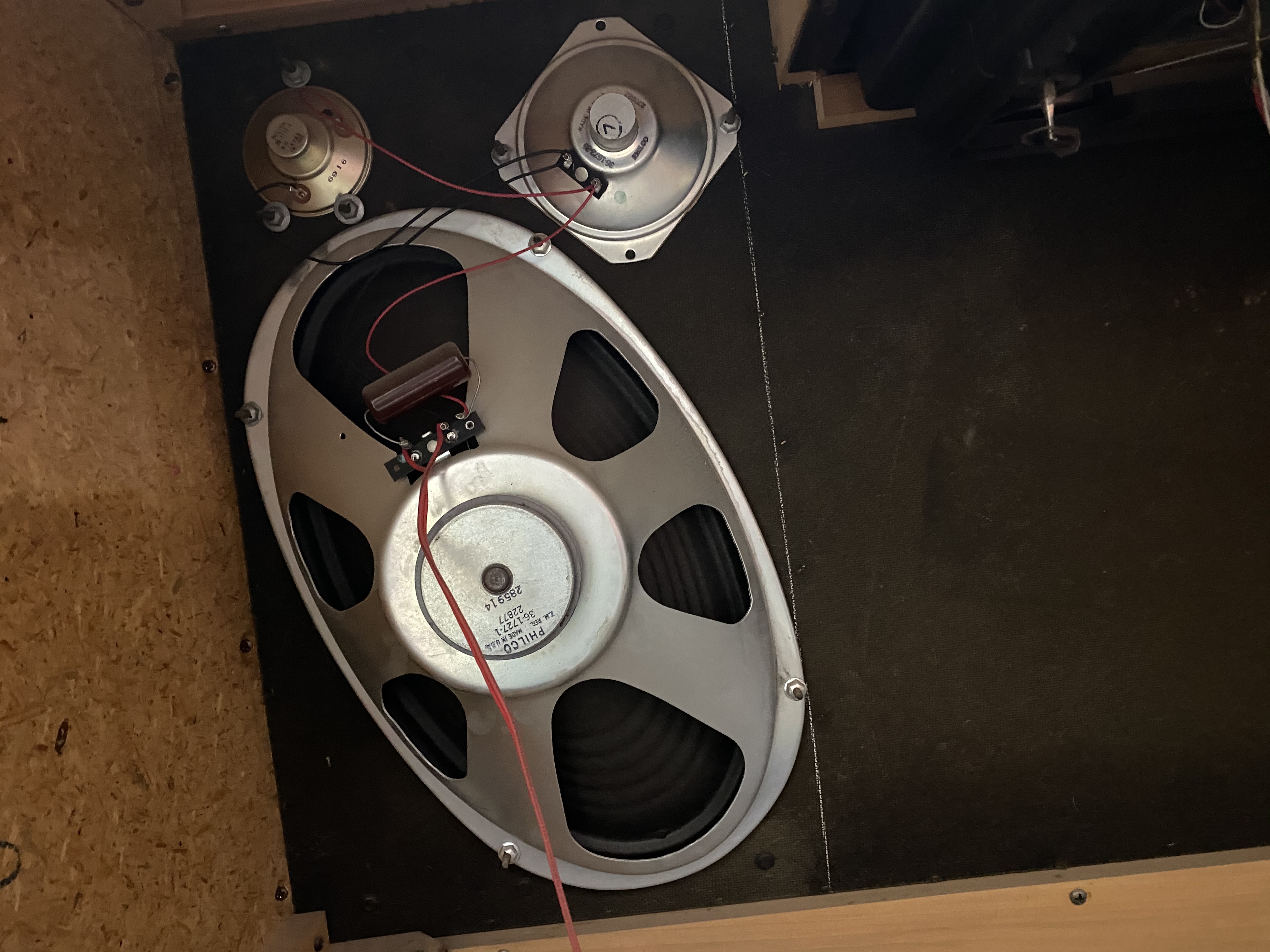

Thank you for taking the time to help me with this project. I have recently picked up a used Philco Record Cabinet. From what I can gather, this may be a ~70's model? Other than that, I do not know anything about this and am having trouble locating a model number. Here are the issues I am experiencing, and would greatly appreciate any help or advice! This will be my first radio project, so I do not have much experience.
1. Curious if anyone knows the model/how to find it, and maybe a set of instructions?

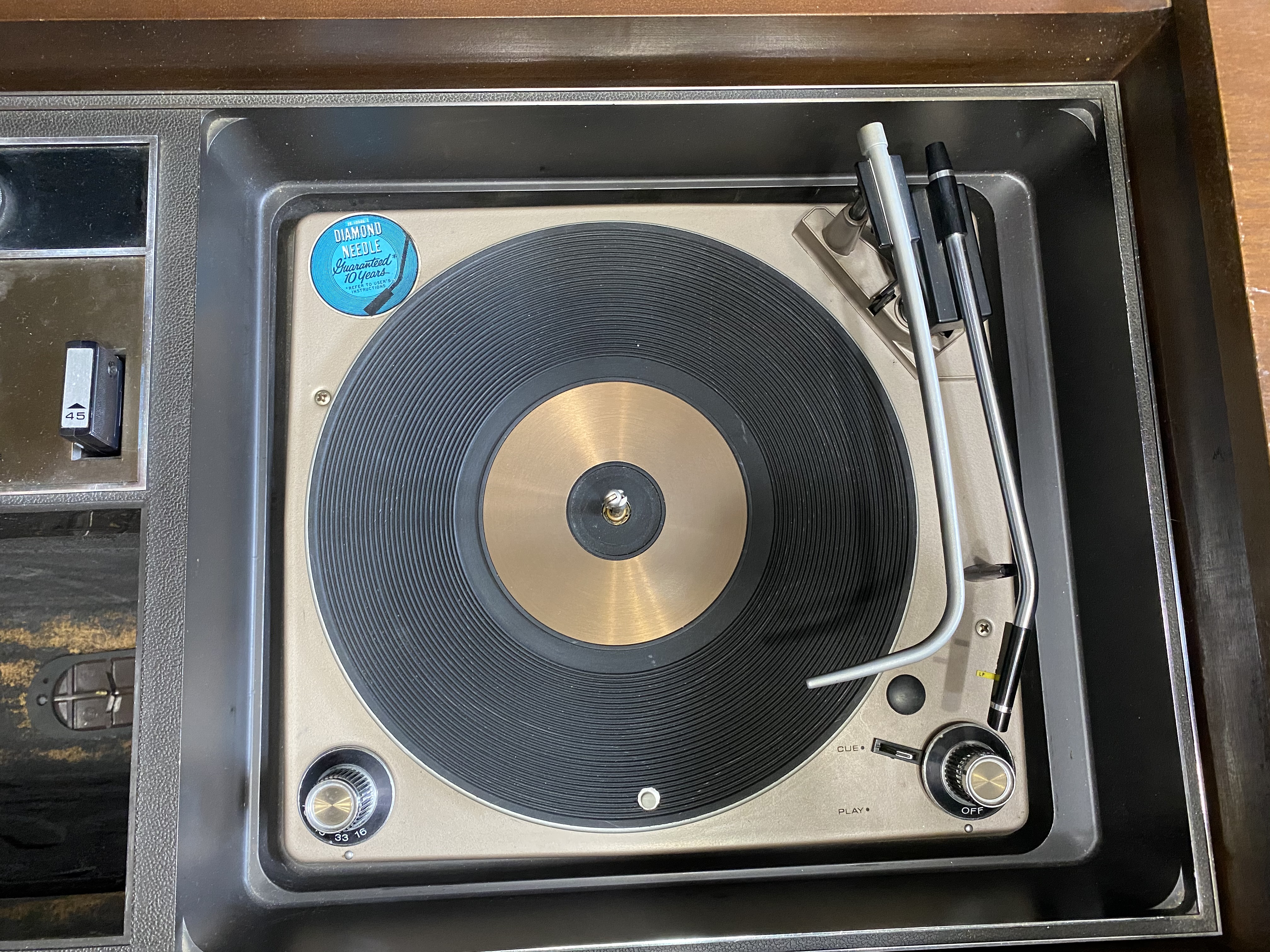

2. Currently the record player itself is somewhat operable, sometimes I have to spin it a little for it to get going, but then it will play. It is a little noisy, maybe needs to be cleaned/greased? Not sure where to start here! (Also frankly not 100% sure how to operate it)

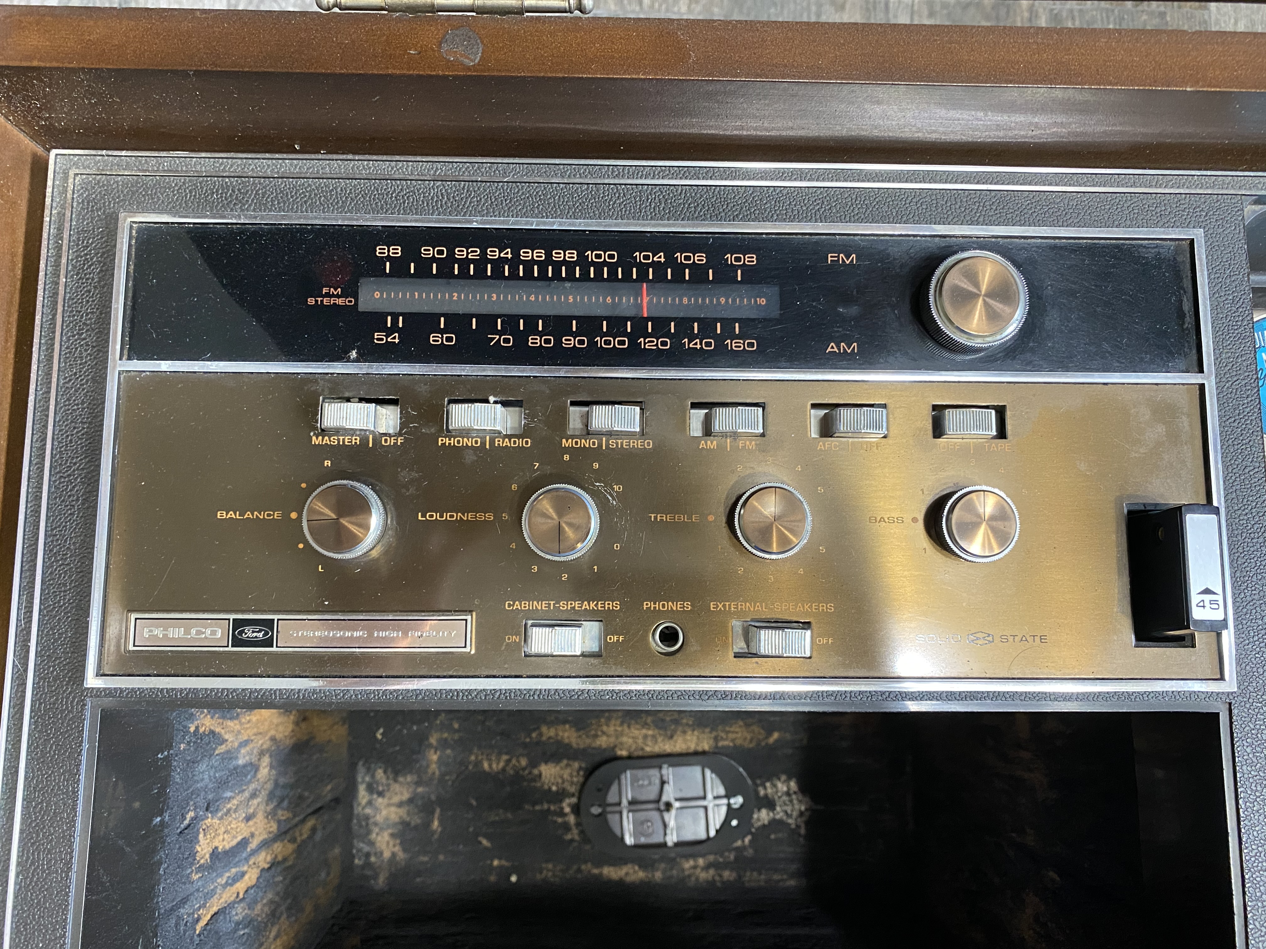

3. I want to say that the instrument panel needs some work, when I turn the it on sound only comes out of one speaker, but even if I turn the balance knob, it doesn't change anything. The volume knob works, but seems very loud at 2/10, and then quieter at 3/10, then louder, etc. I want to say that maybe they need service? (Some of the switches are very hard to move as well)

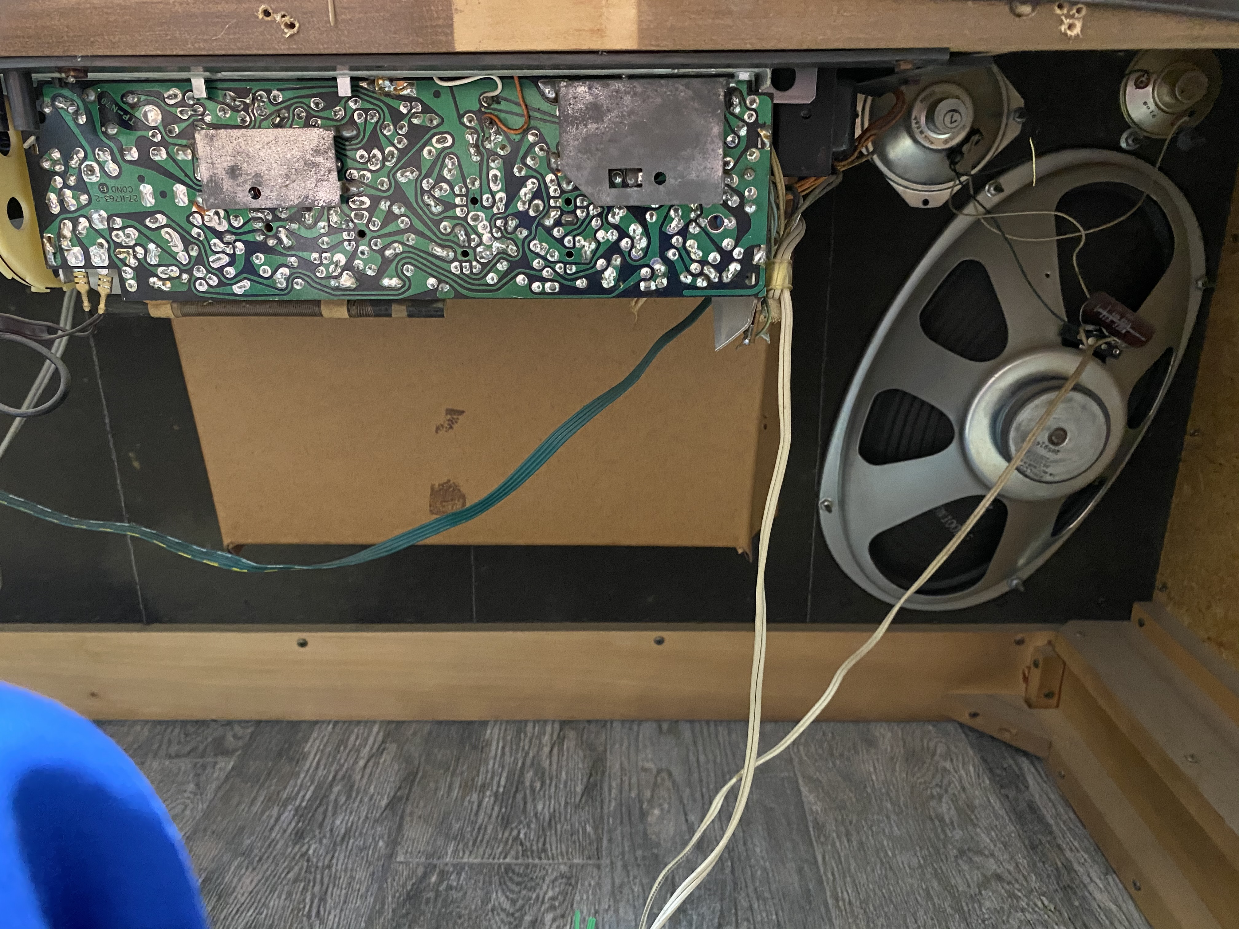

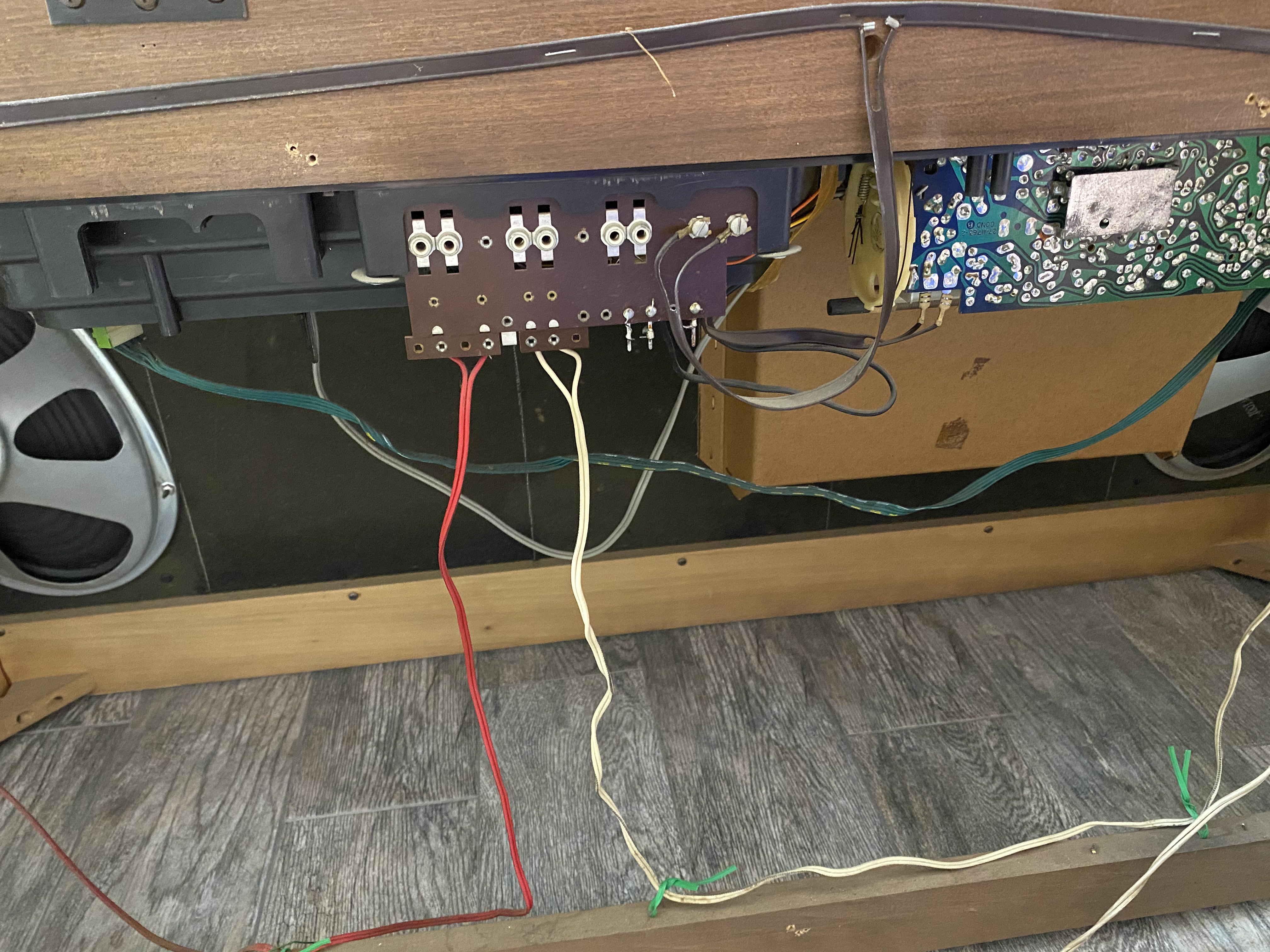

4. Not sure if the cause of only one speaker working is related to the instrument panel or something else altogether.

3. It sounds like controls need to be cleaned. If you've never done this before, ask for help. This is not something to be done any old way, and you can't just use anything to clean the various controls. Switches will need DeoxIT; volume, tone and balance controls should use Caig FaderLube (only).
4. It could be one (or more) of many things. Dirty controls, a defect (or even more than one) in the amplifier, or both.

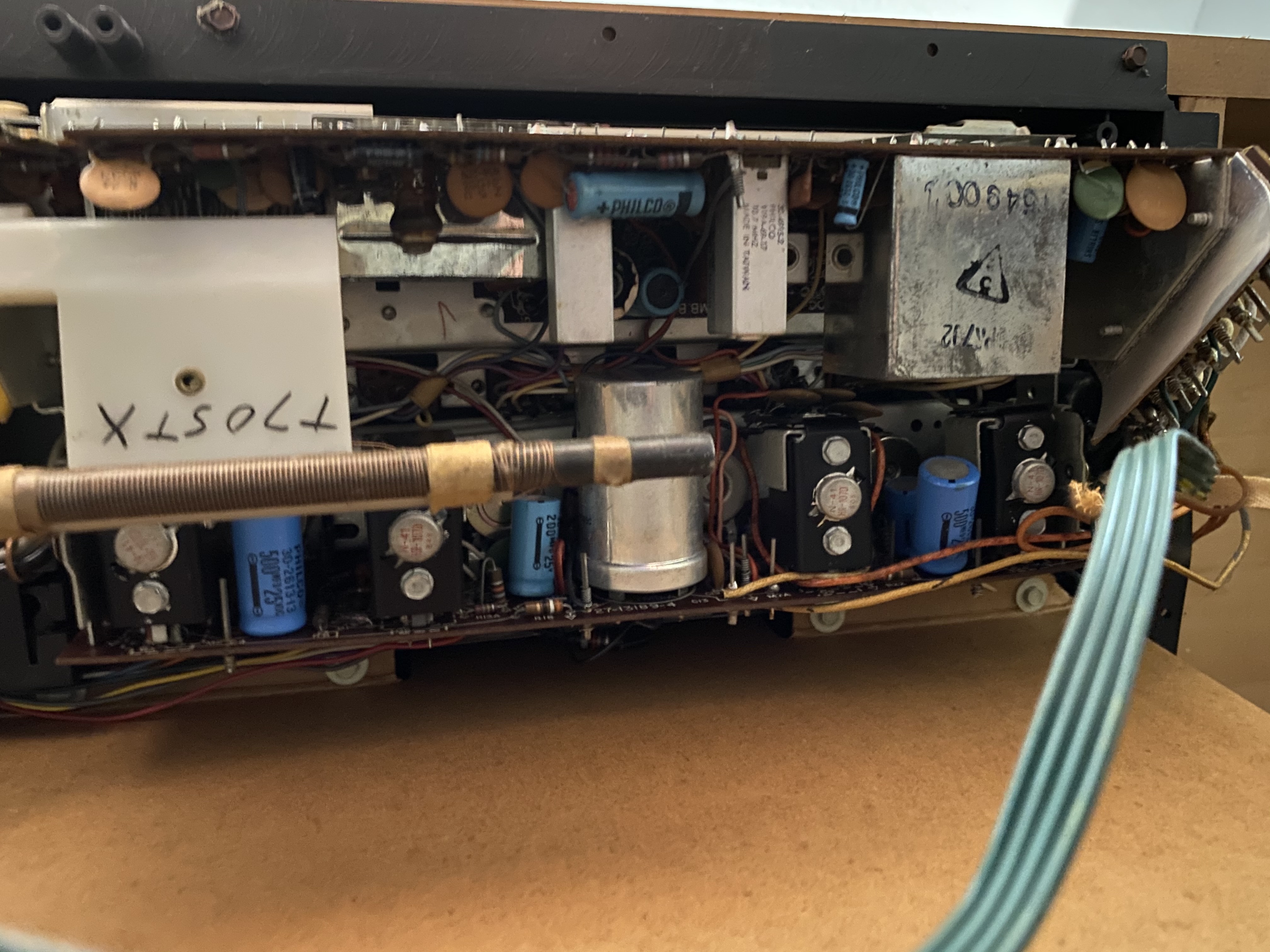

1. Unit does have a back, however no model number there unfortunately. I added a couple of more photos that didn't make it through before

It's likely an early 1970s or possibly very late 1960s model. But without a model number, servicing is going to be tough.

The Record Changer appears to be V-M (Voice of Music), popular turntable for most American brands except most Magnavox (used Collaro) and most RCA (Built their own?). Rather simple turntable, decent. There are a few V-M sites on the WWW, some U Tube vids on disassembly and cleaning. Biggest issue with these (and almost any other turntable of this vintage was the idler wheel (capstan roller) and spring The roller dries out, losing traction. These are no longer manufactured and require rebuilding Think that even NOS Idlers are going to be dry. Several ePay sites offer rebuilt idler wheels. Next biggest is the motor bushings. (Motor is Alliance Genie.) Third biggest is the "changer mechanism". They were usually lubricated with a white lithium grease like Lubriplate ™. Guaranteed that has dried out. Rubber motor mount grommets may also require replacement. There are a few websites
I don't have specific documentation but you could lube the turntable hub and bearing with a good machine oil. ditto the tonearm. The Drive motor bearings are likely "Oilite", but likely require lubrication The motor is easily disassembled and the armature is usually self centering. Otherwise shim during assembly and remove the shims. Note, make sure that you don't assemble the motor upside down, it will turn backwards. (Found that out as a kid, and in 7th Grade, disassembled the Classroom Telechron clock and reassembled to run it backwards. Sister Margaret Miriam was not amused.) There are felt pads around the oilite bearings and a drop of oil helps. Be VERY careful not to over lube and absolutely do not get any oil on the idler wheel!!! Less is more. The cam mechanism is going to be more difficult. Degreasing the mech is a good idea. Take pix of the location of grease if attempting to disassemble or degrease.
Regarding the speakers, the set may play rather nice with what is there. Not very high tech;2 way and 3 way speakers when the woofer is a 6X9 radio grade speaker in an open back cabinet were a marketing ploy to sell these systems as having the same technology as Fisher, Scott, etc. If there is an aux input, pipe through something from an iPod to evaluate the sound. MP3s will usually sound better than vinyl (sorry purists).
