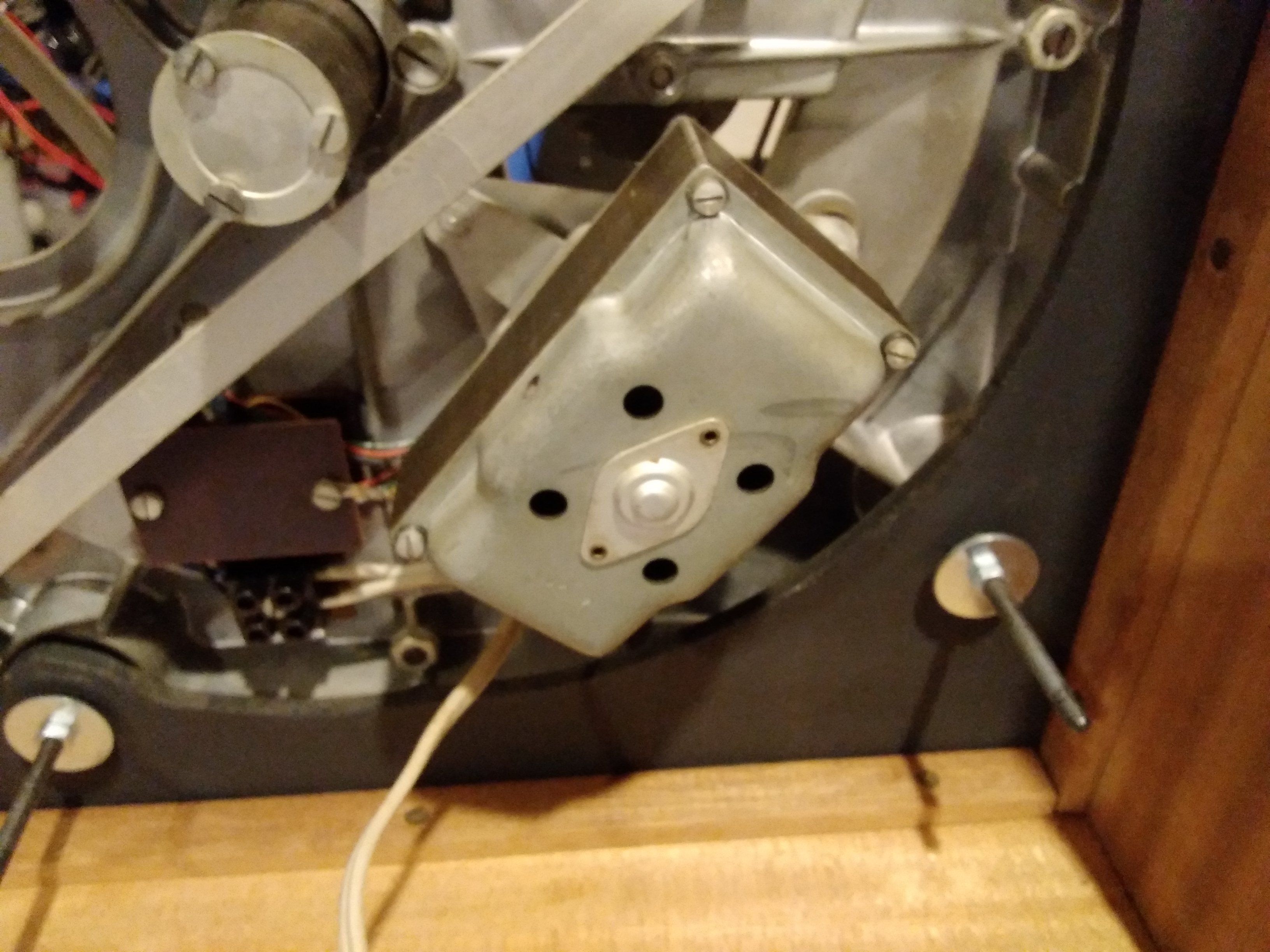

Today I took the platter off.
Immediate ovservation: the motor runs fine. Big whew! Even if it needs some lube (perhaps), it is running.

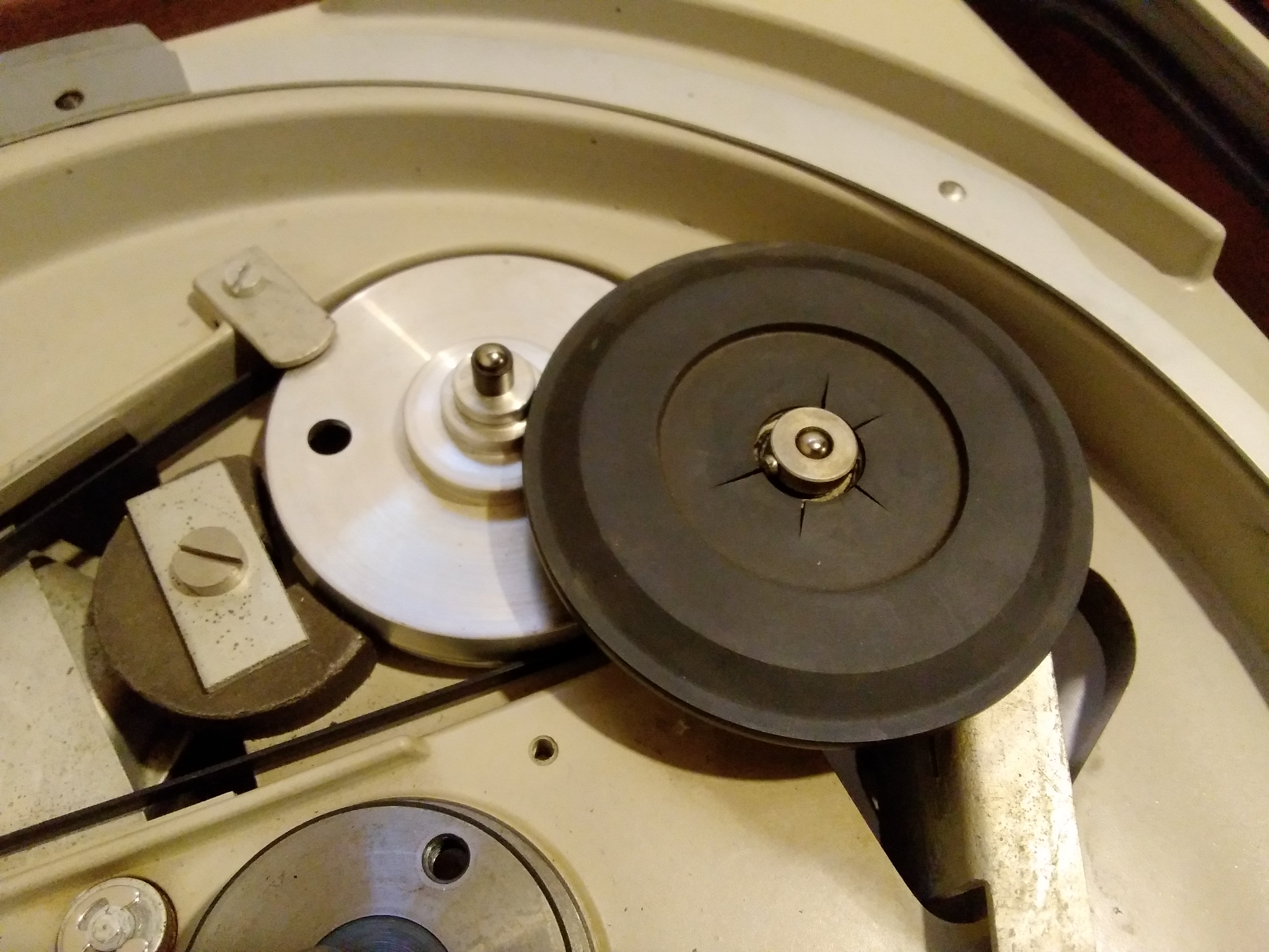

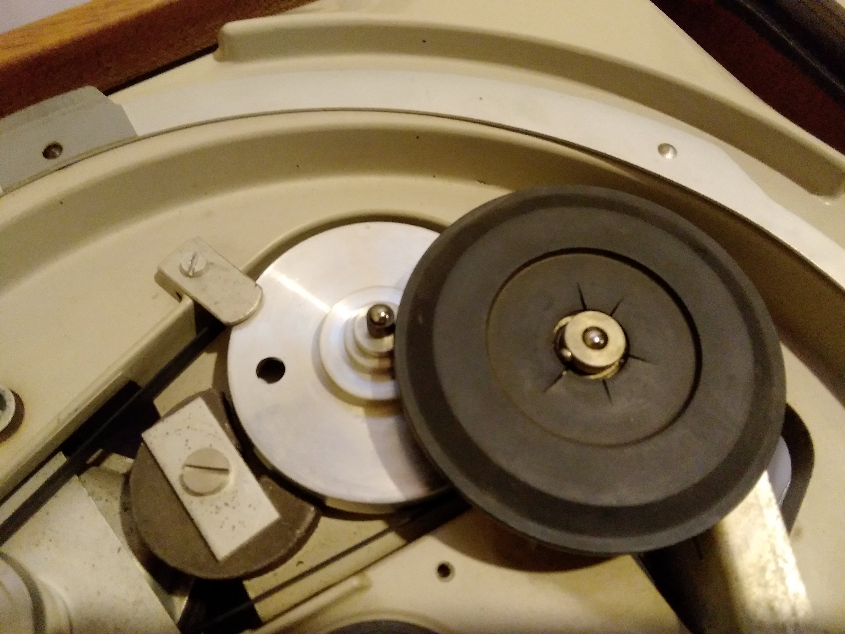

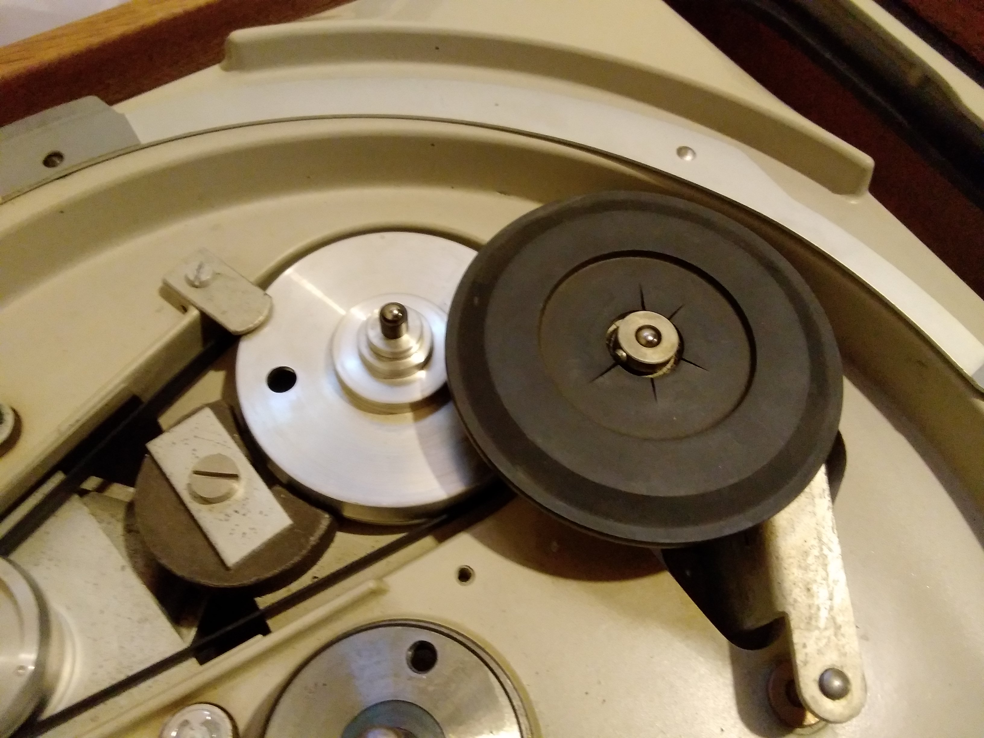

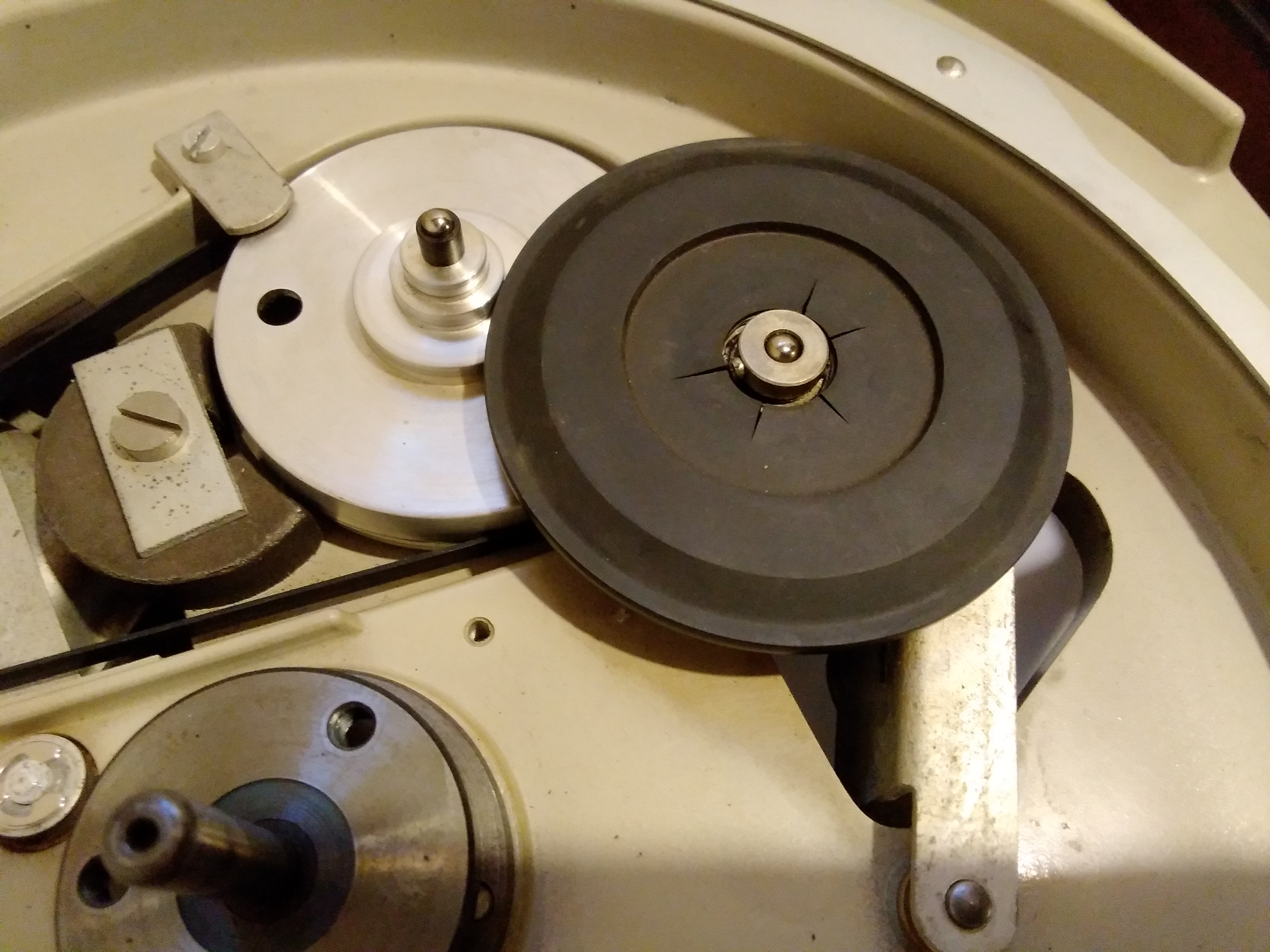

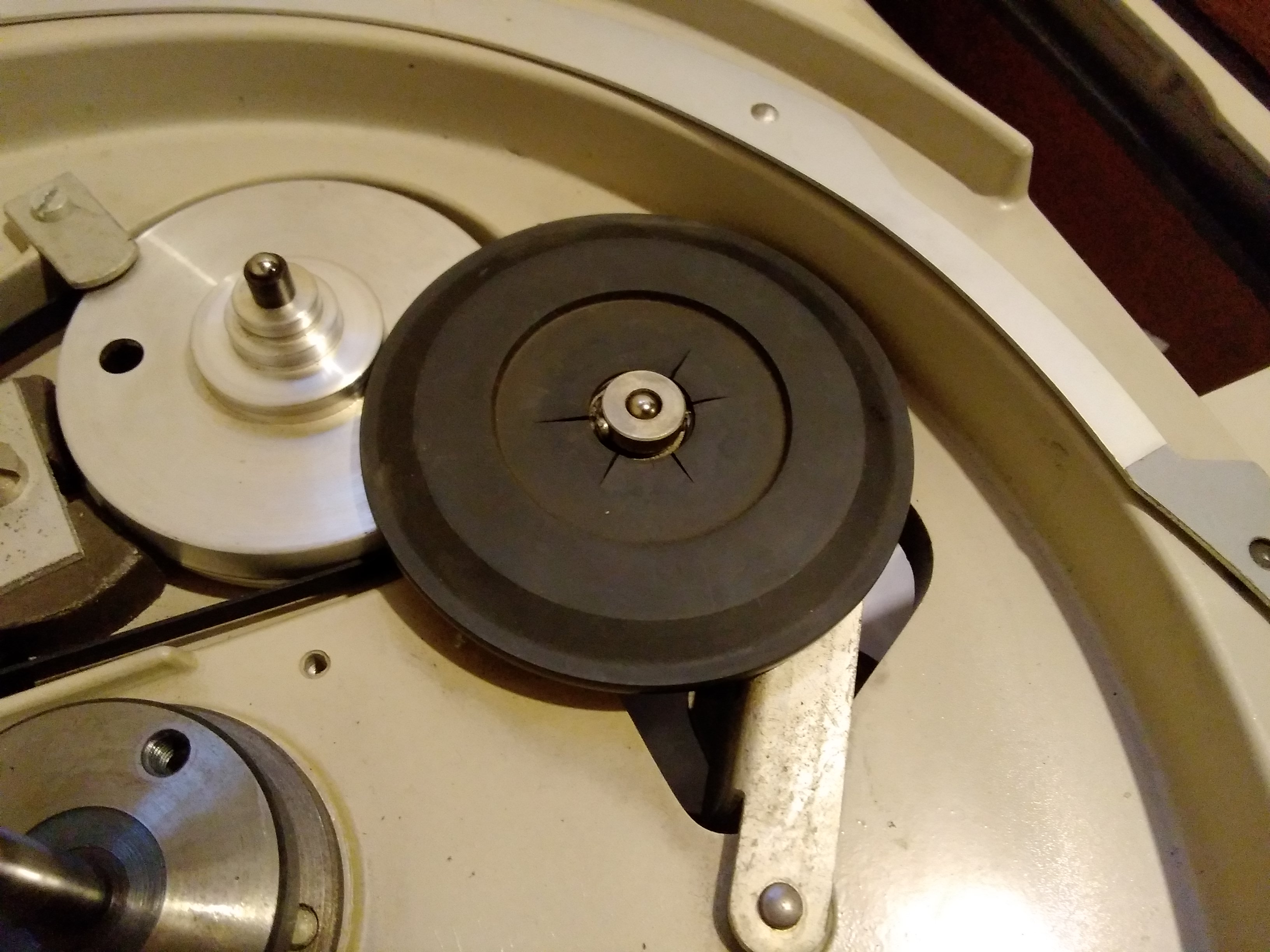

Here is the idler in 78 rpm down to 33 rpm positions.
1) the idler has cracks
2) in the 16 rpm it does not touch the shaft, and then it will touch it when pushed.

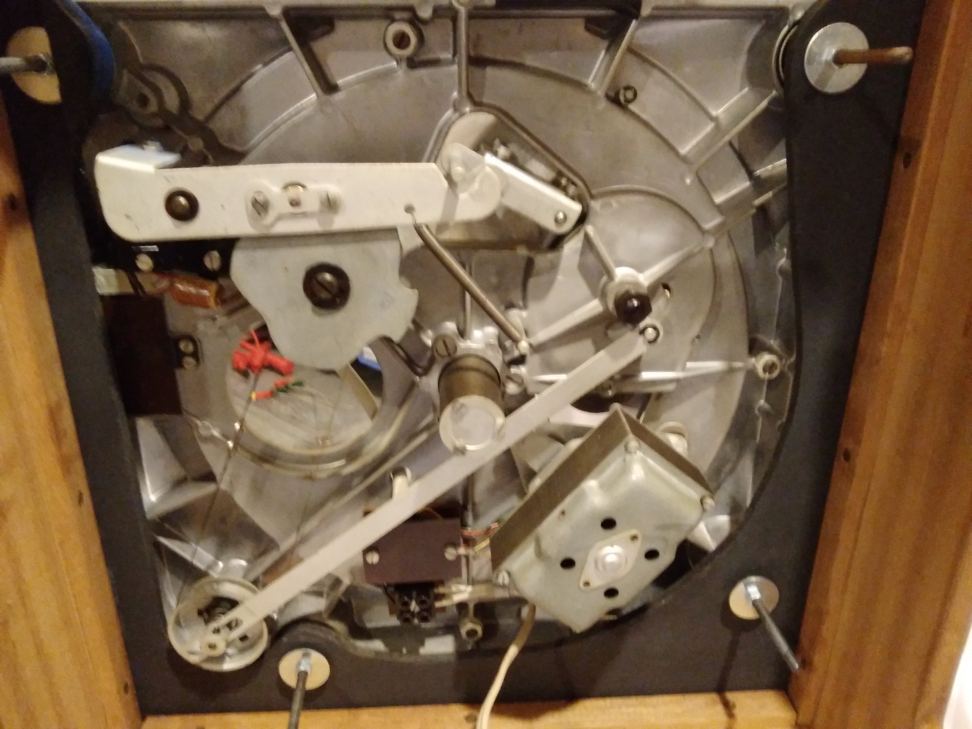

The underbelly.
Also need to know a good place to get idlers.
One of the two setscrews on the hub that holds idler down refuses to come out.
Have tried PBlaster and heat.
No luck.

Thanks, I will write to them. Provided I can take that thing off

First oder of the day is to try to take it off. One set screw just doesn't budge.
I am dripping PB on it, every few hrs . In a couple of days I will try again as so far I am just damaging the screw.
Just called the Voice of Music.
They either send you the part from stock (rarely), which is someone's old re-rubbered part, IF you send them your old part, or you just send the old part and wait for it to be re-rubbered. Takes 4-5 weeks.
Quite ok, no rush. It has waited 6 years, will wait a few months more.
