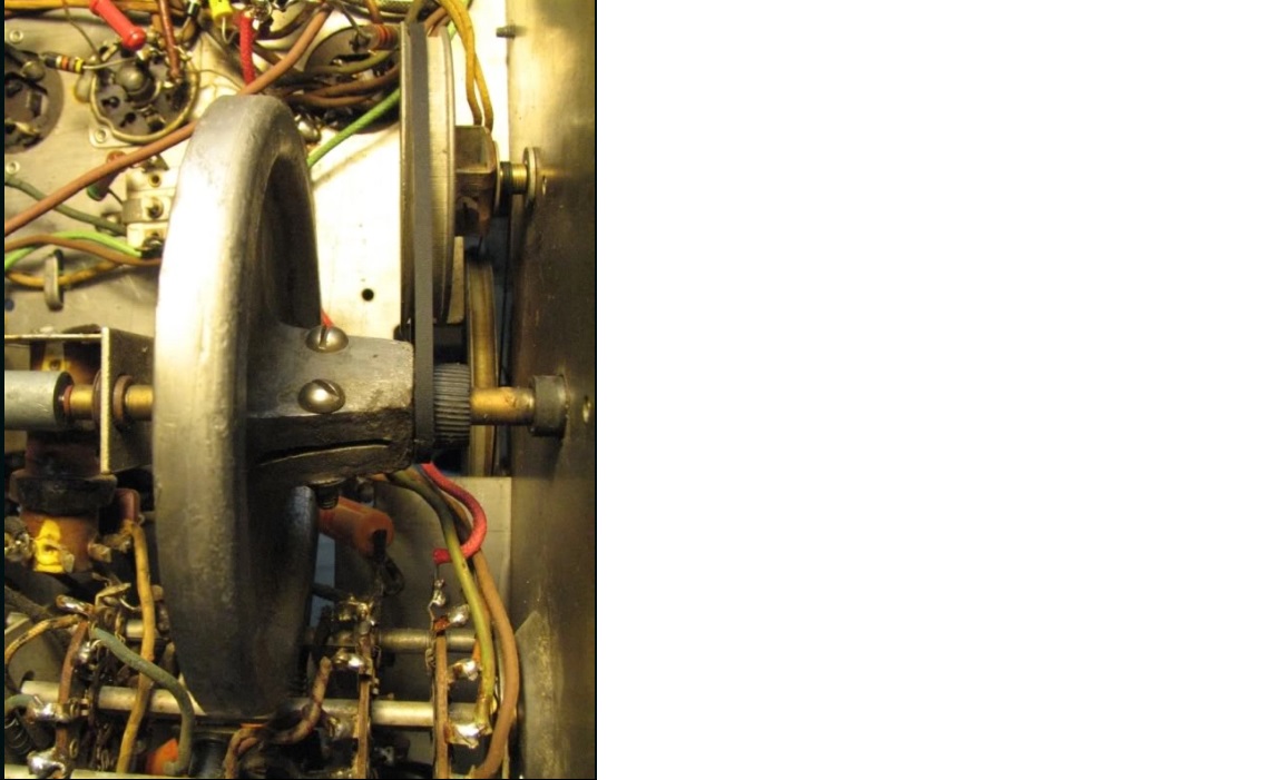

Hello everyone late last year I had bought a 1942 Zenith 10S690 Zenith Console Radio that when I got it the belt that was on it had broke (someone had rigged it up with an old O-Ring style belt that ended up breaking) and so I had temporarily rigged it up with some old VCR Square Belts which it worked fine that way for a little bit but then the belt slipped off the flywheel tuning knob shaft and so then the tuner didn't tune as easily (it had two VCR Square Belts rigged up to it), but then I finally found another O-Ring Style belt like what was on there before but then unfortunately when I tried installing it the plastic pulley shaft cover that was on the shaft of the flywheel tuning shaft broke into several pieces and I tried to glue it back together and it wouldn't go back together.
So now I need to figure out a way to fix the Flywheel Tuning Shaft so that I can install a belt back onto it again, and the way the pulleys were designed on this radio I have a feeling this was designed to work with a flat belt originally, which I think I have some flat belts from some old VCRs that might work on this if I can get the flywheel tuning shaft pulley repaired.
Any one have any ideas of how to go about repairing the pulley on the flywheel tuning shaft on this radio?
Any help with this would be appreciated.
See picture below.

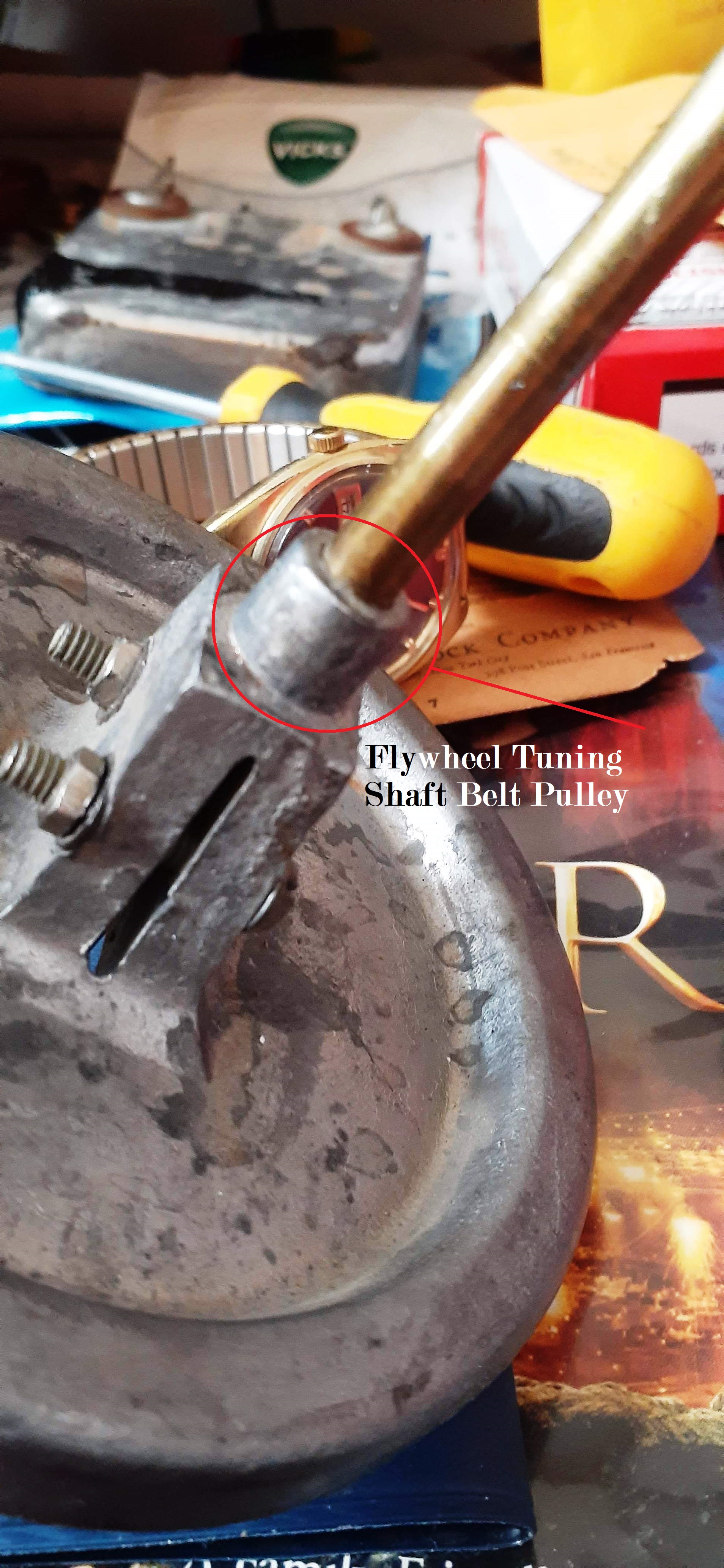

Hi Eliot, the part I'm referring to was a plastic sleeve that went over the area circled in the picture, so no the part is not in the picture, it was a piece of knurled plastic that went over the area circled in the picture, but it broke when I was trying to put a belt onto it.
Also the flywheel on this thing is cast aluminum not pot metal.

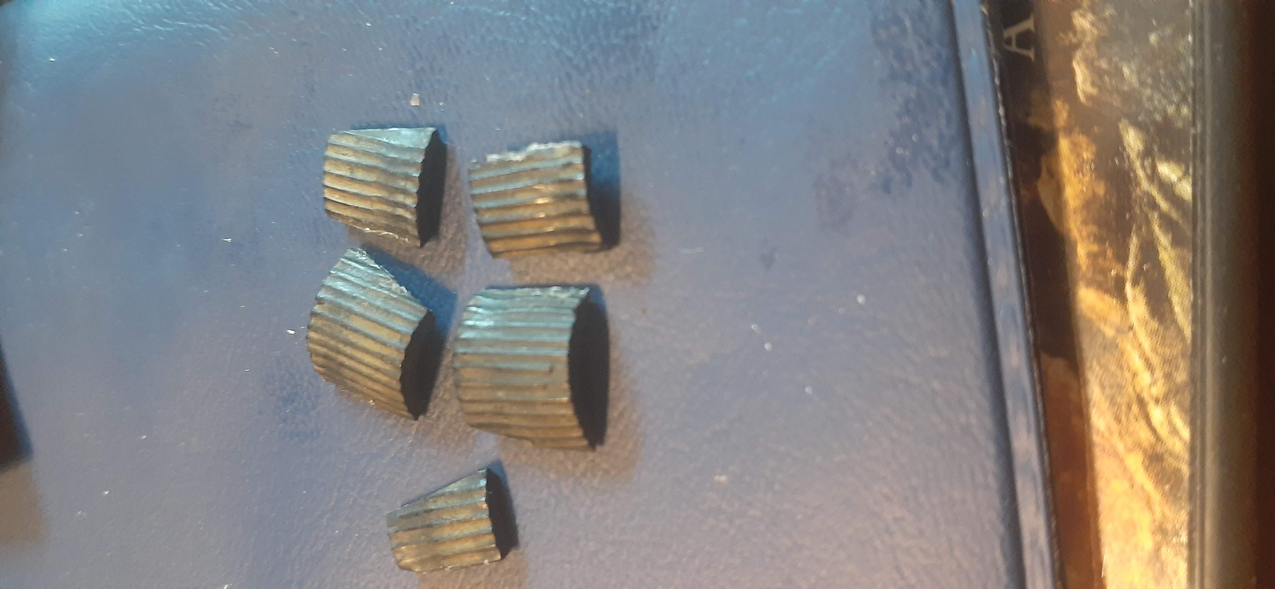

The picture posted below is the part that was on the area circled in the picture, as you can see it broke into several pieces, it looks like some sort of plastic material, like bakelite or something like that.

If you can figure out how to put the pieces back together for long enough to make a mold, then you could cast the part. The mold putty is pretty easy to work with. Then use a 2-part plastic mix. It does not look much more complicated than a knob. Lots of people make knobs for themselves.

I did try to glue it back together, but then it broke apart in other spots, unfortunately the bakelite, (or whatever kind of plastic it is) is too brittle to try and make a mold out of it.

I'm just going to toss out a couple of things and maybe one will work or it might give you another idea.
I'm not sure how well this would work, but you could try something like Milliput or Plumber's Epoxy and make a new one. This stuff is a two part putty that when mixed makes a substance that can be molded and sculpted like clay. You might only have 6-8 minutes before it starts to set. There are YouTube videos on Milliput you can watch and get a feel for how it works.
The other idea is to find some plastic, epoxy, or PVC tubing (hobby shop, eBay, or plumbing section) with the right inside diameter and mold some of the above putty inside and shove it on the flywheel. Then cut some shallow slits on the surface for the belt to grip. Or mold some putty on the outside like the surface of the broken piece.
And a bonus third idea (and probably the best). Place a classified ad for one on here and the other radio forum. Include both pictures and I'll bet someone has a parts chassis they can get that piece off of. I had a ratty '42 Z console I drug around for years picking parts off for myself and others. Veneer, dial glass, band switch, tuning knob, & power transformer, it was a shell when I eventually have it away.
Edit: after doing a search and seeing where that piece goes I think Murf's idea of wrapping some friction tape around the shaft has merit at least as a temporary fix.

Find a rubber automotive hose with the right size inside diameter, the outside diameter won't matter as much. This method is used for similar assemblies in AK radios and works well.

I do have some friction tape, I'll try that.

I think that the plumbing putty would work as well, how hard would it be to cut some slits into the plumbing putty?

Or you could use one of the broken pieces to mold the grooves in the putty before it sets.

I like the hose idea. No groves necessary.
