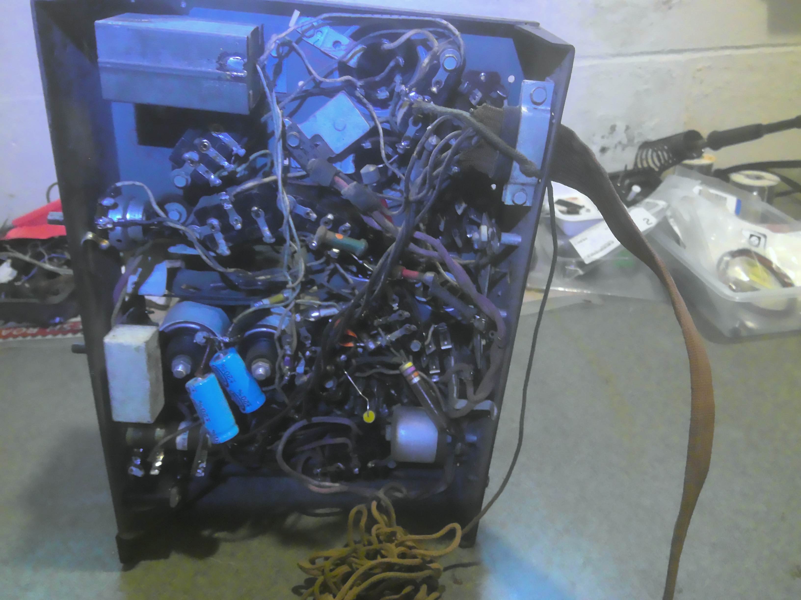

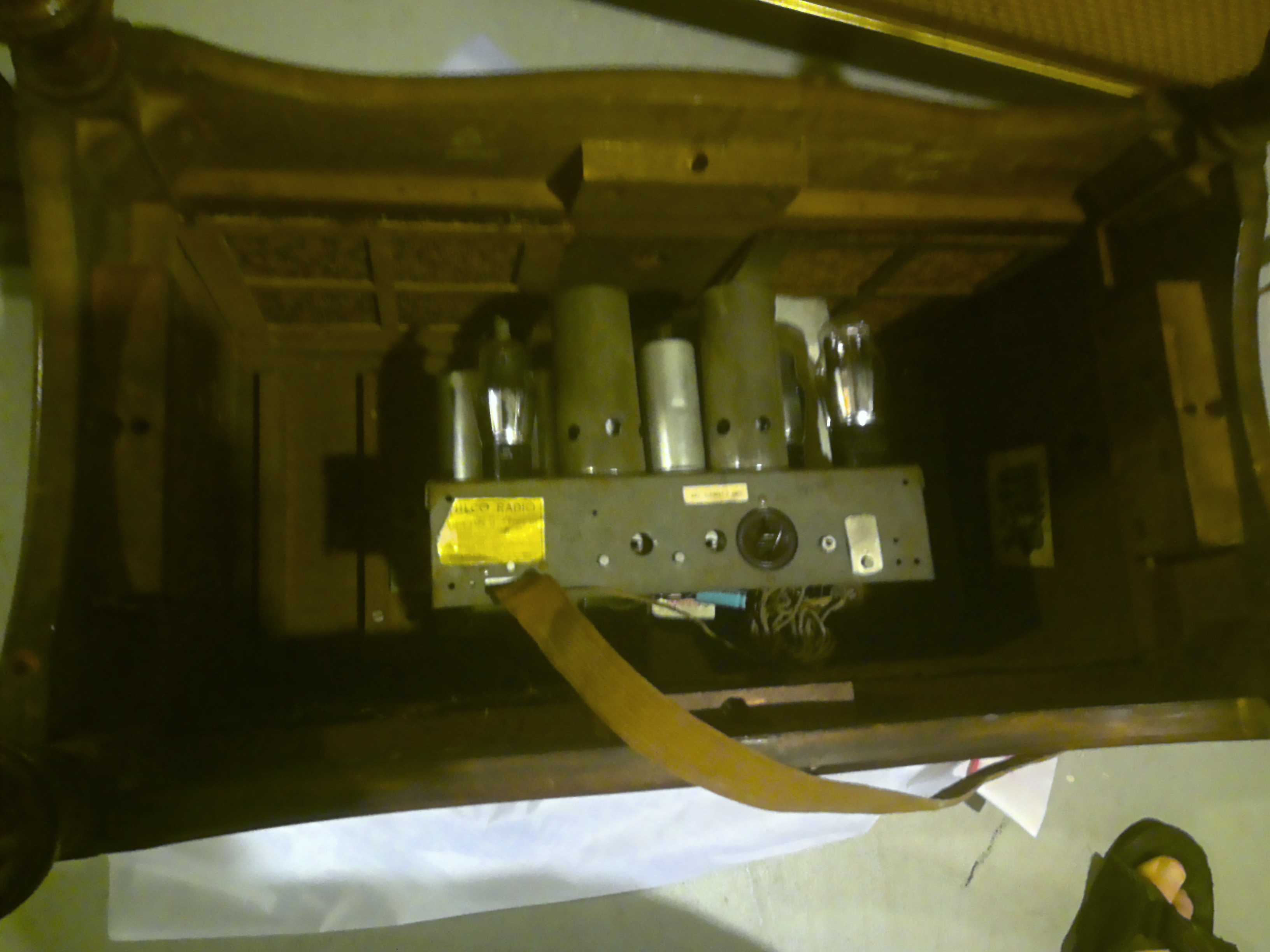

Today I took the chassis out.
Here it is.

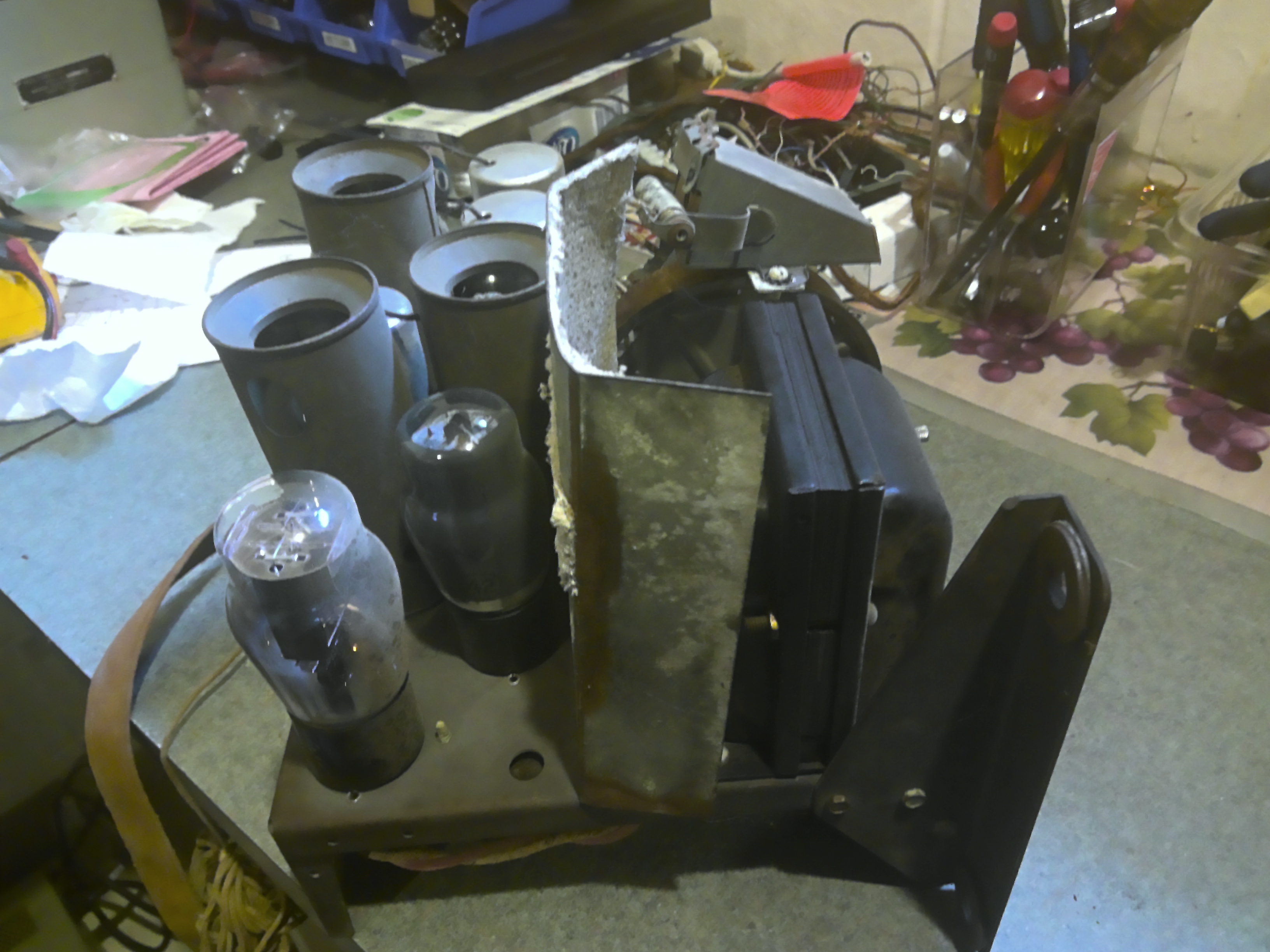

The look inside.

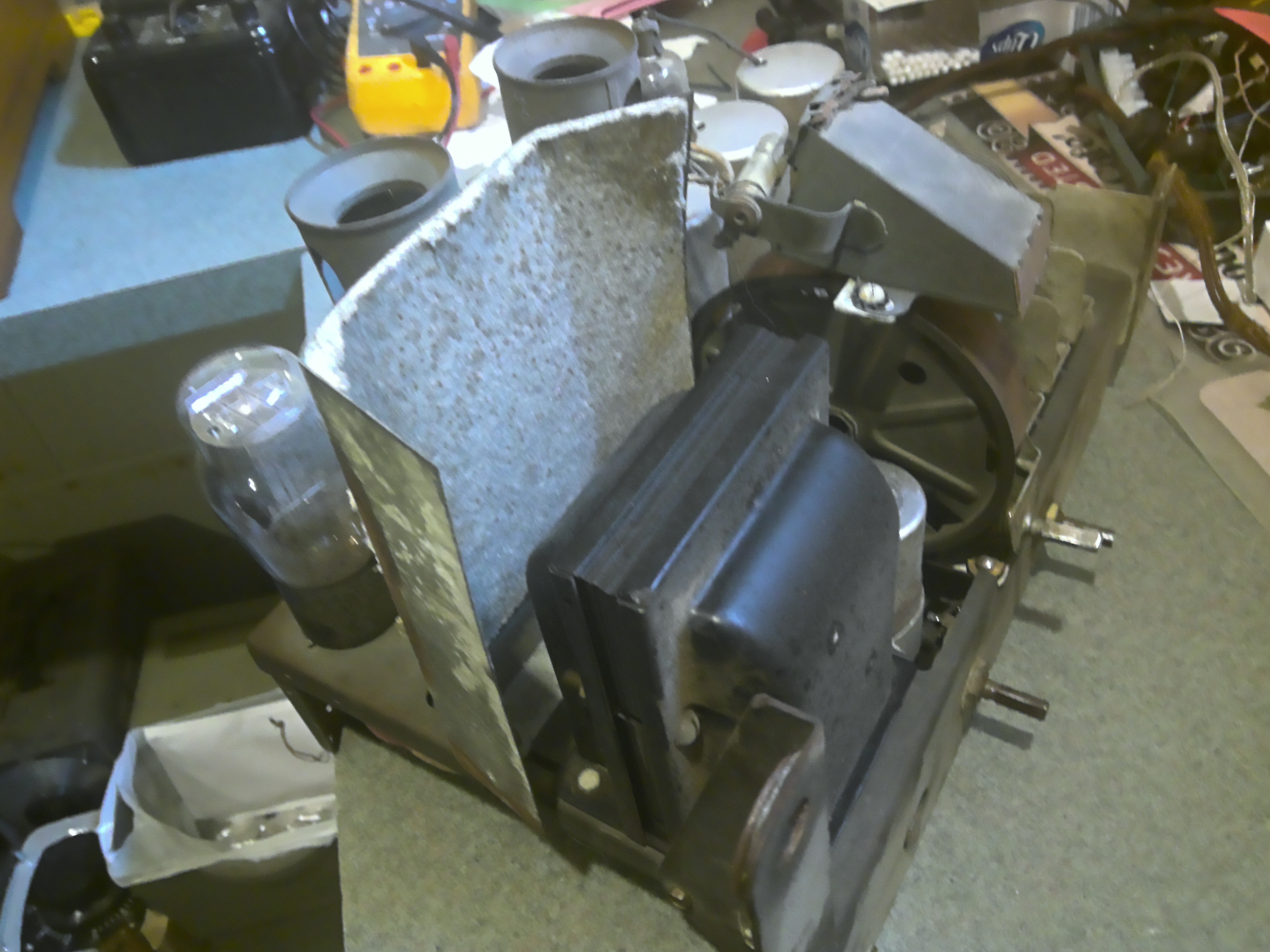

Asbestos. Never thought it would be in a 1933 Philco.

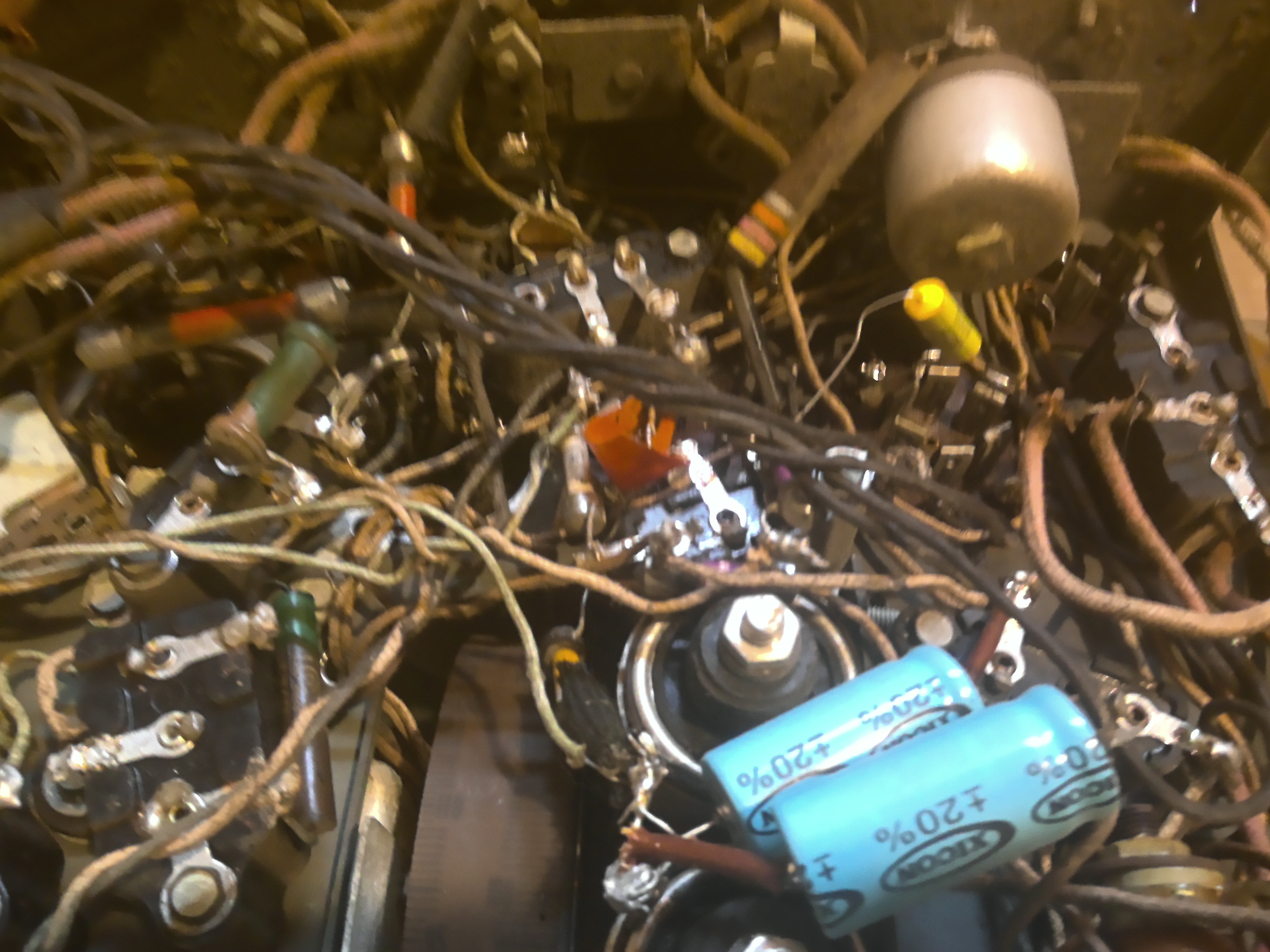

As you can see there was an attempt to fix something.
So, judging by the picture of the underchassis, methinks it is V121 V3 as there is that capacitor 0.05uF added.

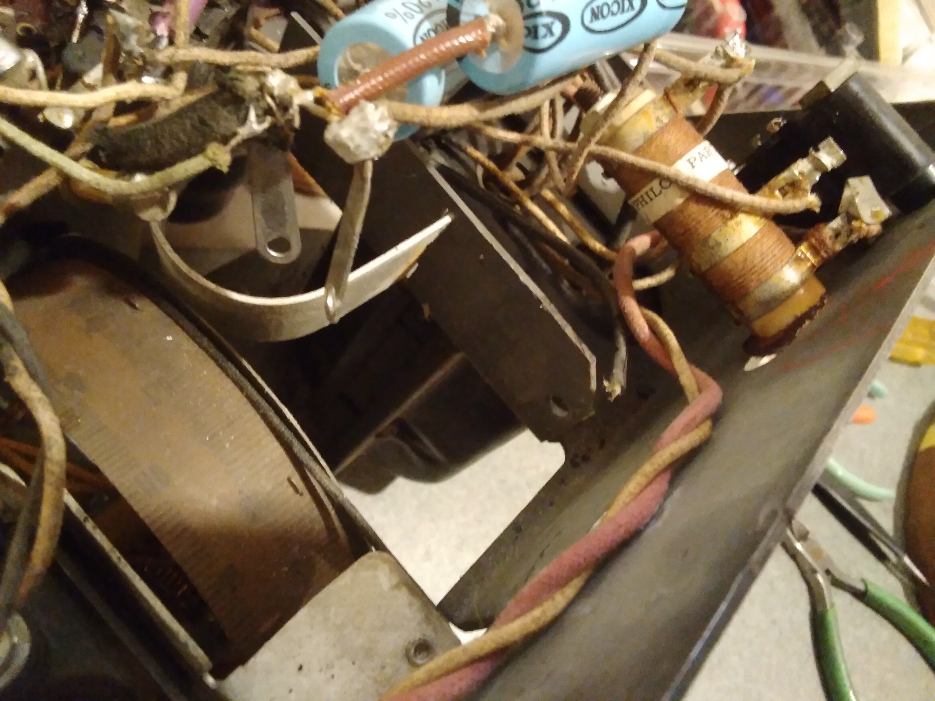

Electrolytics are another problem.
So...finished the backelites, extracted the tone control and the electrolytics. They might've been the replacements but are original Philcos.

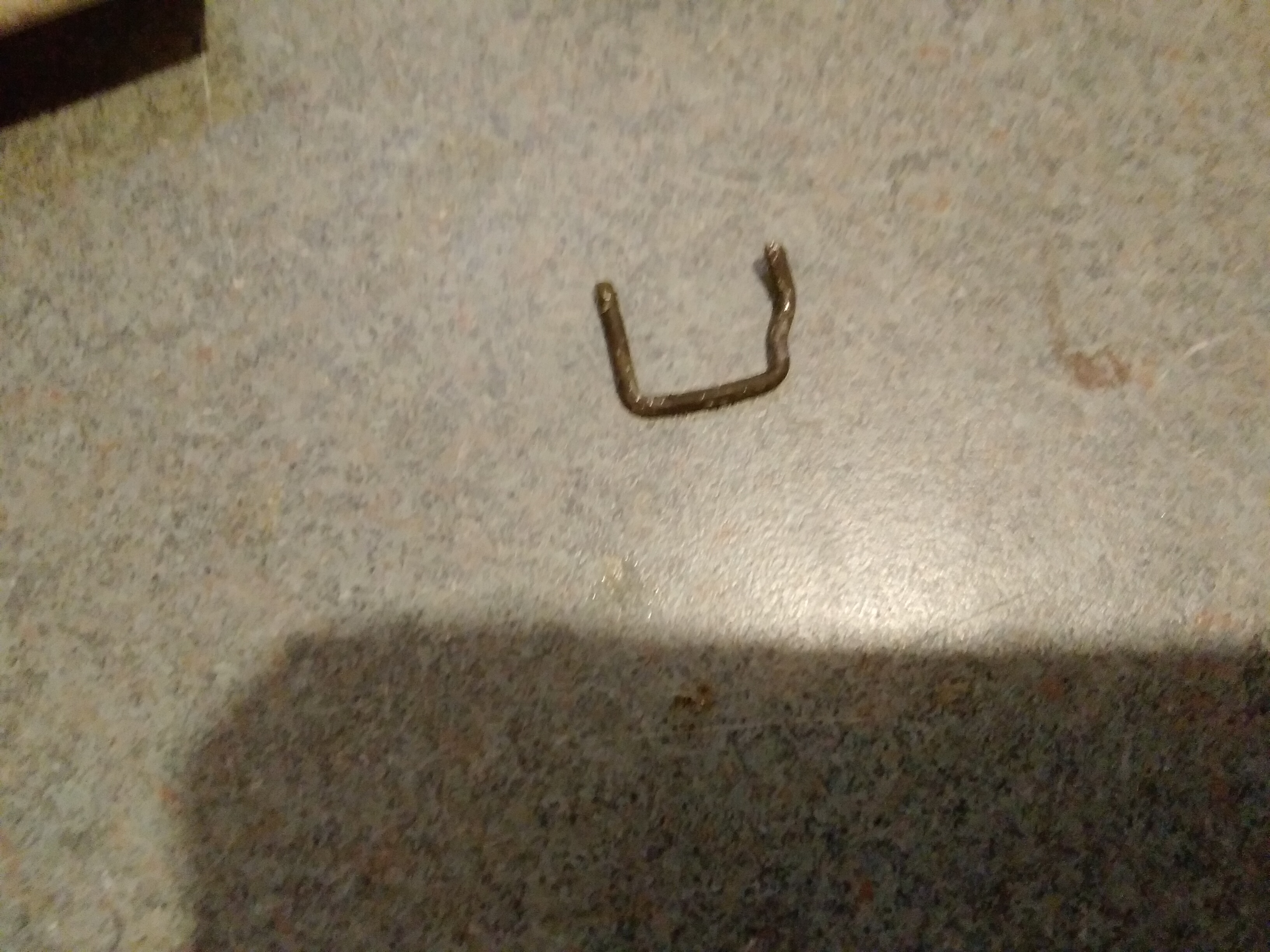

Extracting of the tone control proved to be somewhat onerous: the tone control is squeezed between the front panel and the closest electrolytic cap and its holder clamp. Without full removal of that holder clamp the tone control could not be tilted out of the hole for the shaft. The holder clamp is held in the middle by a thick steel wire.
This one.
Unbending it without any fulcum and wires around was not simple. But I prevailed.

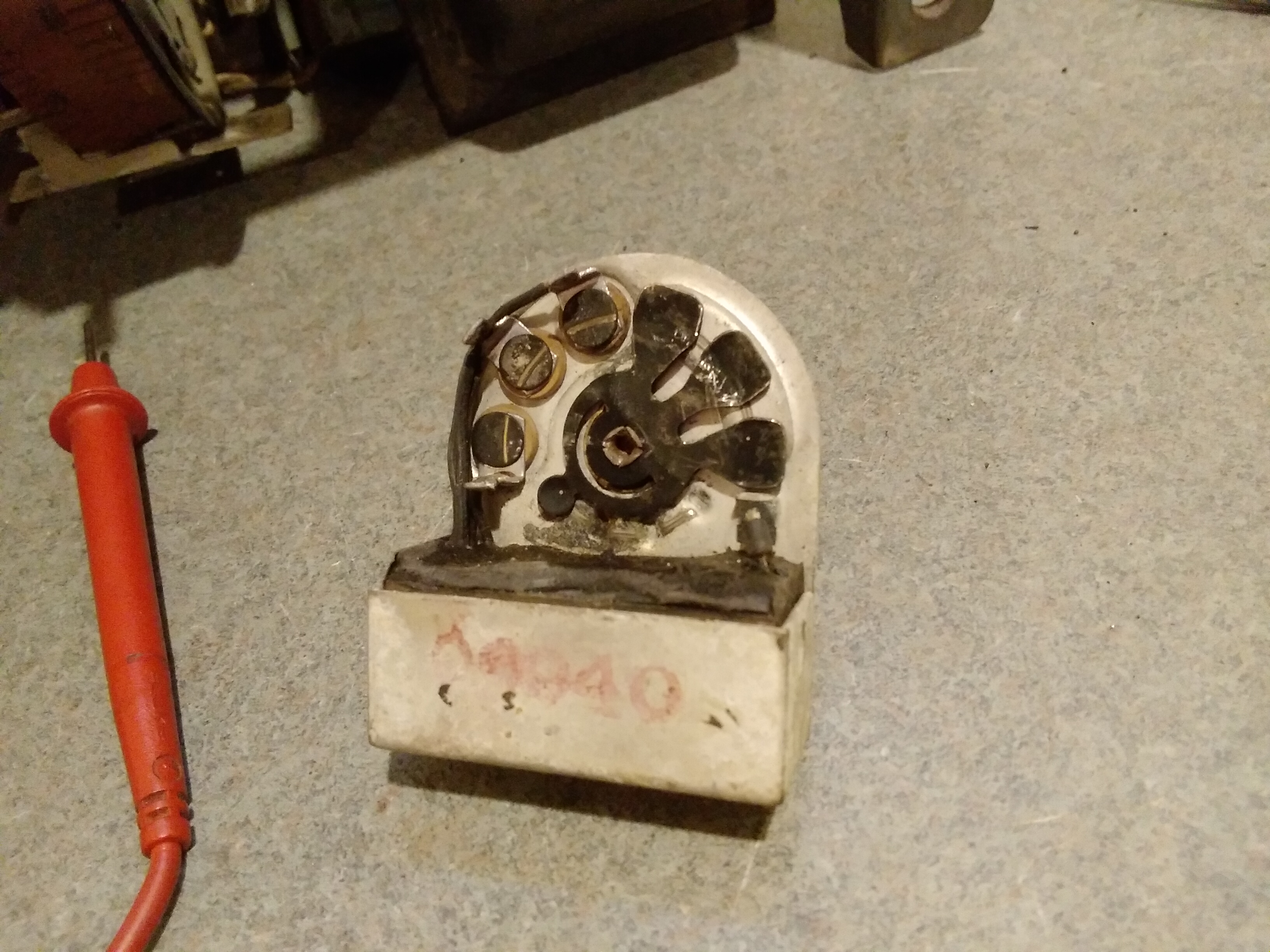

Now, about that tone control.
The stamped number could not be located in Ray Bintliff's book. Seems to end with 940.
Also it is 3-cap thing. From the "Evolution of 89" I did not see any 3-cap ones used, only 2-cap.
Any help with the info is appreciated.

Do the cathedrals also have the asbestos-coated shield or is it an LZ feature?

No - I don't recall any asbestos shield in the 19 cathedrals. Never saw anything like what your photo shows.

So, guys, before I resort to going outside this Phorum asking Philco questions:
Does anyone know what 06940 tone control hides inside?
Don't go to Ray's book: it does not have it.
Riders (I went through all 4 volumes containing 19/89 info) also has none.
Measuring with meter yields 29nF/27nF/17nF.
Considering ageing and nearly doubling the value, my guess is 15nF/15nF/10nF.

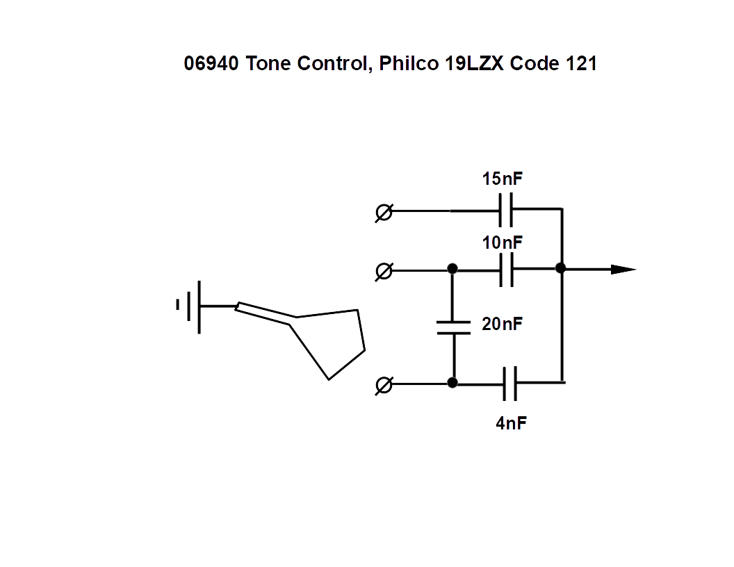

Ron’s evolution of the model 19 article shows the values:
https://philcoradio.com/library/index.ph...-model-19/

Ah I see now. Yes that is different from the tone controls I’ve seen on the 19B:
https://flic.kr/p/WMvrpx
I guess the chair side used a different part?

OK, I think I figured what is inside.
The values are cut in half as per rule of thumb, that the caps roughly double in capacitance over time from the 1930-s by now.
This is an equivalent of simply putting 13nF i/o 10nF and 10nF i/o 4nF with no 20nF in between them.
Which is what I was about to do, but I measured between the two caps and realized the capacitance is more than the serialized value, so I concocted this.
Not sure....probably would be easier to use 3 caps i/o 4.

Thanks for posting the graphic, Mike. I was not familiar with any different standard in 19LZX tone controls.

I think the cap between the two contacts, at least in theory, could be useful in the following manner: it lets the sliding contact engage patially charged caps. That is, if the cap is just hanging by itself, its voltage is equal 0, and when connected, it will charge from 0 to full value, whereas when partly charged (you can see how those are lesser values than the bridging cap, thereby charging to the larger portion of the voltage) they will maybe pull less current, create less spark and make less scratchy noise.
