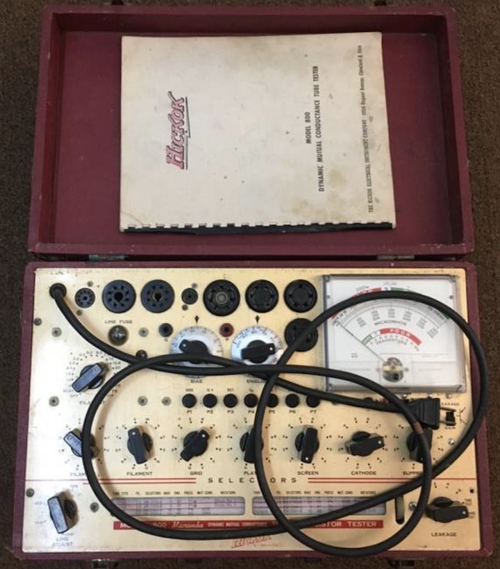

I found a Hickok 800 on Craigslist for $200. Seems like an okay price so unless someone advises otherwise, I'll go for it.
I have nothing against the people who use whatevef, dim tester included.
It is the tool I consider a weak addition to some other tools, but if so desired, may it serve you well.
$200 is a good price for 800 if claimed to be working.
If you really only have a $10 meter I'd consider upgrading. Higher quality meters tend to have longer and heavier test leads that make measuring a tad easier (and safer). I'm spoiled by Fluke meters from work, but you can get a pretty decent DVM for well under $100 these days.
And +1 on the $200 Hickok 800..... it probably won't last long if it is in decent shape.
Noted!  Thank you, morzh and Eliot Ness.  The Hickok seller now tells me he doesn't know if it works because he "hasn't had a chance to use it."  I myself wouldn't know how to test it on site because I've never used a tube tester before.
What do you think about me offering him less ($125?) and taking a gamble on it?  It appears to be in decent cosmetic shape.
If it were me, I would take a chance. But then I am an EE.
For you....it may be worth it as it looks nice and so the chance of it being bad is small.
But working does not mean calibrated.
As for calibrated, it diesn't have to be true calibration, sometimes buying a tube with parameters verified on a similar tester and making sure they are the same when measured on yours is enough.
This said, the meter will likely need to be open and cleaned.
I'd take a chance on it too. My only fear would be a bad meter because those can be hard to find, but they are pretty simple to use. Download a manual online, do a quick read and take a tube or two to test.
That is a good tube tester, very similar to the ever popular TV-7. The only drawback is the way you set the GM ranges which is inaccurate especially on the 15000 setting. If I wanted to use one of these for, say, selling on Pay-Bay, then I would set fixed value resistors on a 4 position switch like on the 533 and 534.
