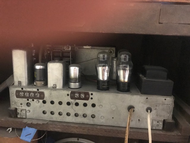

Hello friends, attached are some photos of the radio I have. It used to work decently. Several years back, it started to have a problem. They only way I can explain it is like a "an electrical storm" in the power tube. I of course have not plugged it in since and my uncle, (87 GE for 40 years) gave me a replacement checked power tube and checked all the other tubes. Between the two uncles, I have come to learn the following: The capacitors dry out and lose function. He cautioned me they have positive and negative poles so replacement must be mindful of that. Not sure why but he said "only use resin core solder when you rewire it" but he did.

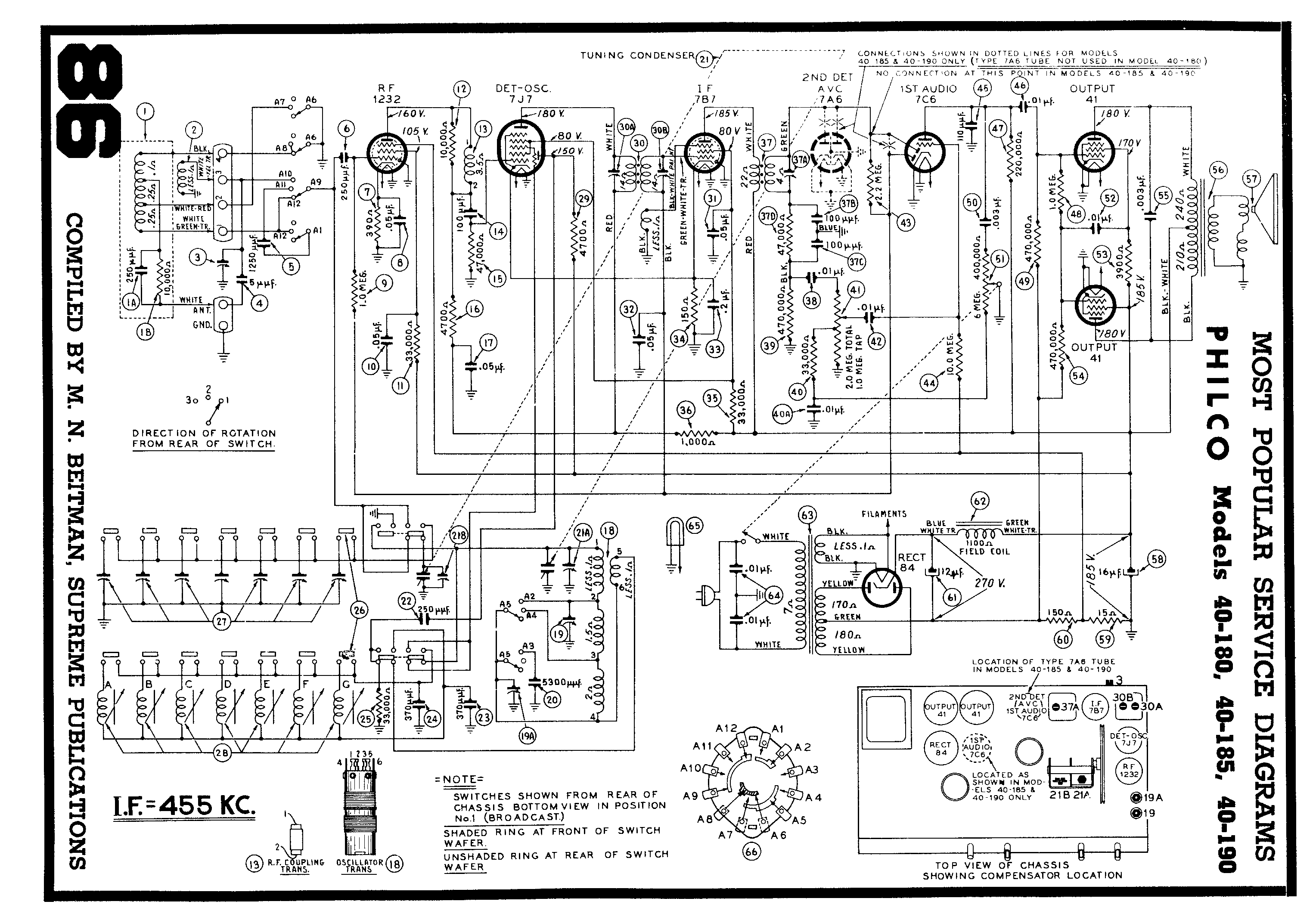

photo of radio with the resistors circled to be replaced, source and part numbers. I can provide the stock photos once I have it on my bench
Same for capacitors
Same for the caps? (sorry I don't know what those are just heard they need to go)
Any other tips, watch outs and whatever you do "don'ts".
My uncle said he was astounded to see the wheel tuning cord and system working perfectly with the original cord. Since I like the short wave and that requires tuning if you members think that has to go while it's apart I'll need to know that too.  So begins the Odyssey, I was told it's best to keep it all in one thread so this is it!
I look forward to all your replies and thank you so much in advance. Here's my radio:

Some info from Beitmans
Links for more info      http://www.nostalgiaair.org/Resources/336/M0013336.htm   Info about tubes https://frank.pocnet.net/sheets6.html
Thanks a lot, so eight right? I'm going to need a lot of study to find what you circled in the radio, I have no experience with schematics. I asked my field engineer if I could get some help, we are both retired. This guy used to tear into x-ray generators and more and he said " I don't think I'd be any good on that project". Great! That made me pause and think of how nice it looks as an antique piece! I'm not giving up that easy though. I'm going to go look at that link.

If someone could post where you get your parts and the capacitor order numbers for this radio that would be greatly appreciated. My cousin looked at the schematics last night and said it appears there are polarized and non polarized capacitors in this radio, does that sound right? Thanks to everyone for their immediate patience and encouragement.
Page 4 of NA link David provided contains the parts values.
