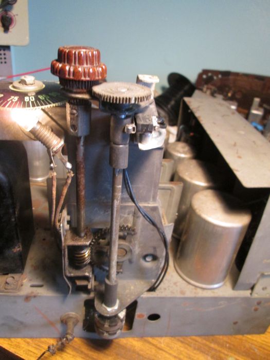

Chassis was dirty but unmolested, should be able to get it going in a day or so. Did the b blocks (only abt 6 of them) caps in tins, and soldered in a couple of new filter caps. This one has the silver screw in type which I don't have a large pipe cutter to rebuild them properly. Two or three resistors there were off. Tuning cap's supports were shot made some new one with a few grommets. To install the cap had to come off it got a quick clean and new wires. New AC cord and time to give it a whirl.

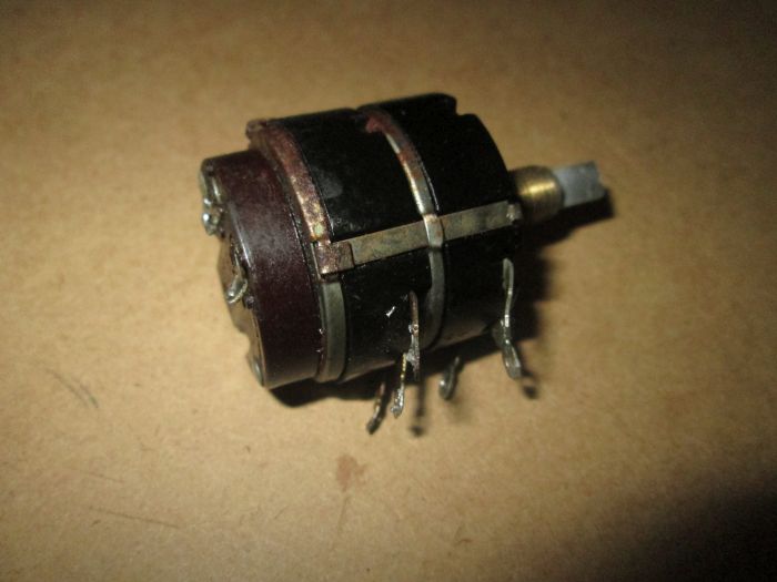

No smoke or fire but no signal either. Set the signal generator to 260kc and got a weak signal. turned up the volume control and found the issue. It was either barely any signal or full blast. Bad 250 ohm section in the dual section control. The 5000 ohm section was fine. The 370 uses this dual control which is identical to the other pre avc model 70s, model 20, and 21. But it has an off/on switch activated at fully clockwise.
Found a 500/5000ohm dual pot which which should be a good match. Installed it and added a micro switch to replace the off/on switch. Didn't want to use one of those in line jobs.

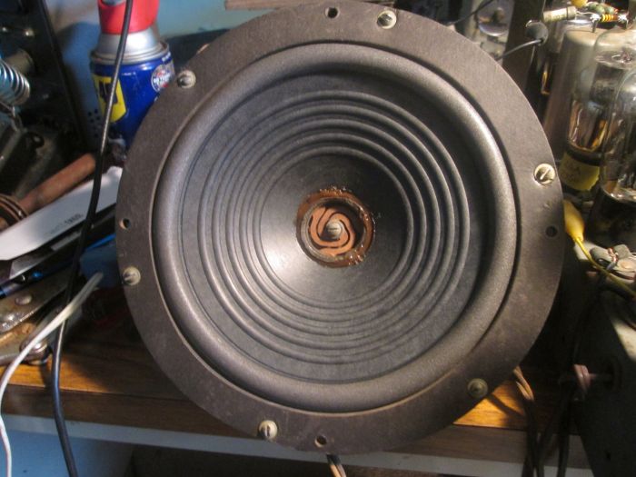

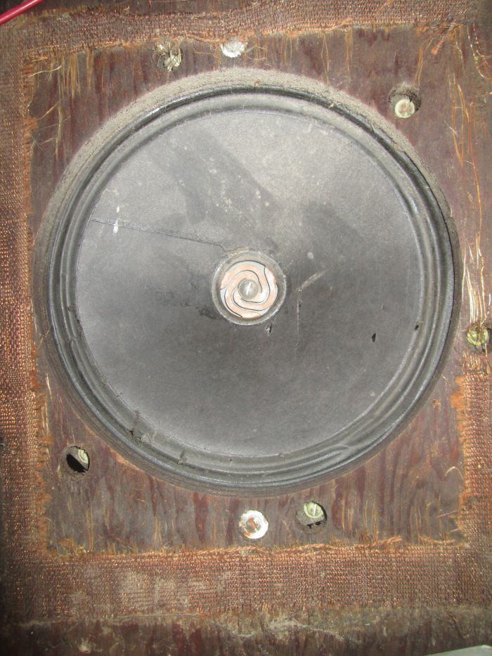

After I got the diode detector working I focused in on the speaker. The looks of the cone are deceiving. It was stiff as a piece of steel and had the fidelity of a bullhorn. Rich S is a good guy but I had some 8" foam edged cones and thought what the heck the worst thing that could happen Rich could repair. Got it apart to reveal several things. The pole gap was full of dirt and dust, the 8' replacement cone od was just about a perfect match, and doing the replacement was easier than I thought it would be.
Tried to shim the voice coil but couldn't get 3 in. Was able to tack the spider/vc in with hot glue in a couple of spots checking for rubbing. Went smooth as glass. Total investment .79c for the cone and about an hour service.
