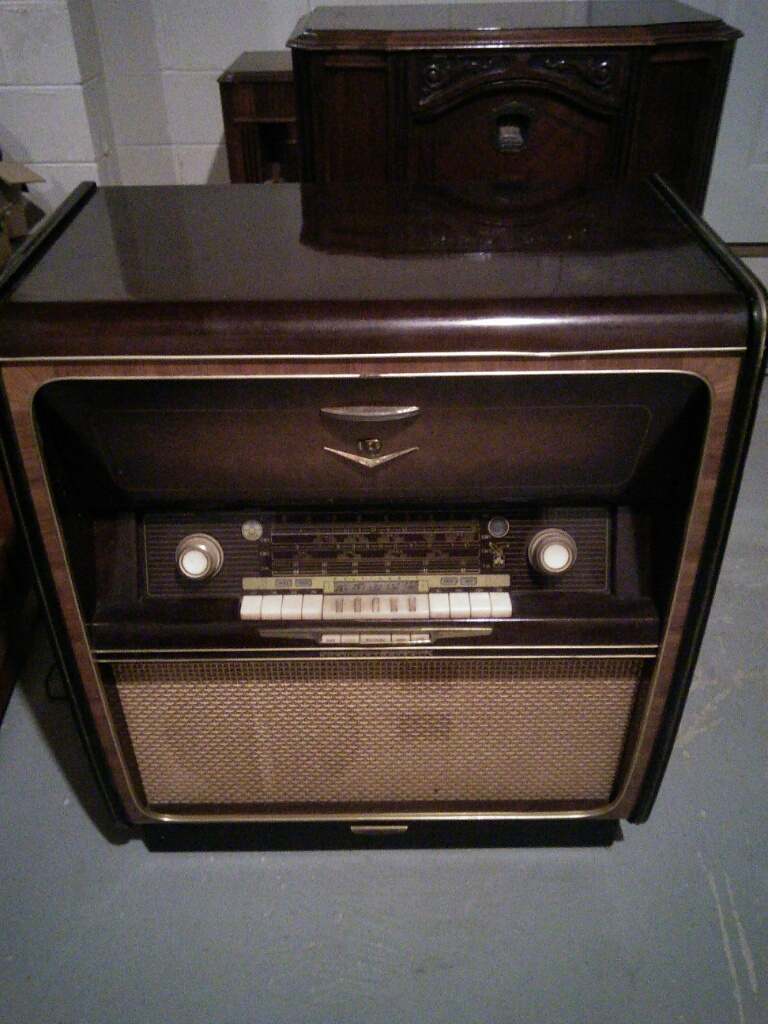

This was gifted upon me 2-1/2 years ago by the late wife of a late friend.
It is a 1950-s multi-band radio with a phonograph.
It hasn't been working for likely at least last 20 years. Maybe more.
Today it's number came up.

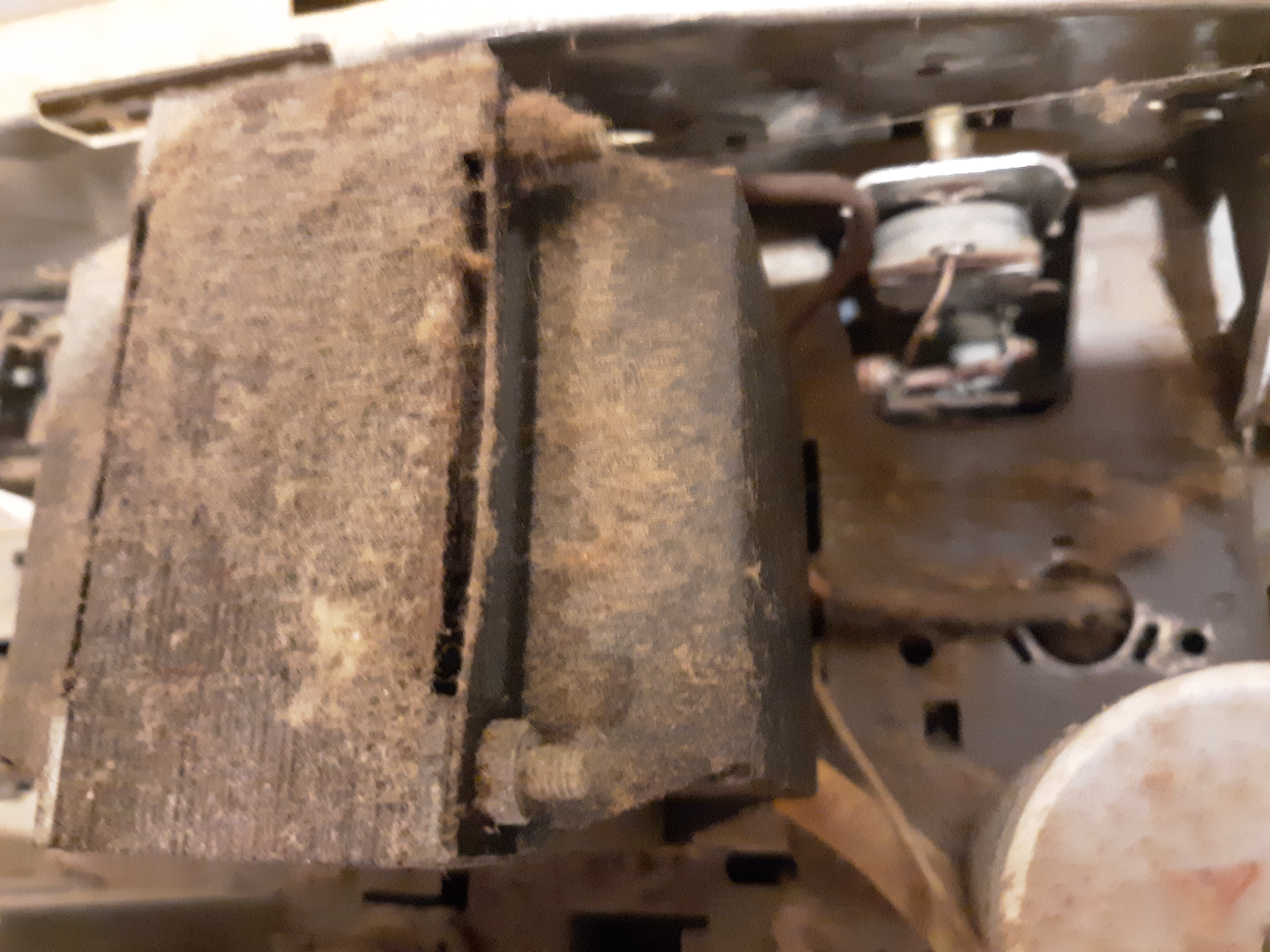

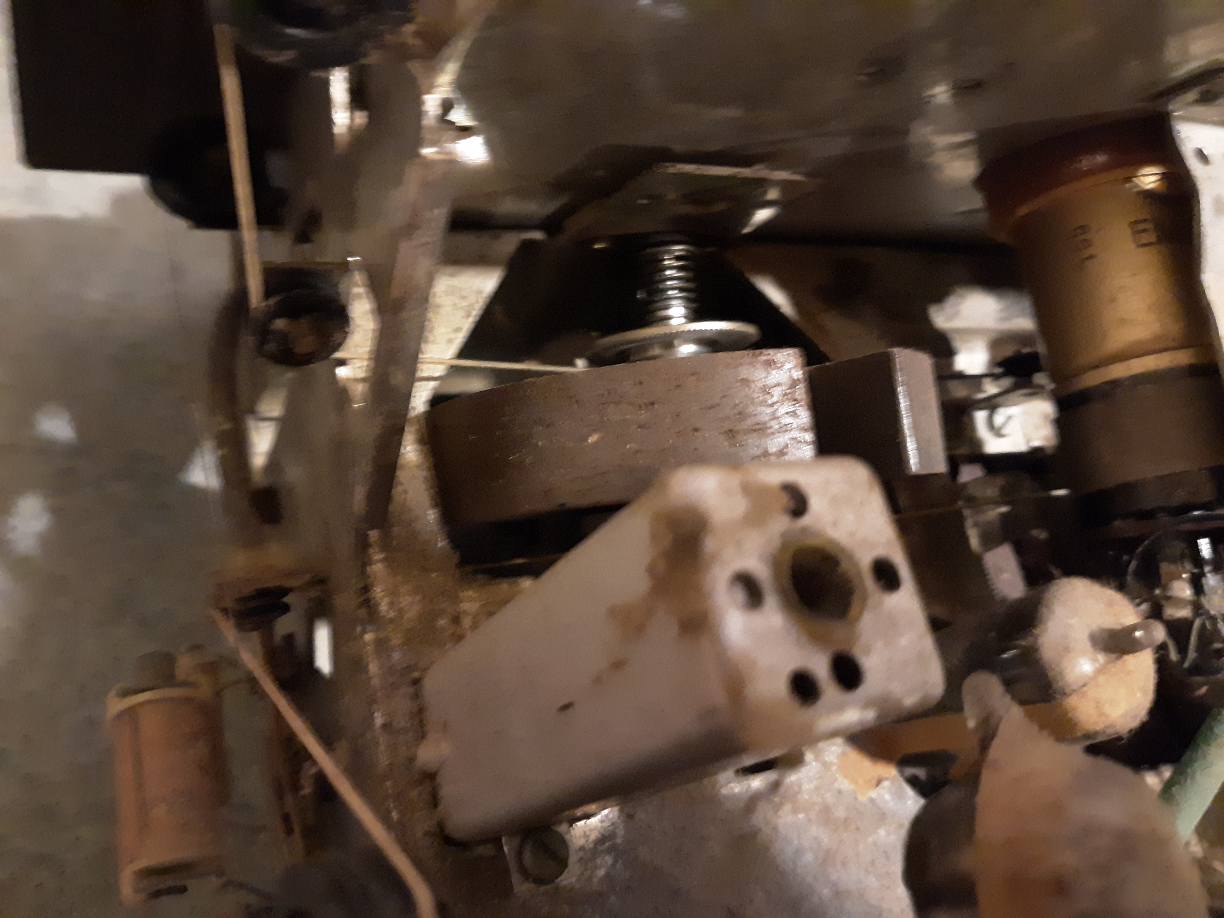

Very dirty and dusty inside. Nutshells....likely mice. Or some other rodents.
The speakers are good, the broadband one wrapped in cloth like it always is in German jobs.

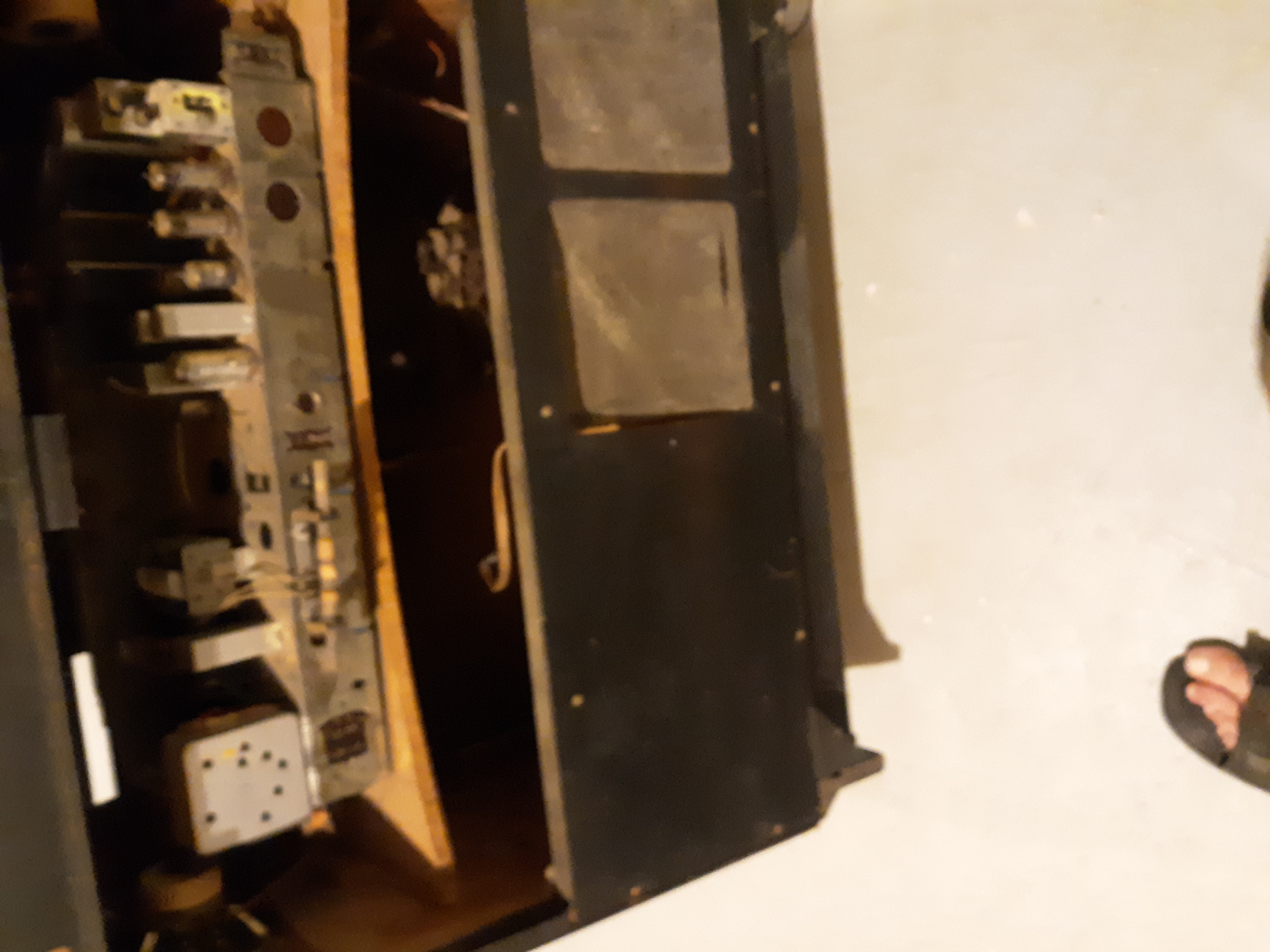

I took the chassis out after taking the turntable out.
It is pretty easy.

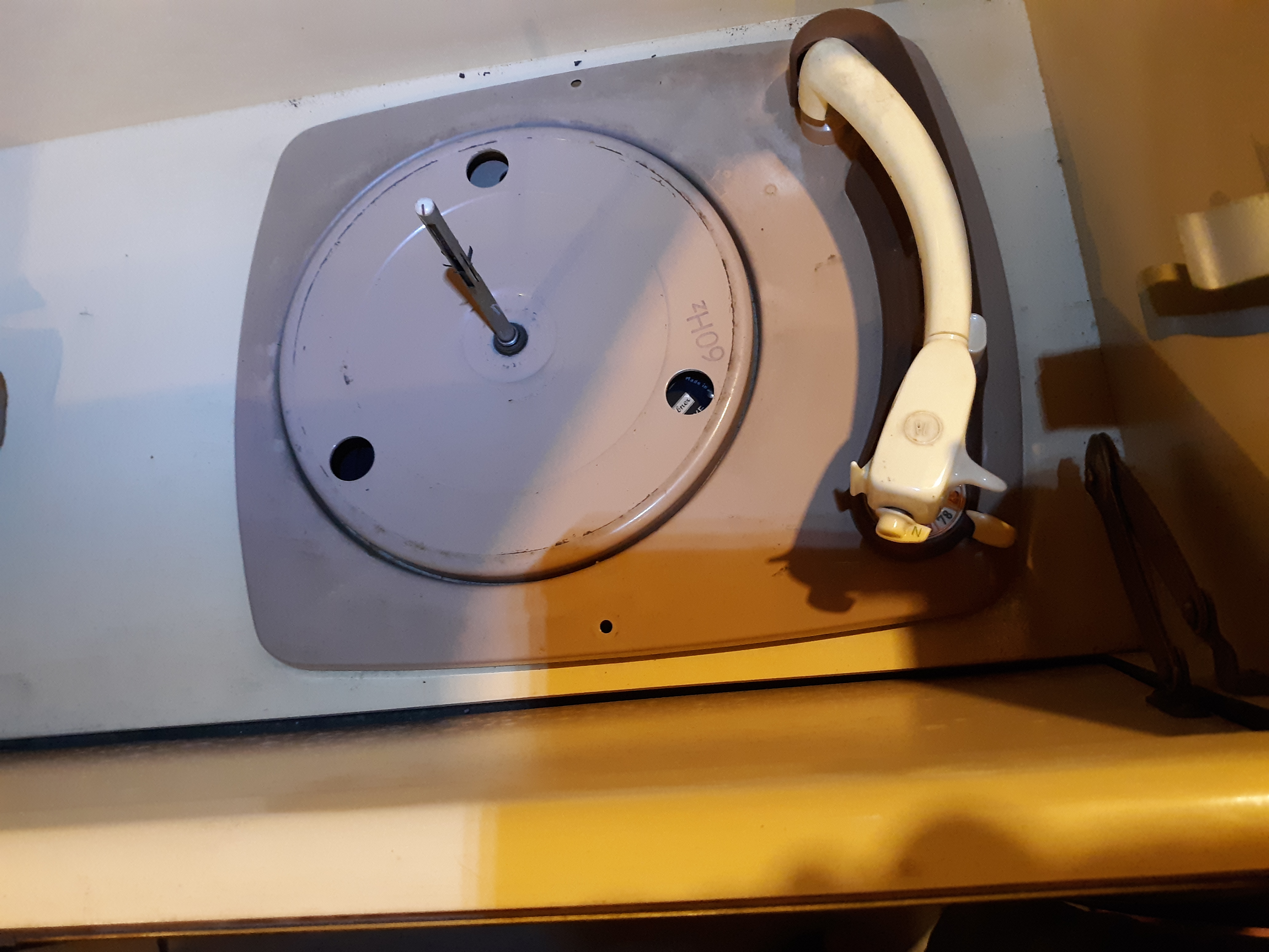

Here are some views:

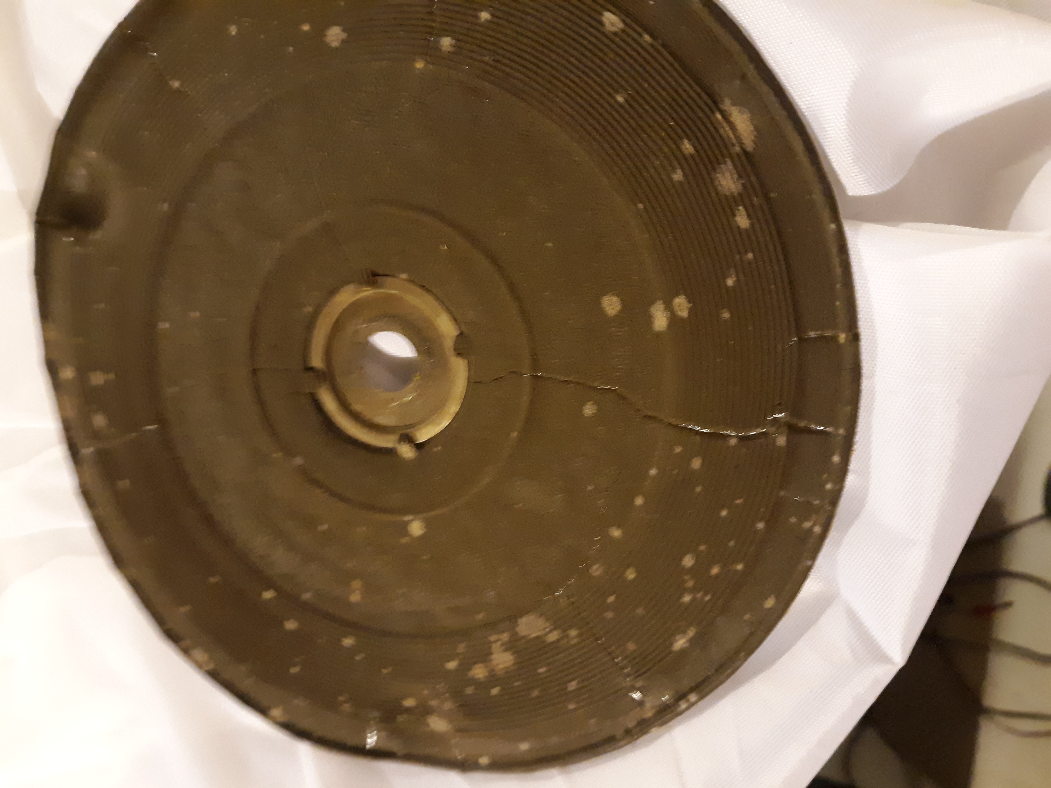

The mat is in the real bad shape, and feels like rock, all hardened up. Will need a new one.
I vacuumed the cabinet.
Now have to vac the chassis, clean it, test the tubes.
Here it is whole before having been taken apart.

Oh! And this is a wonderful Perpetuum Amber Rex! Very simple and very high-quality player with automatic record change. Its huge advantage over others is that you can simultaneously download records of different sizes in any sequence.

Yes. Where am I gonna get the new platter mat?

Michael, give the dimensions. You know what a Soviet clone must be.  I will pick up and send.

I do not know how reliable this is as the rubber mat is hardened and so might've shrunk. But it still is pretty close to that inner part of the platter that is limited by the outer raised part so I assume it is still the right diameter.
The diameter of the rubber mat is 190mm. (the metal platter diameter is 210mm).
(honestly I do not know what the Soviet Clone was.....one of the Festivals? Rigonda?)

Michael, you won't believe it, but most Soviet players have a mat 190 mm in diameter.
Found somewhere in the dozen, what color would suit you?
Sincerely Peter
З повагою Петро
(This post was last modified: 09-06-2020, 11:06 AM by RadioSvit.)
The original is what's on the photo. Dark....."серо-буро-малиновьiй"  (Russian way of calling a color that is God knows what - literally "greyish-brownish-raspberry"). Anything that is between dark-olive and beige will do. In fact...anything will do.
But it is not urgent as the turntable will need its own restoration plus the cartridge (possibly).
