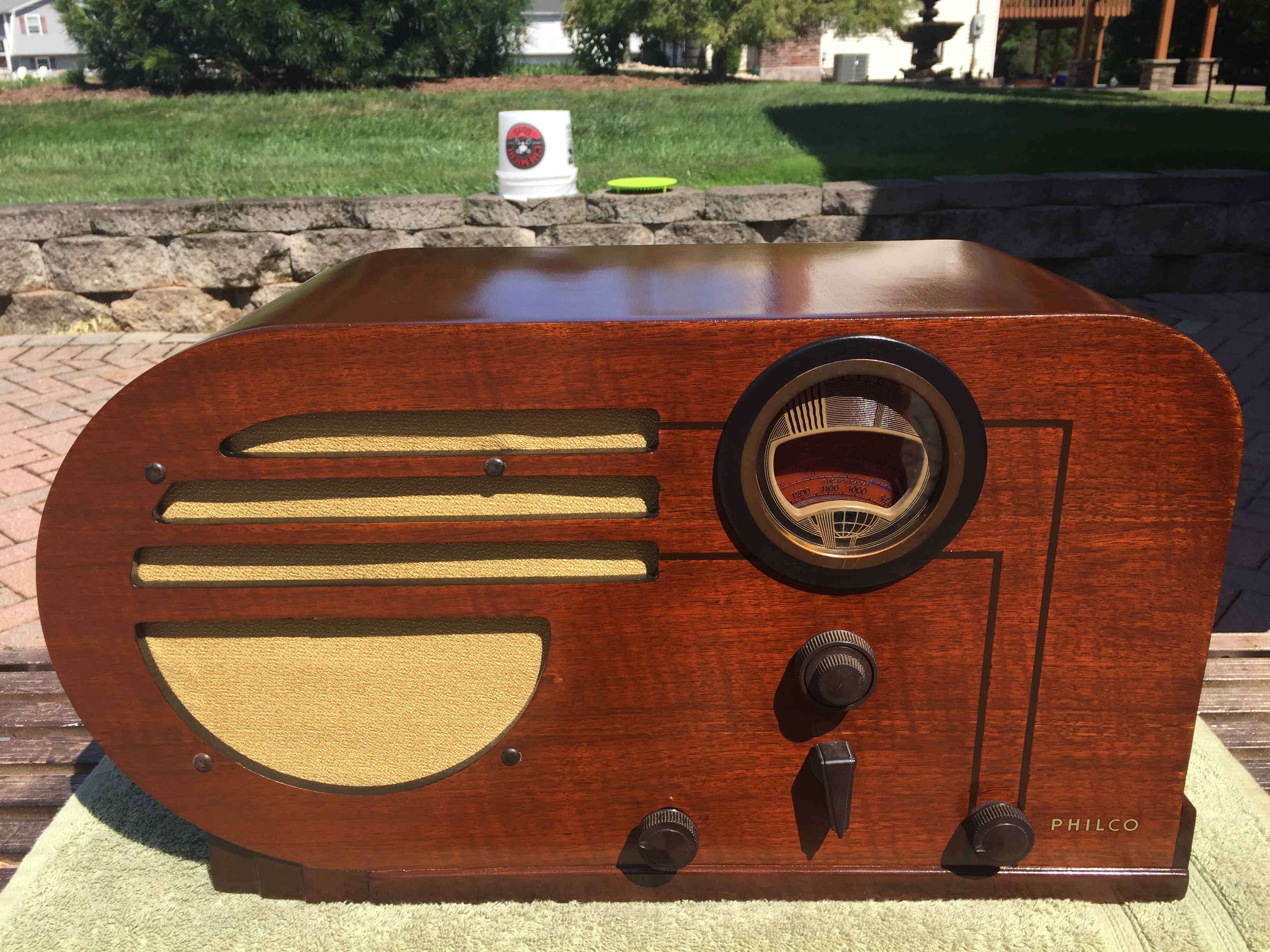

Nice!
One note: for a nice shiny cabinet you might want to clean the knobs: the grooves seem to harbor lots of dirt.
Posts: 348
Threads: 20
Joined: Nov 2016
City: Cromwell
State, Province, Country: CT
You aren't kidding about the knobs. You should have seen them before the toothbrush, soap & water. On to something a little stronger. Hate to think about whats stuck in those grooves after 80+ years.
Tony
Dipping it in Goop (GoJo) and brushing has some effect.
But, my best resu;lts were:
Take a needle or a sharp toothpick and simply push that schmutz out. Yes, groove by groove.
Then GoJo and then soapy water.
