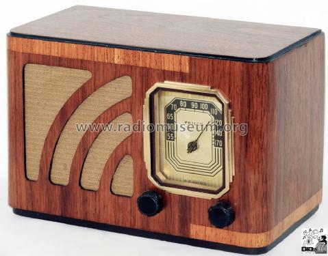

Greetings and hope all is well! I just purchased a Philco 38-12 whose cabinet looks like it was refinished in a high school shop class, and I am planning to strip off the old stain and finish, which might be varnish or lacquer (something else...who knows?). I am no stranger to this, and often use Citristrip for vintage rifle stocks. However...unlike old gun stocks, this cabinet is made of veneers and has a couple of nice inlays (see example photo below), which I don't want to damage. I've always liked Citristrip because it seems to be a bit gentler than other products, but I am afraid that it might cause the veneers and/or inlays to separate. I'm still a newbie to these nice old radios, so appreciate any advice or recommendations from the experts! Many thanks.

I'm not an expert on all Philco model finishes, BUT (there is always a but) the "inlay" may not be wood but a FAUX finish that will disappear when stripper is applied. Someone on the forum may know better about this model...
FWIK, using a magnifier, the grain will have an appearance of a newspaper image, tiny, tiny dots...
FAUX finish is a paper or decal film applique with an exotic wood grain design often pre-tinted and adhered over the base wood veneer...  chas

The 38-12 is NOT faux. Just did one.

Inlaid models did not use faux finish. In Philcos i usually was either / or.
38-12 is all inlay.

Since it looks like at least a couple of you have refinished the 38-12 specifically, I was just curious what products/processes you'd recommend for a complete refinish from bare wood.  Probably a pipe dream, but I'd like it to match the attached photo to the greatest possible extent.  Many thanks for the advice and recommendations!
