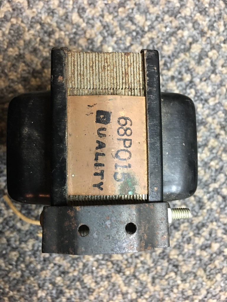

I found a power trans that might work, although not as heavy as I want. It's about the size of a large ac radio trans. It has some pretty heavy 6.3v leads, looks like a 750v HV, but the center tap is internally grounded. I took the cover off and verified this. Looks like I could clip the ground lead, solder a wire on and run it out. I did a quick bridge hookup with the HV to the AC in, - to the trans case and + to the meter (nothing else). But something must be wrong as it overloads the trans. It's a bridge unit that I have used in other apps, but was in a hurry and probably didn't hook up right. I may keep looking. Found a few on epay from organs that would have lots of power. I have a really cool trans from an old TV that has the rectifier tube socket right on top. Just got to find it tho. A schematic would be interesting, Chas. I could use a couple transformers with the filament on one and the HV on the other controlled with a heavy variable resistor or something.

IMHO that transformer is rather small for a plate transformer. But if that all you have.

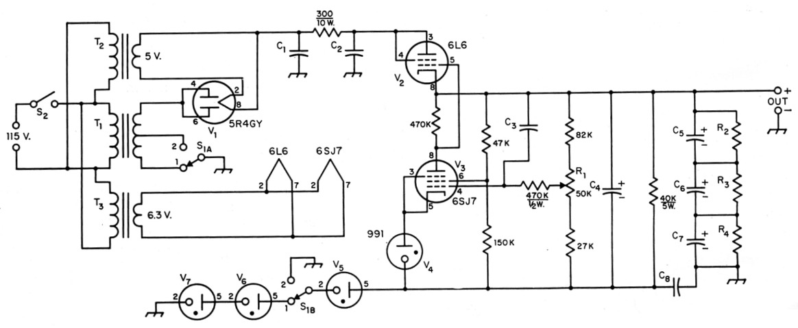

I found this on the other forum posted by "Rich". It looks like it has at lease some variability to it.
Tim

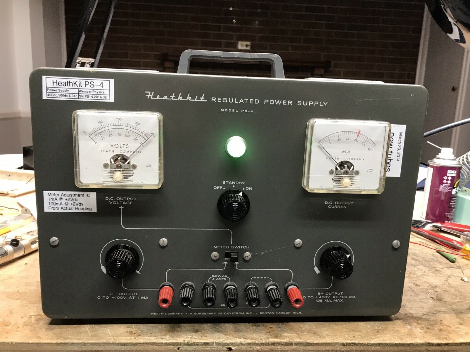

I did my test by stealing power from a Leslie amp using a variac. Upon a suggestion from a forum member on the other site, I found this on eBay for a reasonable - not cheap price, but saves me the hassles of putting something together. I may not be able to power a large TV, but it has enough juice to test about anything I need to. It was already recapped, so I don't even need to work on it.
Here's my solution:
Tim

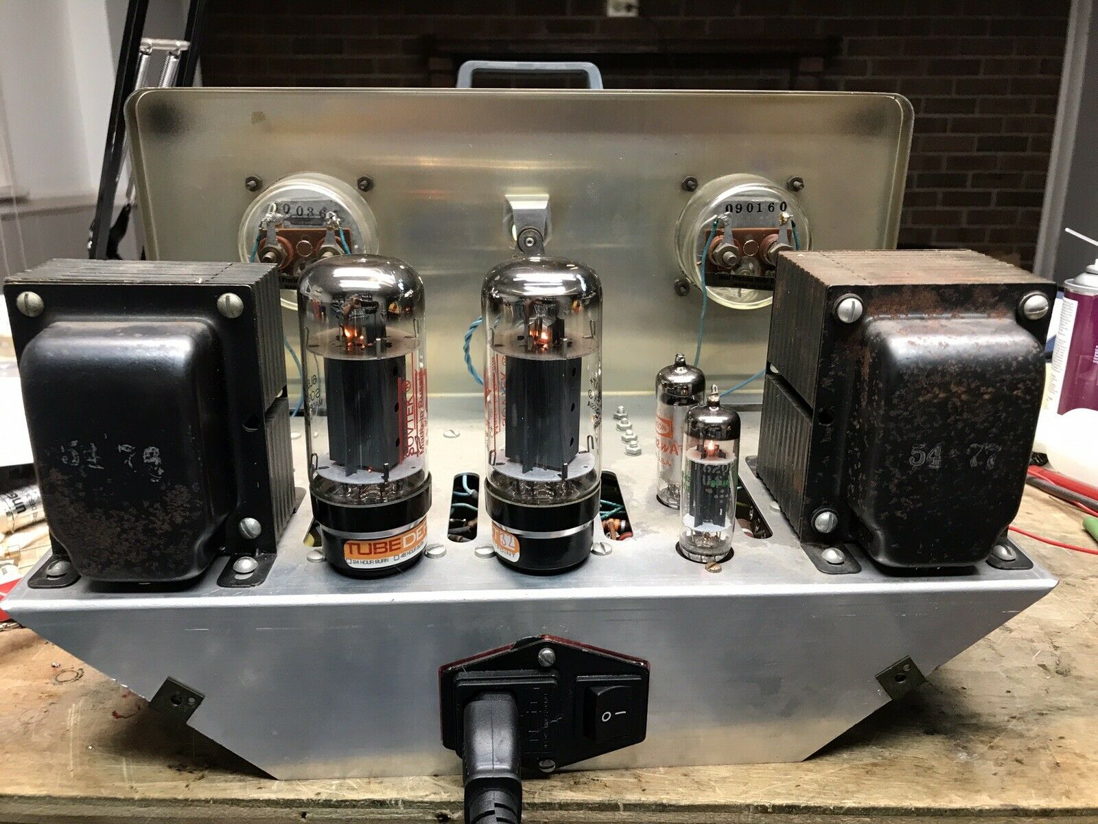

I would not go for a stepless-variable supply using a tube as the regulator. It is an LDO equivalent in the tube world and will dissipate a lot across the regulating tube. Meaning, your current sourcing ability is severely limited.
I would use a tapped transformer. Better yet, and isolated variac (truly stepless-variable). Then rectify and filter.
And then use a couple of smaller transformers for the filament volatges.

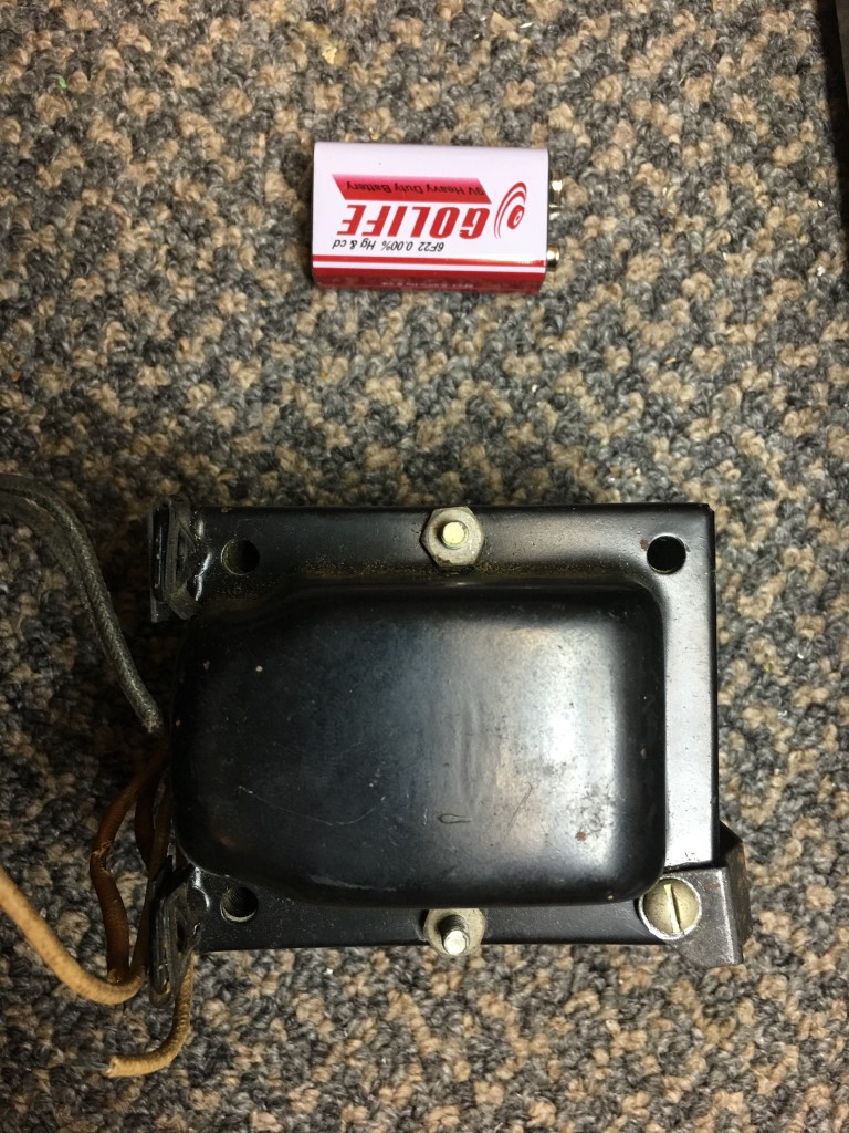

Thanks for the input guys. I found a big ole transformer from a mid 50's Admiral TV. Got lots of current, lots of voltage and a really cool rectifier tube socket right on top. I might save this one for an amp project tho. It's really neat looking. She was putting out 600v dc off the rectifier output with a filter cap clipped on. No load. I could use a separate trans for tube filaments and run direct, with the B+ run off a small variac. Be heavy tho. Probably be a built in part of my service bench. Future project...
Tim
Here's that bad boy
Tim
