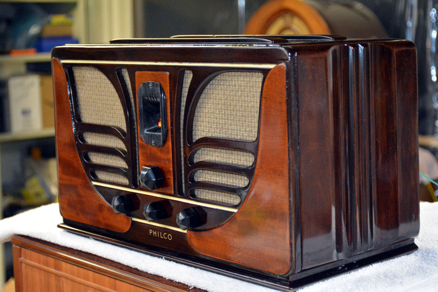

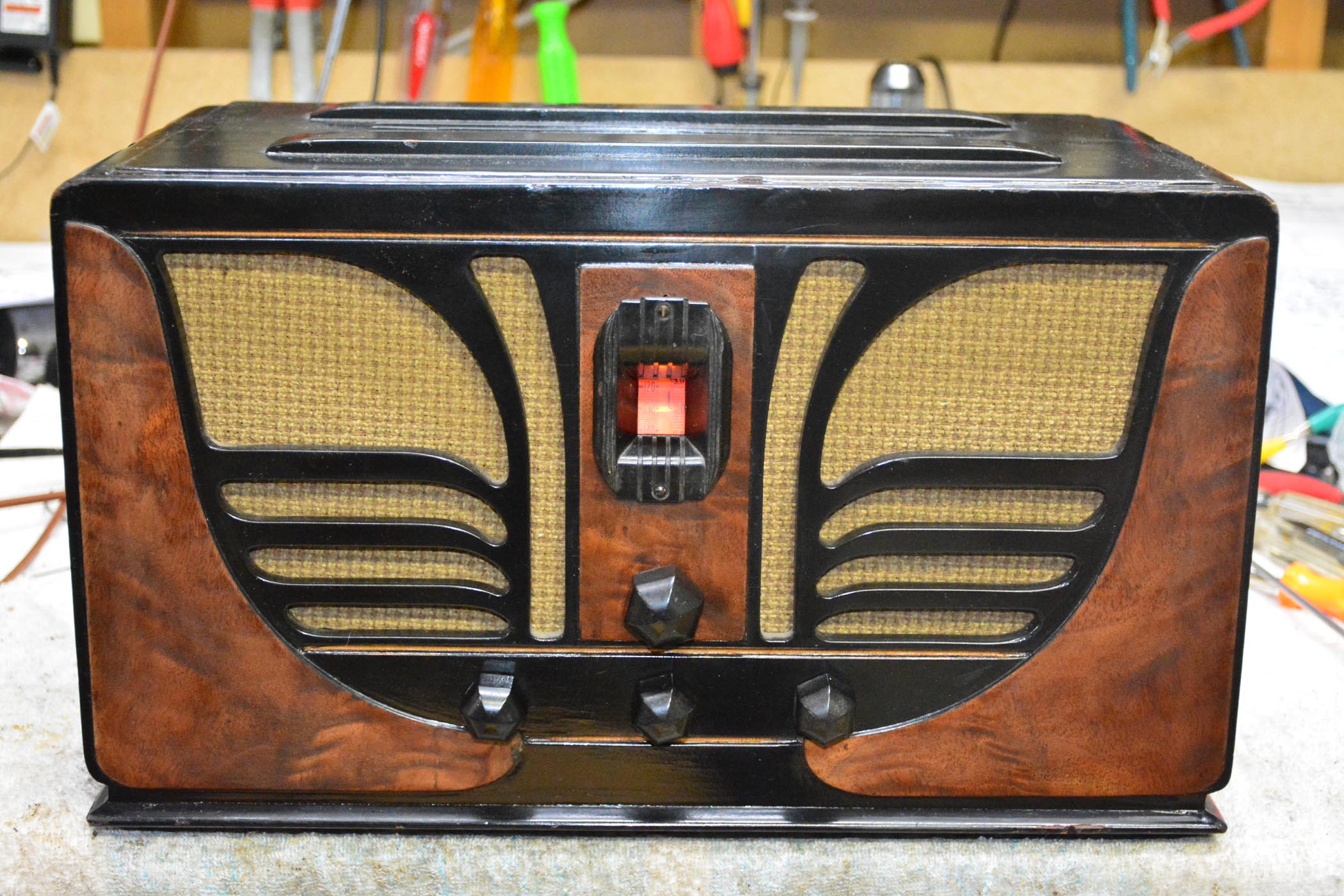

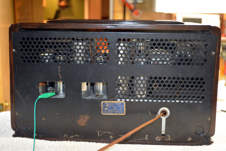

I decided to refinish my previously refinished in black Butterfly 45. The veneer on the front pieces is messed up and I want to replace it. Does anyone know what it is? it looks like burled walnut, but not sure. And, does that look like the original grille cloth?
Rob
It's not that obvious it's messed up.
Maybe up close.....but on the photo it looks fine.
It does resemble walnut, but I think natural cherry would look as good.

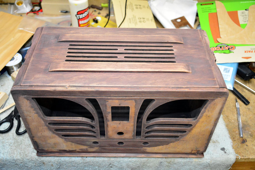

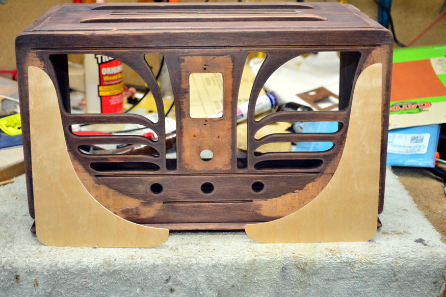

Yes, the photo looks better than the real thing. it has been sanded through in a couple of places and a piece was broken off and re-glued. And the panels are delaminating from the radio. So I'll have to do regluing anyway. With a little heat, I've already removed the panels since they were half off. I will try my hand at making new and veneering. I think it will be an interesting project. If it turns out lousy, I can always replace the original pieces. I have a piece of .8 mm ply that I used on my airplane. I'll use that as the backing for the veneer, use a shape following router to shape the pieces just like the original. I'll look at some cherry to see if I like it. The burled walnut I've looked at is a little too "figured".

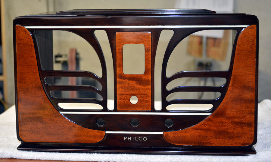

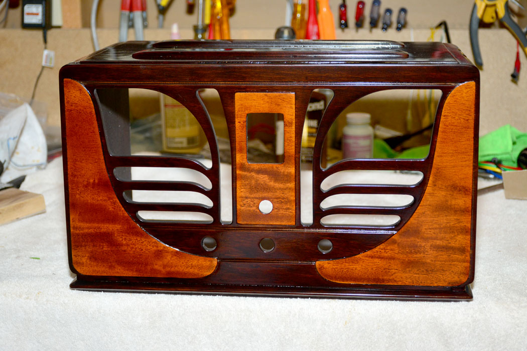

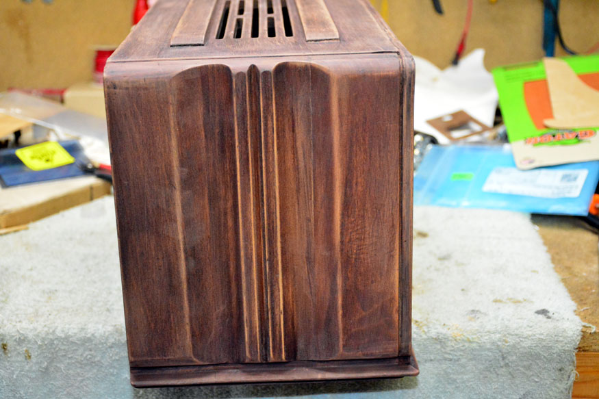

So, after stripping all of the black from the cabinet, replacing the decorative pieces, toning the cabinet with dark brown walnut toner and medium brown on the decorative pieces, here is the result so far. I had to use an air brush with the dark walnut toner to even out the finish before the final coats of toner. The cabinet turned out deep red-brown (red because the cabinet was quite red after the stripping process plus walnut brown toner tends to be a bit red). Medium brown walnut also turns out a bit red and the camera accentuates that, but on the whole it's ok. I hope it's not too far from original. I have to believe it is closer than the black paint that was on it previously!
(This post was last modified: 11-03-2020, 12:29 AM by rfeenstra.)
Posts: 1,222
Threads: 50
Joined: Oct 2017
City: Allendale, MI
Hmmm. Mixed up some white, yellow and black fingernail polish. It looked good in mixing container but after on the radio, it is way to white to suit me. More sanding, mixing and spraying!

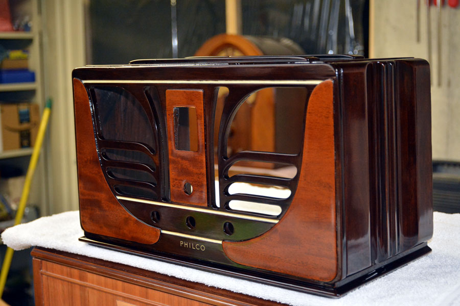

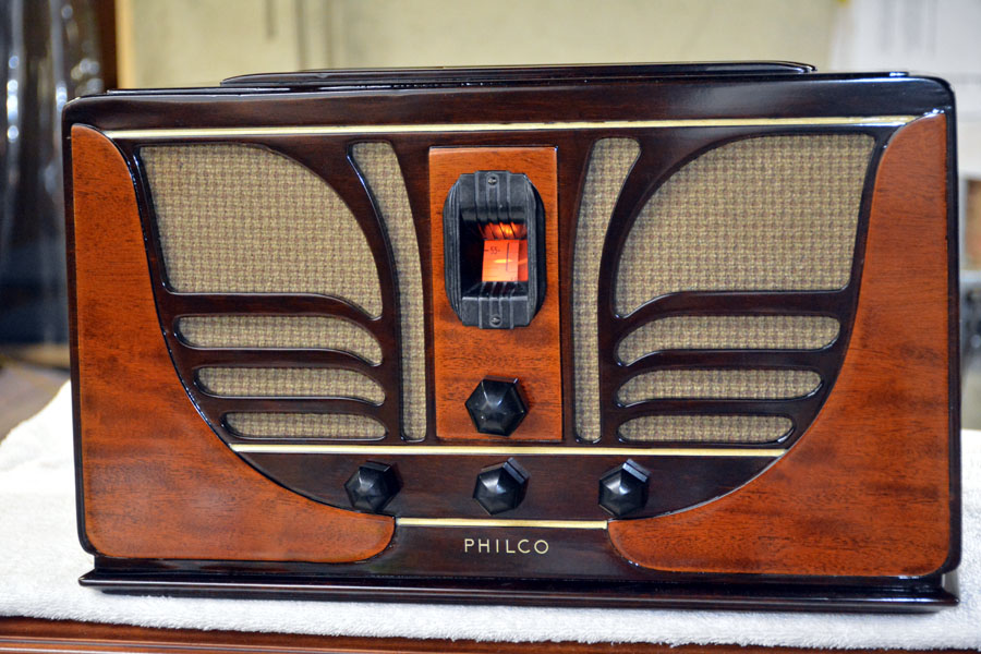

Thank you, Paul! I have redone the off white to a bit more yellow then "sprinkled" a bit of light walnut toner on it. Lacquer is drying now. I like it better but still may be a little too dominant. The original finish 45's I've seen on line have it more subdued. But, I can't keep putting lacquer on it! I think I'll live with it now. Pic will be coming.
Posts: 1,222
Threads: 50
Joined: Oct 2017
City: Allendale, MI

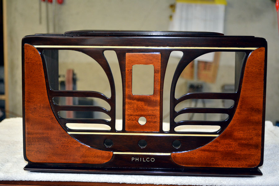

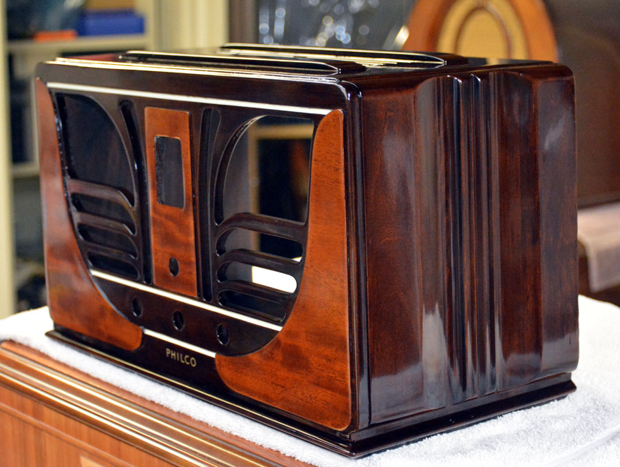

Lacquer has dried a bit. Here is the "toned down" trim color. This will be the final result.

That's a beauty! I have one with black paint and missing wire insulation caused by mice. I've been hesitant to start working on it; but, yours inspires me.
