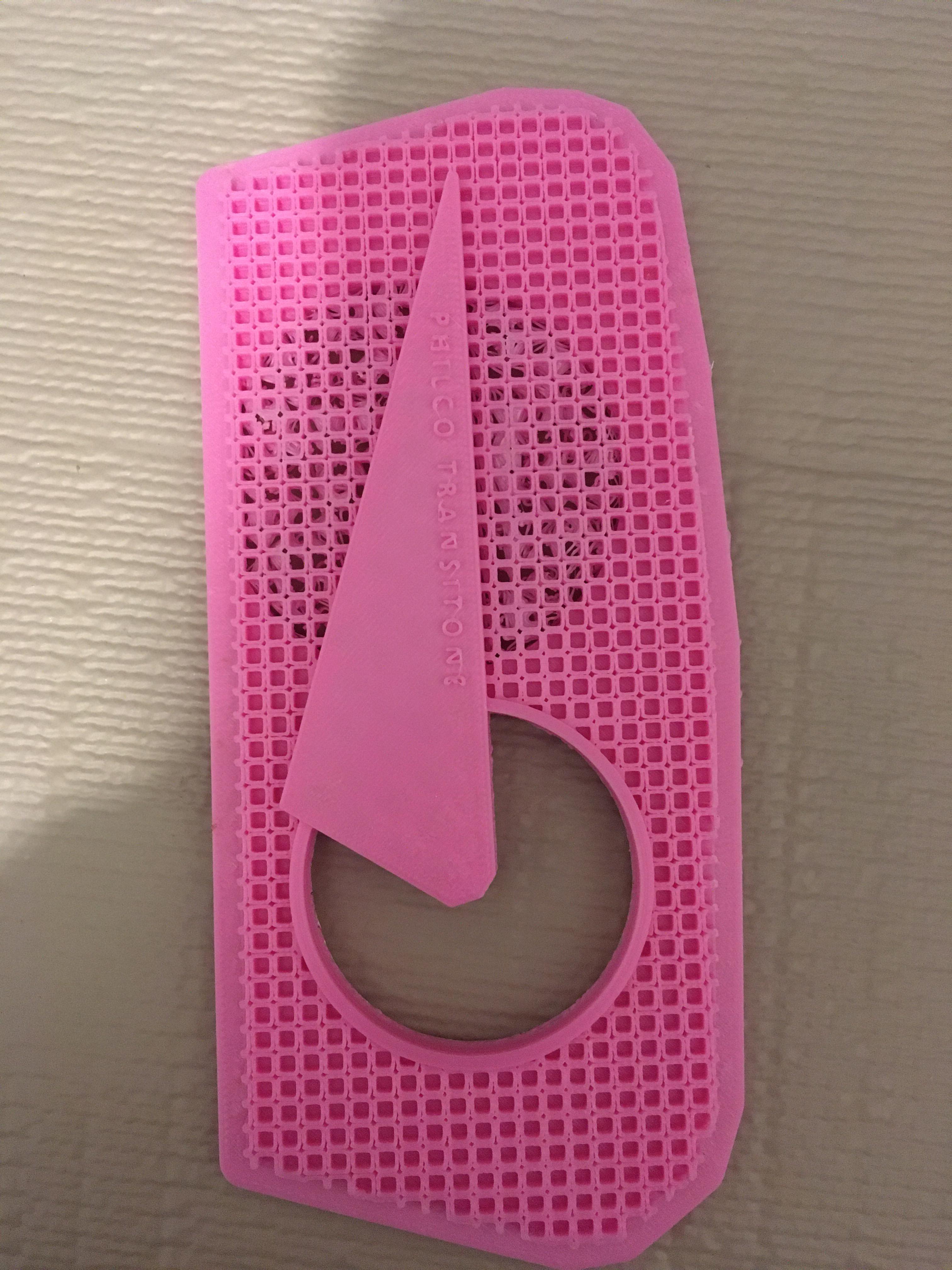

Hello Danial,
here is my scaled down print .
It is like 3inches high and 7 inches long
my Idea is to build a cool little bluetooth speaker .
Sincerely Rich
Looks nice, just a little clean up and just the raft out behind the speaker.
