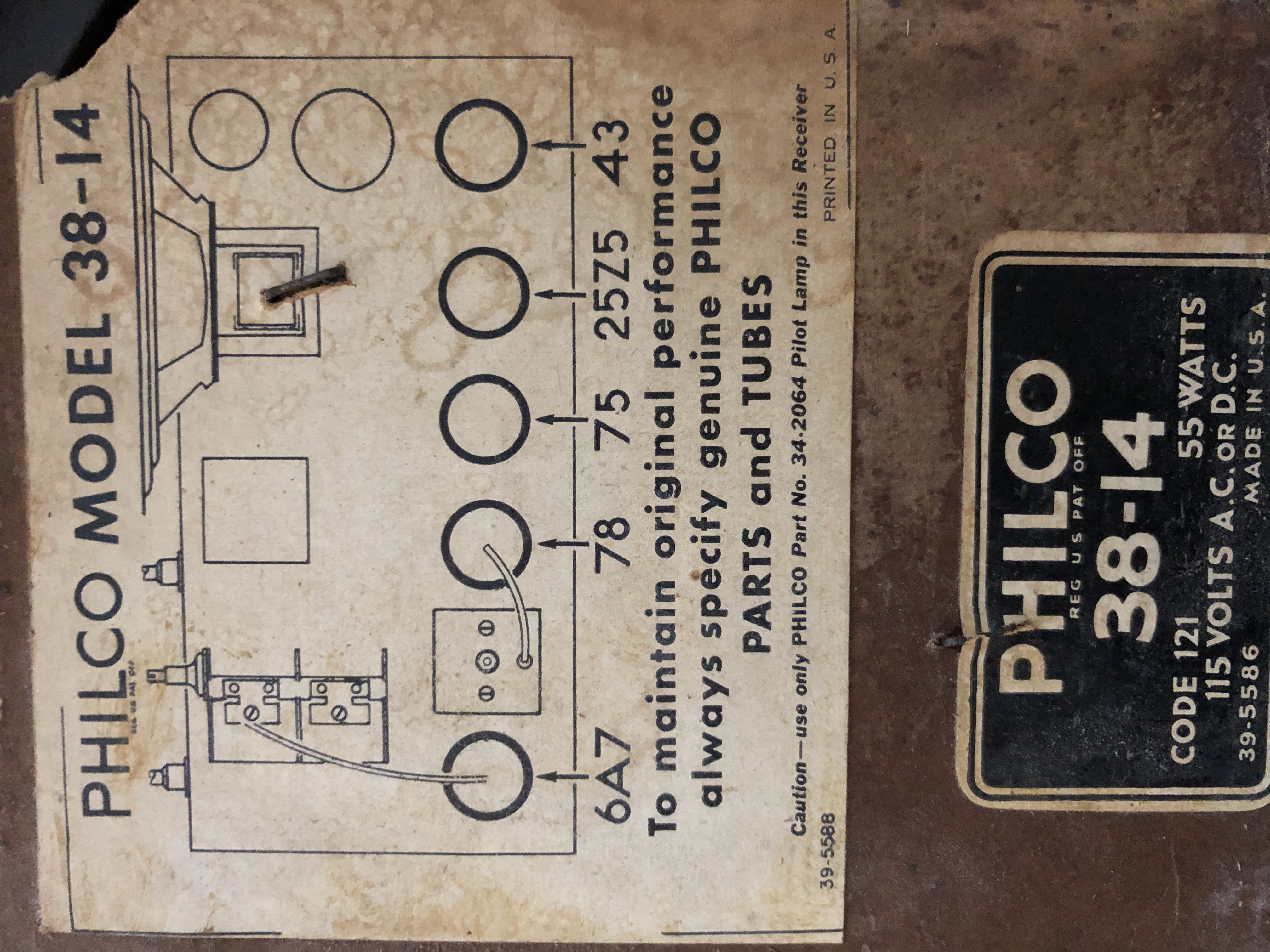

I am new to this forum.  I am remodeling a Philco 38-14 table top radio with improvements to eradicate the hum. Several tubes look decent but I do need to replace Types 6A7. 78 and 75. The other two 25Z5 and 43 (output) look fine. I've been online and cannot seem to find the Philco brand but since my 43 is an RCA, is it possible to use other brands? Perhaps someone has a chart that references other compatible tubes.

Any tube that says, say, 6A7 or 25Z5 or whatever is the same tube, Philco or not.

Some of the tubes were missing altogether. So 6A7 (tuner) and 78 ? with top connectors are easy enough but 75 is a misnomer. There might be new capacitors inside too so the extra overflow bulb might not be needed. I have the schematic and I will refurbish this with a new polarized plug so the chasis isn't a shock hazard. Fun project but I do need help from anyone who is willing to share tips.

As Mike said as long as they have the proper numbers your OK. You could do a very cursory test by using an ohm meter by measuring the resistance between the to fat pins on the base of each tube. What that will tell you is if the heater inside the tube is good. The heater is the part that glows when the set is on. If the heater is bad then the tube is likewise. So you should see several ohms between the two pins.

Thanks, Roslyn! I have found tube type 78 on Reverb but cannot locate type 75 yet. One site posted: Type 75 is the same as 6SQ7 and 6SQ7GT. So, I have a lot to learn about the sum of the tubes and the way certain tubes function.
I have 25Z5 and 43 and will test them today. Next issue are the capacitors that appear to be updated in the chassis and what exactly it means to the tubes or the plug which I absolutely must upgrade for safety.
6SQ7 and 75 are NOT the same.

Thanks! I did find original Philco type 78 and 75 bulbs today and purchased them!  Just need to find the tuner bulb 6A7 and then I can move onto the electrical schematic. This is a good winter project. Looking forward to exploring the stations that I can pick up. Reminds me of the old victrola that I used to own in New Orleans.
Thanks! Assuming my 43 and 25Z5 are functioning, I've got all of the tubes. Now to compare the schematic and work on the electrical. There are definitely some newer components and the old plug wiring needs to be updated. It is soldered directly to a screw on the chassis.

Just saw your enbedded comments, Rob. Not sure what the type 75 bulb does yet. It may go to the speaker. The "overflow" concept was one bulb in the string perhaps load balancing which means it can get pulled if you have different capacitors? Anyway, next step is to inventory my schematic and replace all the capacitors and resistors. I've not done a lot of soldering of axon capacitors but I have the tools and am willing to go slow to get this done right. My goal is to listen to some old music on New Year's Eve and then to get a ham license.

Hi Meghan.  here is a rundown of  what each tube does.  The 25Z5 is a rectifier that converts the 120 volt AC input to DC voltage that the circuits can use.  The 6A7 is a dual purpose tube that is both a radio frequency amplifier and the superhetrodyne oscillator  to convert the incoming radio frequency to the intermediate frequency (IF frequency) of 470 khz.  The 78 tube amplifies the IF signal to a useable value.  The 75 tube then extracts the audio from the IF signal using the diode part of the tube.  That signal is then amplified in the second part of the tube (a triode).  The audio signal from that amplifier is fed to the 43 tube which amplifies the audio signal sufficiently to power the speaker through the output transformer.
Since all 5 tubes as well as the resistor marked 36 in the schematic are in series,  all must be in place.  If you pull any one tube, or one is burned out, the entire radio will be dead since none of the tubes will then light.  There is no "overflow concept" involved.
