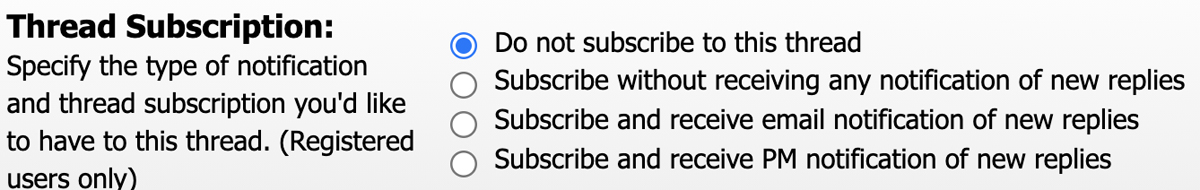

Curious Mike,
To get notification that someone has replied to your post, you need to select one of the two subscribe and receive options at the bottom left of the posting page.
Good luck with your project,
Larry
