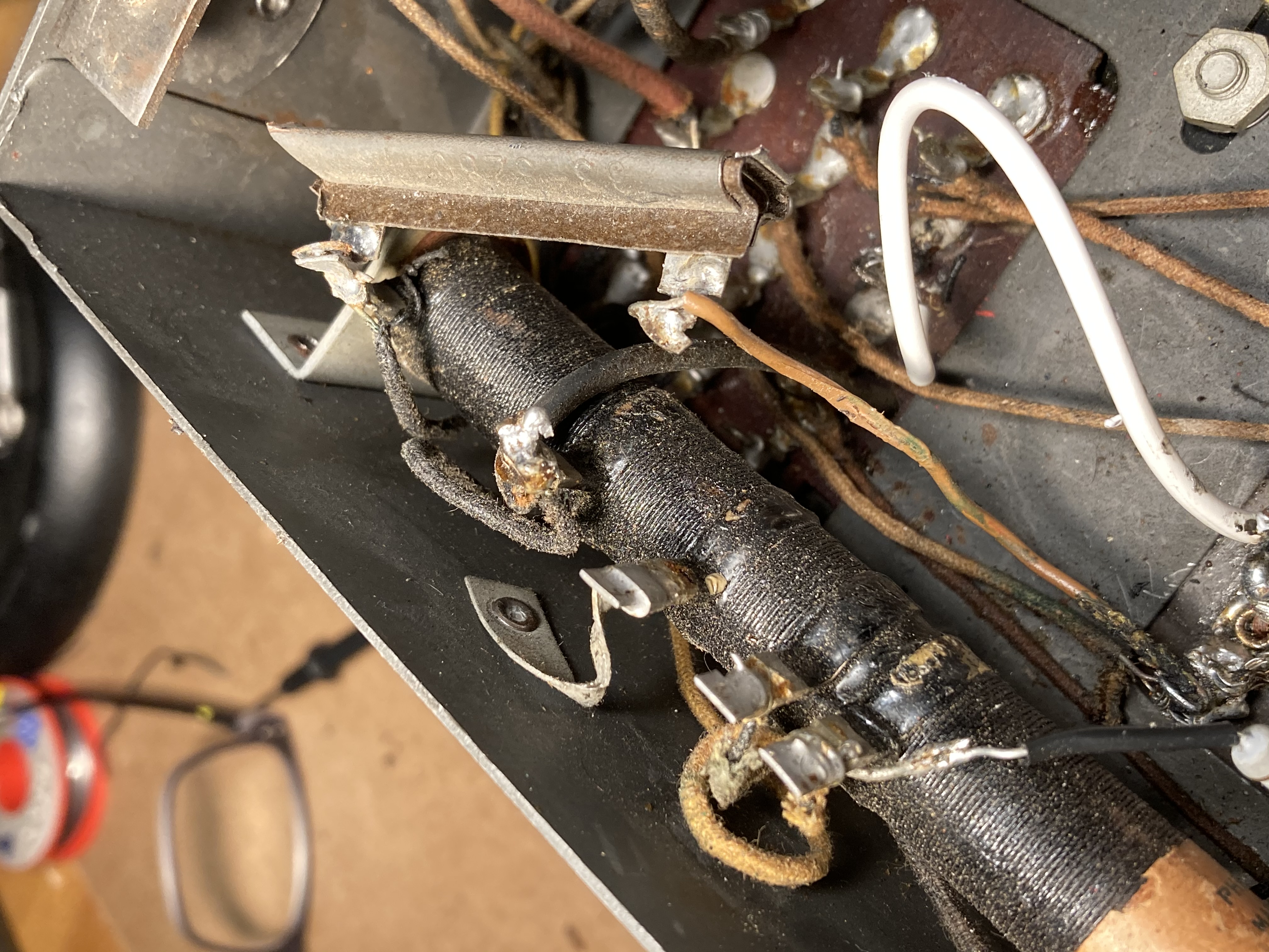

This is my first post to this site and I am hoping someone can help me finish my Philco 20 restoration project. I have repacked all the Bakelite blocks, replaced all the resisters, repacked the filter can, fabricated a dial lamp bracket, refinished the cabinet and replaced wiring as needed. The only thing left is this one resister.
My problem is the resister (see photo - grey ) that attaches to terminal 1 of part 25 and terminal 1 of the filter can. Terminal 1 of 25 attaches to terminal 5 of part 24 (transformer).
The resistor has the number 33-3280-1 stamped on it. I have found 33-3280 info which calls for 128 ohms but no wattage. Since these early numbers can be random in nature I am not sure of the resistance or wattage. Since this was probably added later (or different model) it does not appear on any of my schematics. To be honest, my ability to decipher this info using Ohm's Law, is unreliable.
I would appreciate knowing the ohm and wattage for this resister.
Thank you,
Fred

This Candohm is not native to the radio.
The part (probably the dead section of the wirewound part) is 1,400 Ohm.
At 18mA per tube (total 36mA) the dissipated power is 1.8W.
You might want to use 5W and up resistor.

Measure the ohms from the base of where that gray resistor (that someone added) attaches and to the candohm post that goes to ground - scrape deep into the metal at that post and also the base where the gray resistor attaches. What does it say?

Guys, that was really helpful. I was wondering why I couldn't get a reading (obviously to all but me) that the posts were too corroded. The push-pull transformer had been replaced. It's an "official replacement part" so possibly, there was a problem with the set that affected the last section of the long resister, part 25 (as you suggested). I will check the ohms tomorrow and go with a suitable replacement resistor at 5 watts. Unless you guys have any additional suggestions, I'll leave it at a greatful thanks for your help. Fred

This very resistor burning out in 20 is a popular thing to happen - my first 20 lowboy had exactly the same (and the only one) section open.
And the output transformer primary open. I guess it goes hand in hand.
