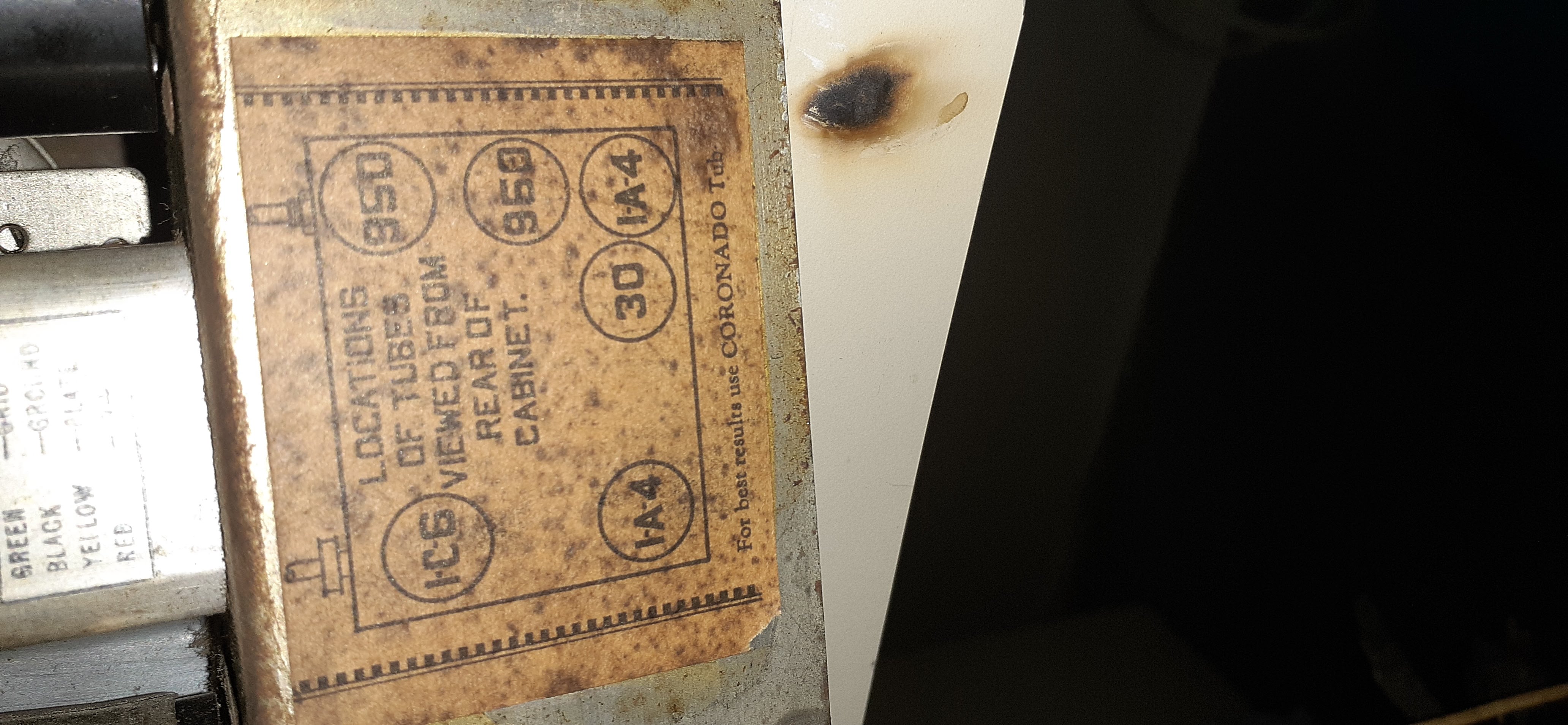

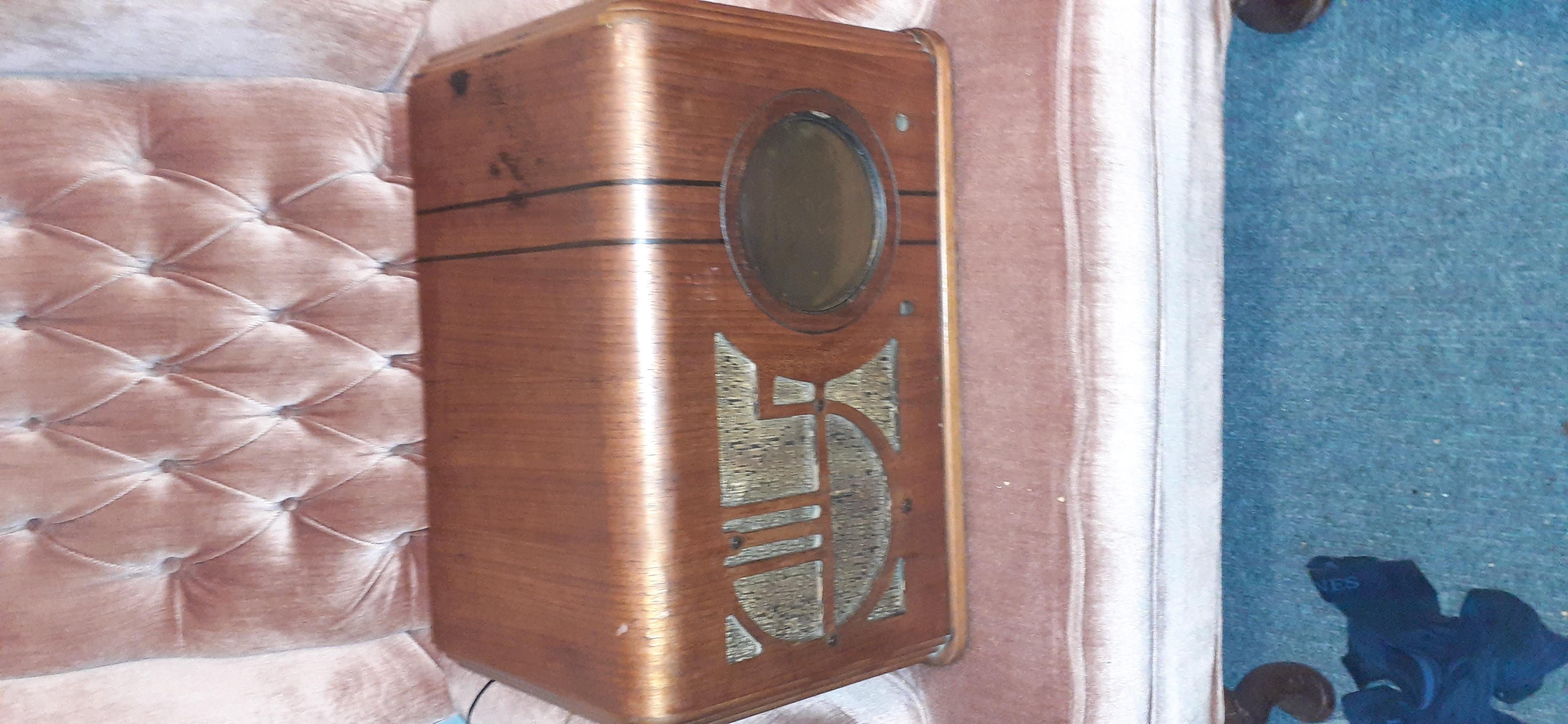

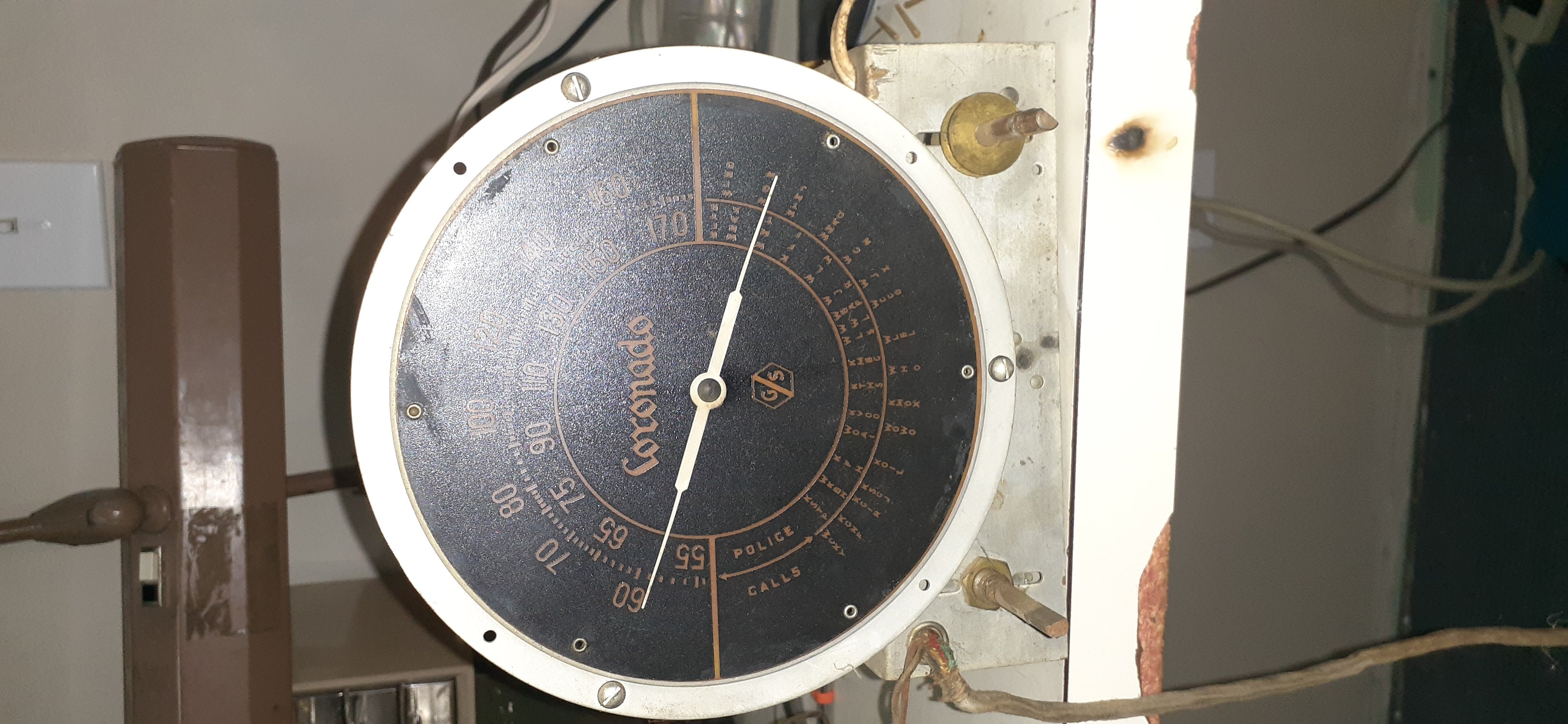

Hello everyone today I picked up locally a 1930s Coronado (Gamble-Skogmo) AM/Police farm radio that is almost mint in condition and still has all of its original Coronado branded tubes in it yet, and on top of that is electrically unmolested (except for the battery cables and the antenna wires which were jury-rigged), it also still has its original GOAT shield on the 1A4 tube in the radio (the only tube in the radio that was shielded).
This radio I think should be easy to get going again, the problem is I don't know the model number on it because the model number tag seems to be missing (but still has the original tube placement chart on the back of the radio chassis).
I know someone on here mentioned a website where you could type in the tube lineup and search for a radio model (and service info) that way.
I have some pictures posted below for your information so that maybe someone on here might recognize it by the pictures.
I'm thinking it might be a rebadged Zenith possibly because there were some Zenith capacitors in the radio that look to be factory original, but not sure, and if it was a rebadged Zenith I'm not sure which model Zenith it would be.
Also this is my first farm radio I've ever worked on so I'm not sure what I would do battery wise to power this radio.
Thanks for your help!
-Levi

Hi Elliot, I just looked over at that site and it won't let me put in Coronado into the company name spot because it only allows 5 letters in the spot, and this is a 6 tube radio and it only has a provision for 4 tubes and a ballast tube (which this doesn't use a ballast tube).
any ideas?
EDIT: I figured it out, and I figured out that my set is a model 650, which is a battery set (Farm Radio). But I have no idea what voltages I need for powering the set.
I just entered the # of letters it allowed me and 4 of tubes.  it came back with something close, but not exact, a Gamble Skogmo, Inc. model 650 A-B-C .  You might have to wade through a bunch of Rider's to find your radio.
https://www.grillecloth.com/sylvania/tub...ubmit&db=5
http://www.nostalgiaair.org/pagesbymodel...007098.pdf
I found the model its a 650. B+ Voltage is 90 volts (so I could use 10 9 Volt batteries daisy-chained together) and the Filiment Voltage is about 2.5 volts or so so probably 2 D cells put together, and then a ground connection.

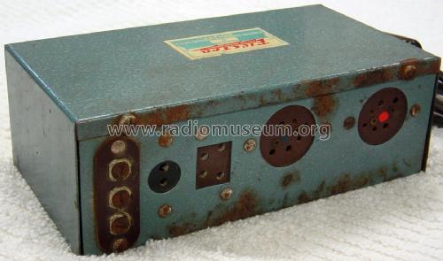

I was also kind of interested in looking into one of those already built battery eliminators that were sold at places like sears and montgomery wards back in the day to convert old farm radios into AC radios, kind of like the one that Radiotvphononut has on his bench for working on old battery sets (they had all of the different plugins for the various different style battery pack plugs for the different "A" and "B" battery packs that they made over the years), something like what's pictured below, but all I could find were benchtop DC power supplies.
Those have some really big - and now really ugly - caps inside of them. It is a simple circuit.
They have one for sale on ebay right now but they want $65 for it... Icon_eek
Too much.
But if you want to dedicate a supply to this radio only - better than a bunch of batteries.
