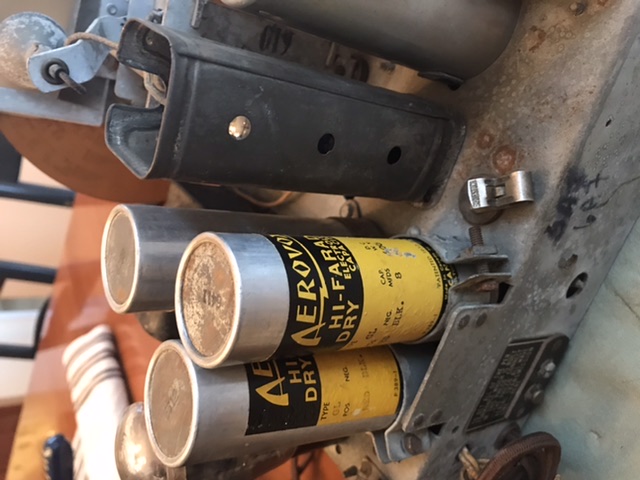

My Model 610 has three electrolytic caps but the one marked #41 unlike the #56 and #54 on the schematic is not grounded to chassis. I know from reading the Rider changes note, that these caps were mislabelled on the schematic and that’s not the issue. I know #41 is really #56.
I don’t know how to wire this insulated electrolytic cap properly.
Everything I read says to insure that you replace the fibre insulation ring on these aluminum caps when replacing but I will be cutting the red and black coming from this cap and reinstalling the new cap under the chassis. Where and how do I ground it?

Under the insulatingcardboard sleeve there is a metal insert touching the can, it is connected to the wire going to the transformer centertap (rectifier negative).
If installing caps under chassis, use the wire that was described above for the negatove and the wire that was going to the cacitor's center contact for the positive.
This is for the 56 cap as on the sch.
The other two have their cans grounded to the chassis.
Those capacitors are not original to the radio.  The original cans used the outside of the can as a contact either to ground or to the center tap on the transformer depending on which one you are wiring.  As Mike points out the insulating sleeve keeps the can (and metal tab that was on the side of the can used to connect a wire to) away from the chassis.  In your case, the new caps may have the negative lead as a wire rather than the can itself.

I though those Aerovoxes were the nut-held type with the central positive, no?
In them olden times they'd be better off using the screw type as then the central would act as a solder post; else the wire would have to be stretched to the centertap and it might not be long enough.

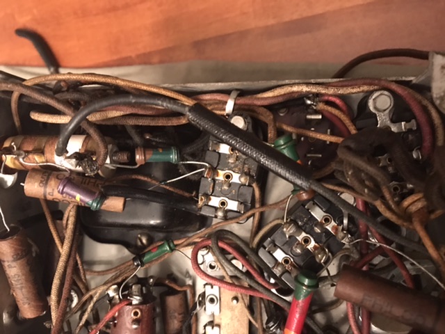

I can’t see any metal insert touching the can. There’s only the collar holding it in place and two wires from this cap. A red wire going to tube 80, not sure the pin# and a black wire that terminates at the B.C. Wire wound resistor part no. 33-3037. Photo of that wire enclosed. It is the black wire with a partial sleeve on it. If that goes to the transformer centertap I don’t know how to determine that. I am studying schematics but haven’t advanced enough to follow where everything goes.
I still am confused and would like to know where to connect the + and - of my cap and how to ground it.

What you've got is a red wire (+) and a black wire (-) existing the bottom of you caps. The there is no - connection made internally so there is no need for the insulating sleeves.
So to answer the pending question let's pull up the diagram.  https://philcoradio.com/library/download...l.%201.pdf  What we have is # 56 the - side goes to the ct of the high voltage winding and 57&58. + side of 56 goes to pin 1 or 4 of the #80 tube. Next #54 - side goes the chassis ground and + side goes to pin 3 of the # 42 tube and some other stuff that all connected to pin 3. Finally #41 goes to the junction of #'s 40&42. - side goes to chassis ground. Would use a pair of 10mf @450v for the 8's and a 22mf @ 450v for the 16.
