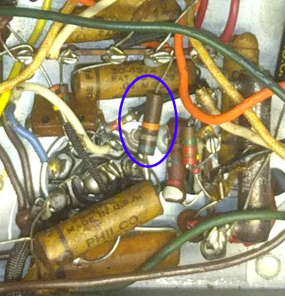

Hey Mars - I've attached a photo of the 2nd 47-1230 I did with C328 circled...this is after recapping (I restuffed them).  Check out my capacitor cross-reference which includes locations for all caps:  https://philcoradio.com/phorum/showthread.php?tid=19577

Hey Rich,
that is exactly where my mystery cap was.
How can it be C328 if it doesn't connect to R315? R315 is at the left soldered directly to the 6V6 socket
-Mars
I'm going partially on memory here, but also on some of my pictures and the schematic.  I believe it IS connected to R315 in a roundabout way.  R315 is connected to the 6V6, pins 4 and 6.  Pin 6 is unused on the tube so is just being used as a terminal for a wire into the IF can (Z302) as well as C317.  Pin 4 is actually B+ and is connected to many places.  If I remember right there is a wire running from what I've called TS7, terminal 5 (where the top end of C328 is connected) up to the filter cap, C102B.  From there I think there is a wire that works it's way down to 6V6-4.  You should be able to measure continuity from TS7-5 to 6V6-4.

See, that is where it gets fuzzy...
That terminal for this capacitor, also touches R304 and R307.
Now, on the schematics, I see that R304 touches C328, but not R307.
I see the same on the Sam's schematics. R307 and R315 aren't touching.
But, it would make sense that the one missing and the one extra cap of the same value are in fact the same...
-Mars
My documentation says that R307 (68k) should be connected from TS7-4 (not TS7-5, which is where C328 is connected) to 7R7-5.

I must say I didn't look up much the resistors, as I didn't change most of them; therefore, I relied on the parts placement drawings.
We know the parts placement drawing can very well be wrong, there's lots of errors in them...
Double checked in my radio, and for sure R307 doesn't touch the mystery cap, that I relabelled C328
Thanks a lot for helping out. This might also help out future people attempting similar restorations.
