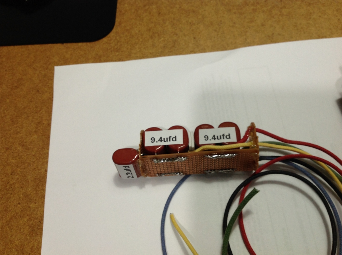

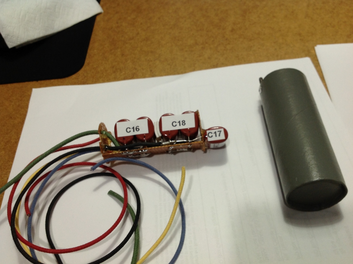

A reproduction filter capacitor for my Zenith model 908 .
First of all I used a wrapping paper roll for the cardboard filter can and painted it gray,
For the capacitors I choose metal film .
Here is a few photos showing the insides and as you can see I used my label maker to label the capacitors value and capacitor location . Hope you enjoy the photos
Sincerely rich

  I didn't realize that brand Z used cardboard tubing for filter caps in sets that early. How did you roll over the end of the tube?
hello mike,
I will post some more photos tonight after work .
Arran I thought the same thing but the original capacitor was cardboard .
This was a fun little project and I will go into detail about how I made it .
Sincerely Rich
Many of them had a cardboard sleeve over a metal can.

hello Phlogiston,
I have the original capacitor and it is all cardboard and it is a dry type not like the later ones.

The two value of Capacitors that I used are Panasonic brand and I bought them from mouser electronics .
Here they are Part Numbers
667- ECW-FA 2J225J Desc: 2.2 ufd at 630 volt DC 5%
667- ECW-FD2J475JQ Desc: 4.7 ufd at 630 volt DC 5%
Sincerely Rich
