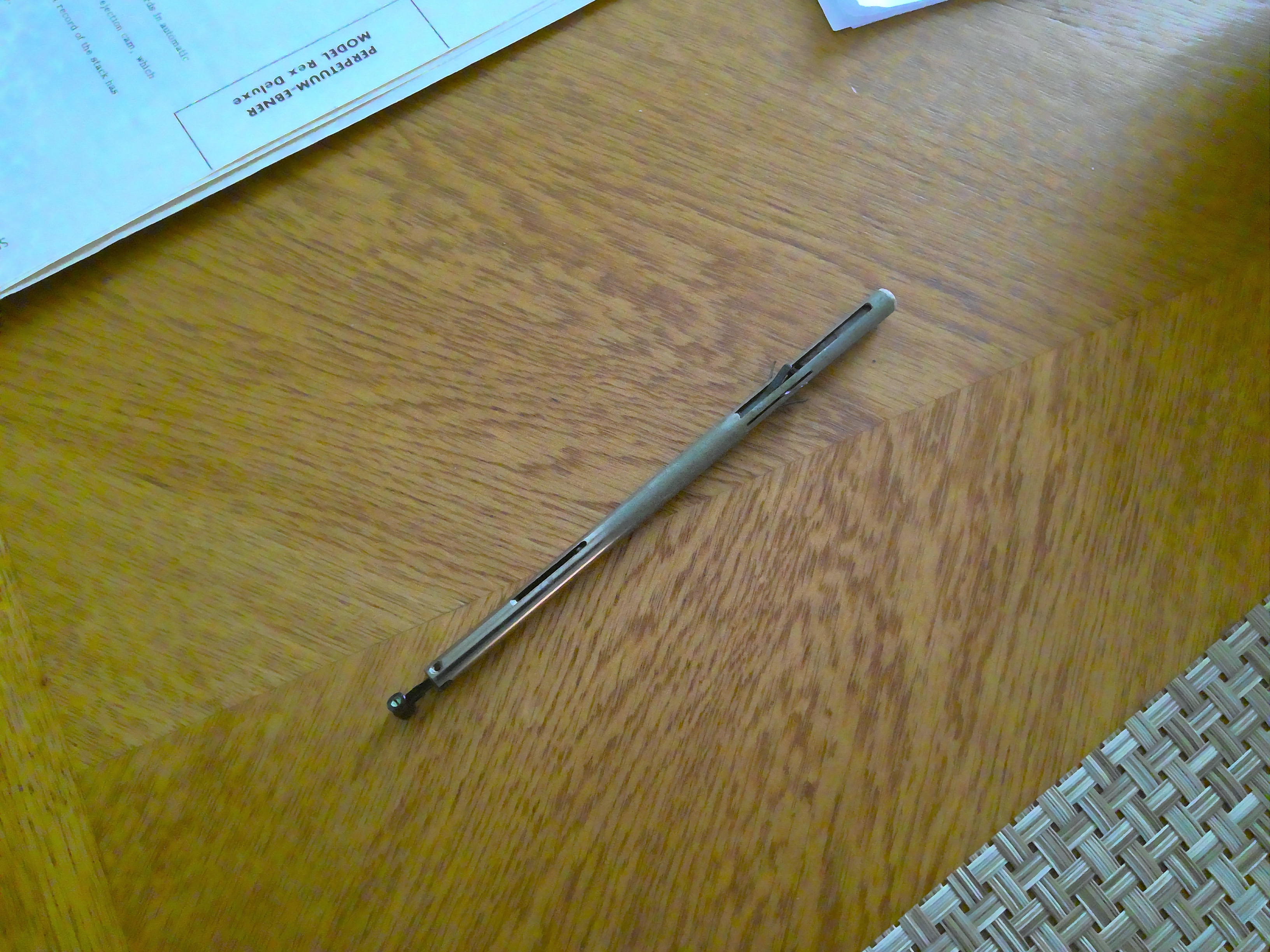

I have just adjusted the height of the tonearm to the required 2-3/4" above the platter when it is raised; I am not sure about the spindle.
It does go up and down but either the record does not fall, or they all fall, or the tonearm is stuck and it takes manually turning the spindle a bit and then something clicks and the tonearm returns and tries to fall on the record.
The feeler works.
The spindle is this (photo)
If the bottom small black cylinder that is used to pull the spring record holders down is pulled all the way, it feels that it clicks into that position.
I am not sure what it should be like. If someone knows please tell me. Including whether it is simply inserted in the center or it should be aligned in a certain way.

Yeah, me too, but the other day I looked up a Dual 1009 and I guess that Ebner was related. Anyway the discussion was on a similar spindle and the "small pieces of rubber" that provided some friction so that only one record drops.
That is it. Maybe yours also had some rubber parts that are missing.

Maybe...I am not sure how it would work with rubber pieces though.

I found the service manual (someone on the ARF pointed me to it).
It indeed talks about rubberized holders that do not let all the records slide at once.
I THINK I see them. It is either hardened rubber or it is gone altogether.

This rubber thing would be doomed eventually too. The changer relies on it for all the records not to fall down.
Unfortunately there are no good pics of it in either of the two docs I have.
I almost feel like becoming a RadioMuseum member: it seems like the best [lace so far with the restoration of German radios is there.
In fact I found a thread where a guy in the US needed the spindle for the same changer I have and someone there just gave it to him for the price of shipping it here.
