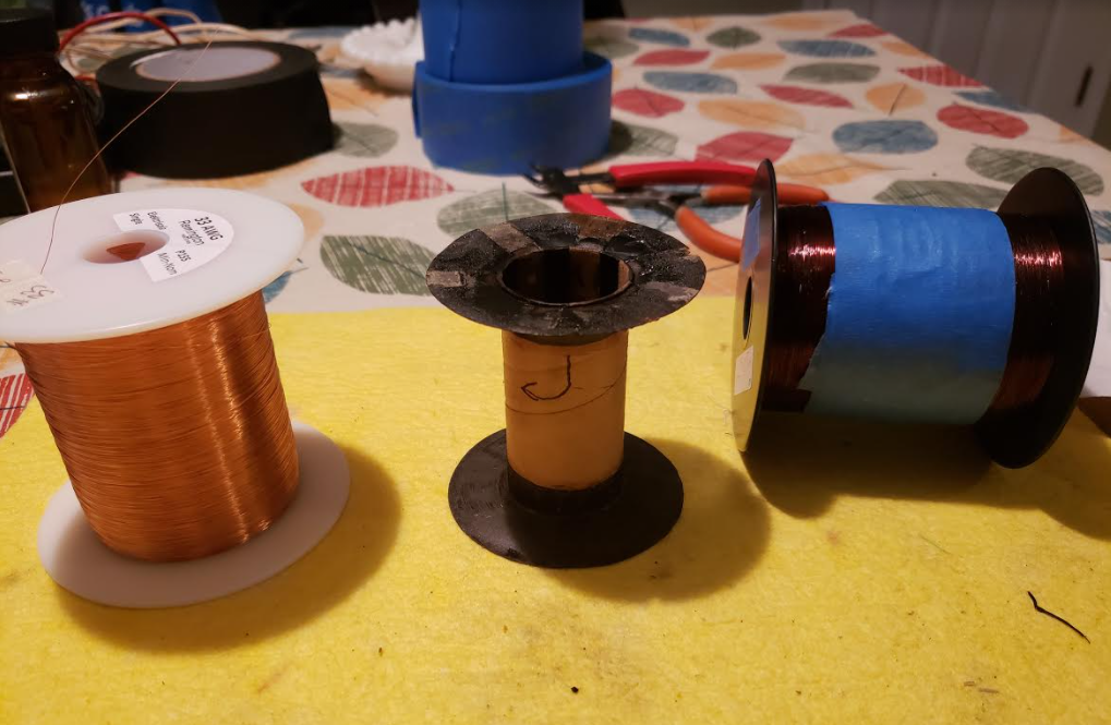

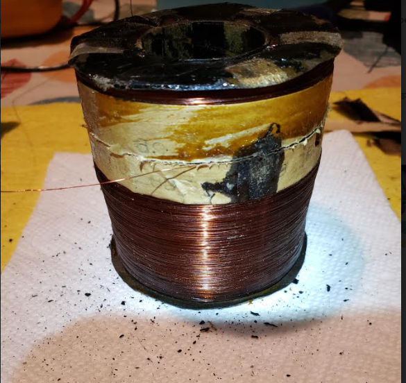

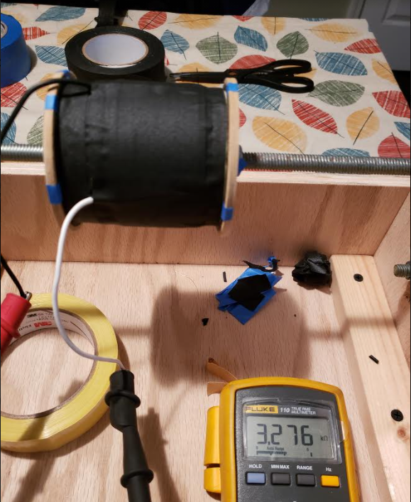

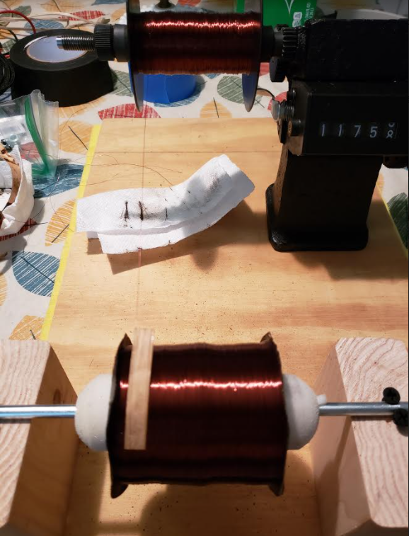

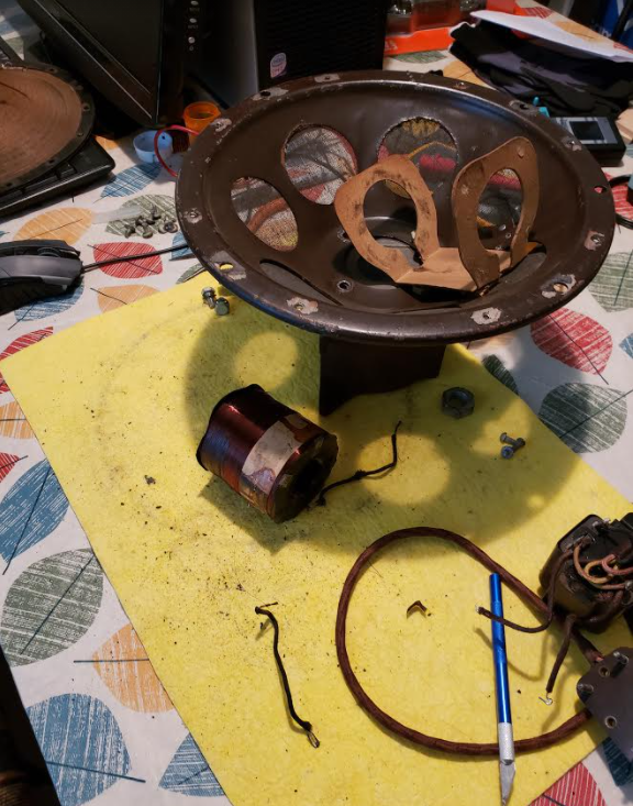

Its all back together now, and much to my surprise, IT WORKS! I had to build gadgets to accomplish the task, but I now have something to work with. Just thought I would post some pictures of my rewind.

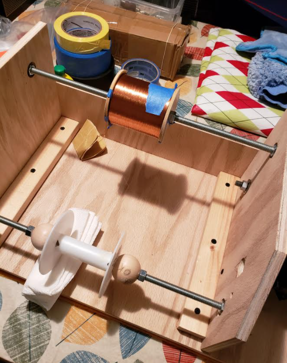

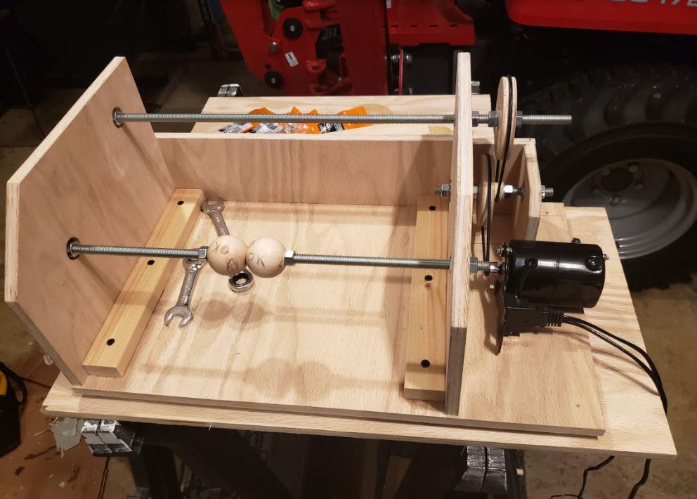

Nice work and .... from a guy who likes to build "jigs" .... nice work on the winder. Can you share what sort of rpm at the coil and how long it took to do the actual winding? The friction to keep the source wire from scrambling loose ... was that just those two wooden balls?
cheers !!
Hi John, I looked at pictures online but most everything was just a guess. I knew what I wanted it to do, I just had to match parts without a lot of trouble or expense. I ordered a sewing machine motor complete with foot pedal from amazon. What a piece of junk. I had to fix the pedal before I could use it. And even then the motor would just stop sometimes. I had to make a pulley reduction to get the rpms down to something I could use, as the motor is listed for 6000rpm all out. I used the foot control to vary the speed so I don't know what to say about winding rpms. Winding 15,000ft of wire took me about three hours with breaks. This was my first field coil, so I started out trying to wind it as neat as possible. About a fourth of the way in I gave up on that and just filled the spool best I could. Trying not to build up too much wire in one spot. The two wooden balls were not my idea, but worked well at holding the plastic spool that the new wire was on. If you look close you will see folded paper towels under one edge of the new wire spool. That kept the new spool from unwinding. Even as I was winding the coil I was thinking of things I will do different on the next one. I need to come up with some sort of guide for the wire. Fingers just don't cut it.

For results from a "by guess and by gosh" approach, I'd say you get five gold stars !! That's a jig that almost anyone can follow along with your photos to copy.

I used 400 grit sand paper. Very very carefully. Then checked for my resistance.
