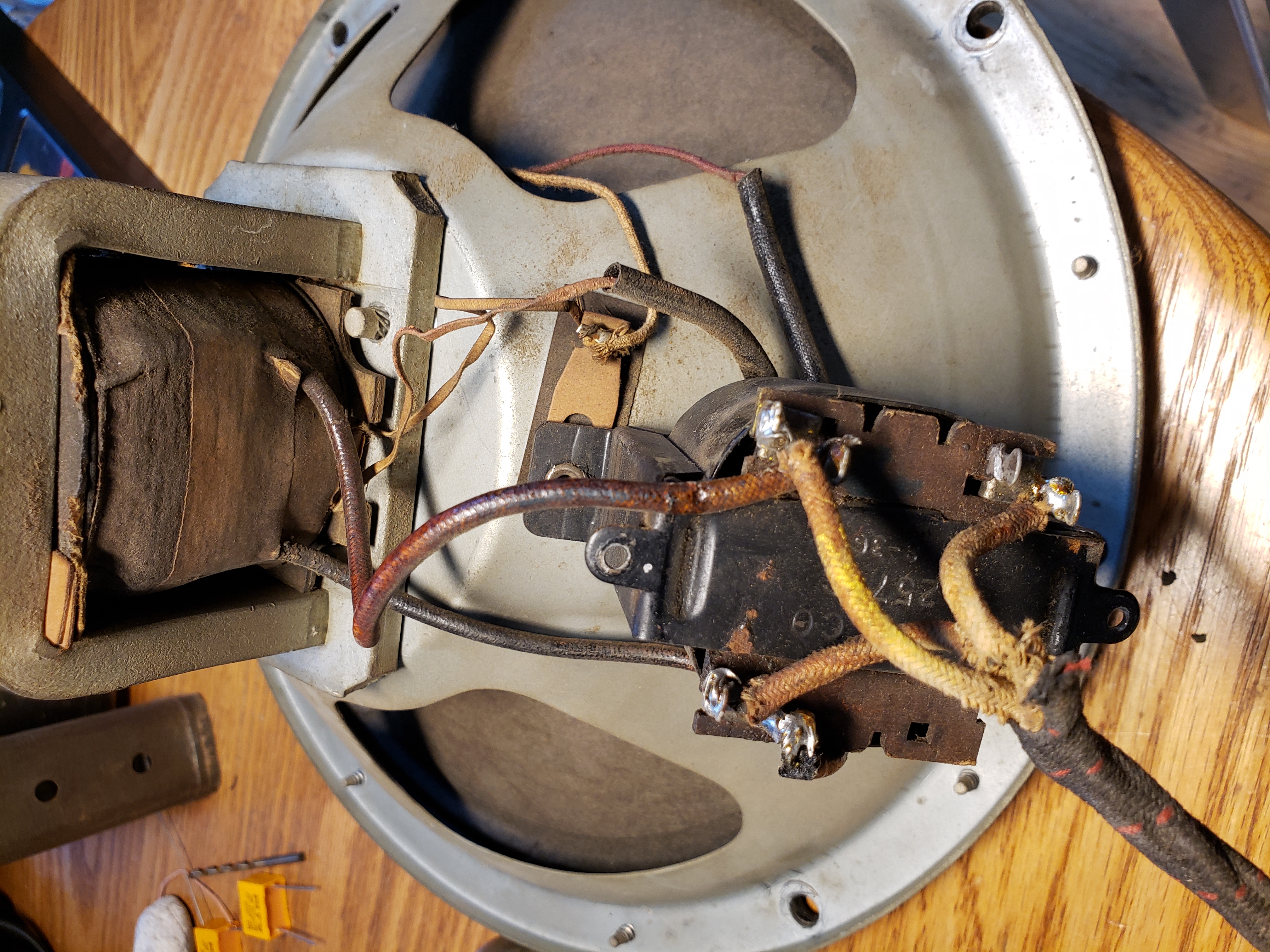

Another place where I checked voltage was on the 3 connections from the radio to the speaker. I have attached a picture.  Readings I get are Top Right 290V, Bottom Right 328V and Top Left 253V.  So another question I have is how do I find what is expected at these connections? Could this be my issue?

As for the spkr connector I'd measure voltage @ the 6F6 it's abt the same thing. Pins 4 screen grid and pin 3 plate will tell the health of the p/s and if the opt is good. Pin 5 tells if you've got the filter caps grounded to the chassis and much bias voltage you have on the output stage.
Terry:
I see #3 P at 247V, #4  S at 291 and #5 G at -16V on the 6F6 and 6.5VAC on the H. Not sure what the reading should be at #5?
Thanks.
Glenn
The grid bias voltage is spot on but the screen is a bit high and the plate a bit low. I'd have a look @ the screen buss and see if there anything gone amiss. Check the sm and maybe swap the 6F6 if you have spare.
Is your line voltage kinda high?
Thanks Terry, my line voltage is 121.4V. The set came with a 6V6 that I replaced with a 6F6 but both both act the same. I'll scape over the screen bus in the hope I see something. What should the target range be for screen and plate, plus/minus?
Glenn
The plate voltage is going to be the same as the screen except for the drop across the resistance of the primary the the opt. Roughly abt 10-20vdc difference.
