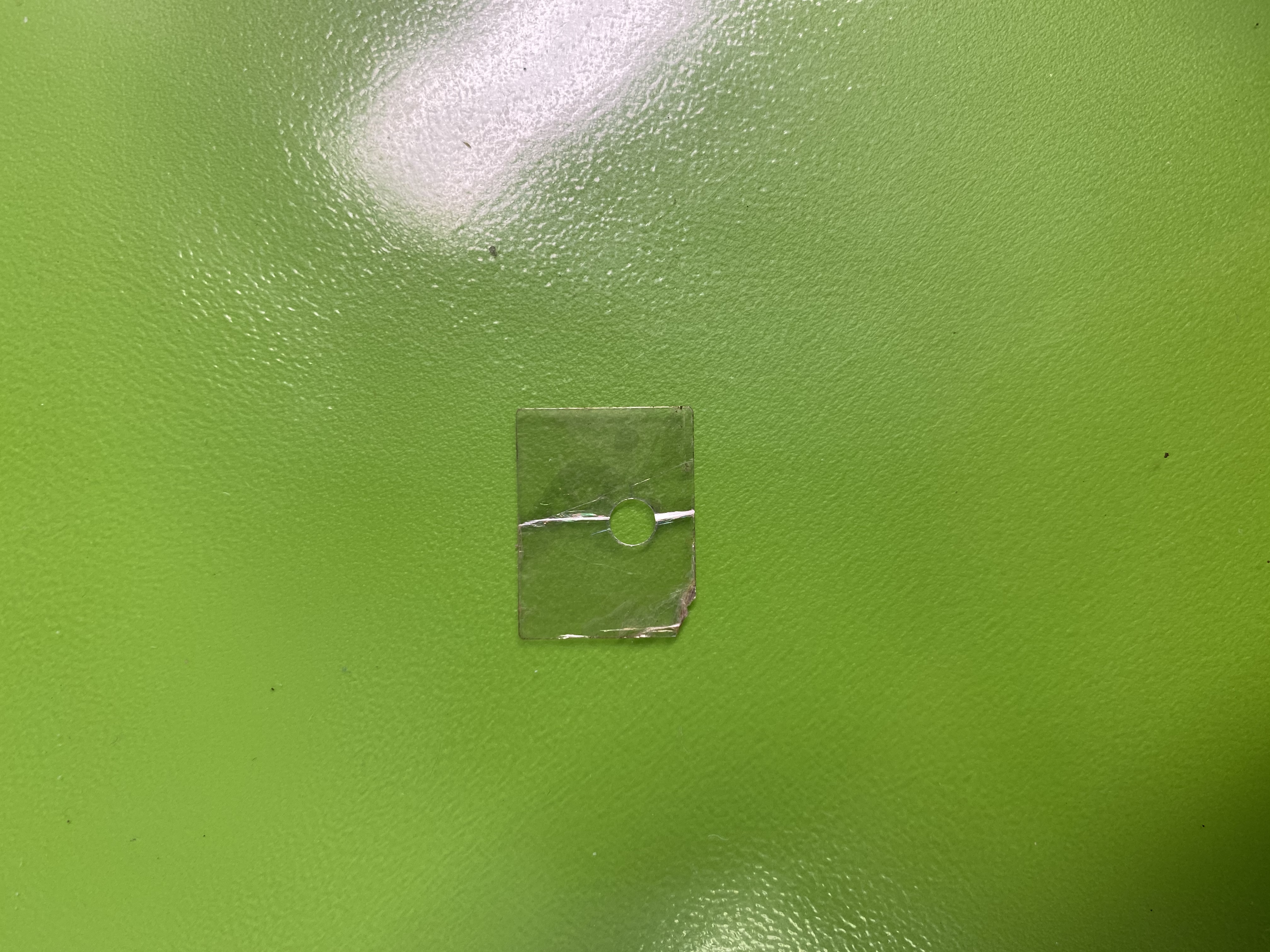

Thank you all for the advice and tips so far...now onto another issue. Can you get replacement mica wafers for the tuning condenser compensators (21A and 21B)...specifically 21B?  As you can see from the photo, there’s a piece broken from the edge and it’s cracked down the middle. It isn’t broken completely in two, but definitely cracked all the way across.  The smaller one for 21A isn’t cracked but does have a small chip on one of the corners.  Any help or advice is much appreciated!

Go to Google, type Mica Sheet, buy what you like and cut/drill to size.
I've had a lot of mica wafers broken in the corner like that. It usually hangs out past the capacitor plate and is subject to being broken. I've never bothered about it as long as the mica is keeping the movable plate of the trimmer from touching the stationary piece. Will probably work just fine with the crack as well. May change the dielectric constant slightly but compensated for by the adjustment. I vote for using it as is.
The mica pieces are in there to make sure the two plates of the trimmer remain insulated from each other. One can cut pieces from the thick, clear plastic used for clear packaging over many products these days. Just cut a piece that is the same size, or a tiny bit bigger than the mica, and drill an appropriate hole, and use that as an insulator between the two plates. It works OK.
