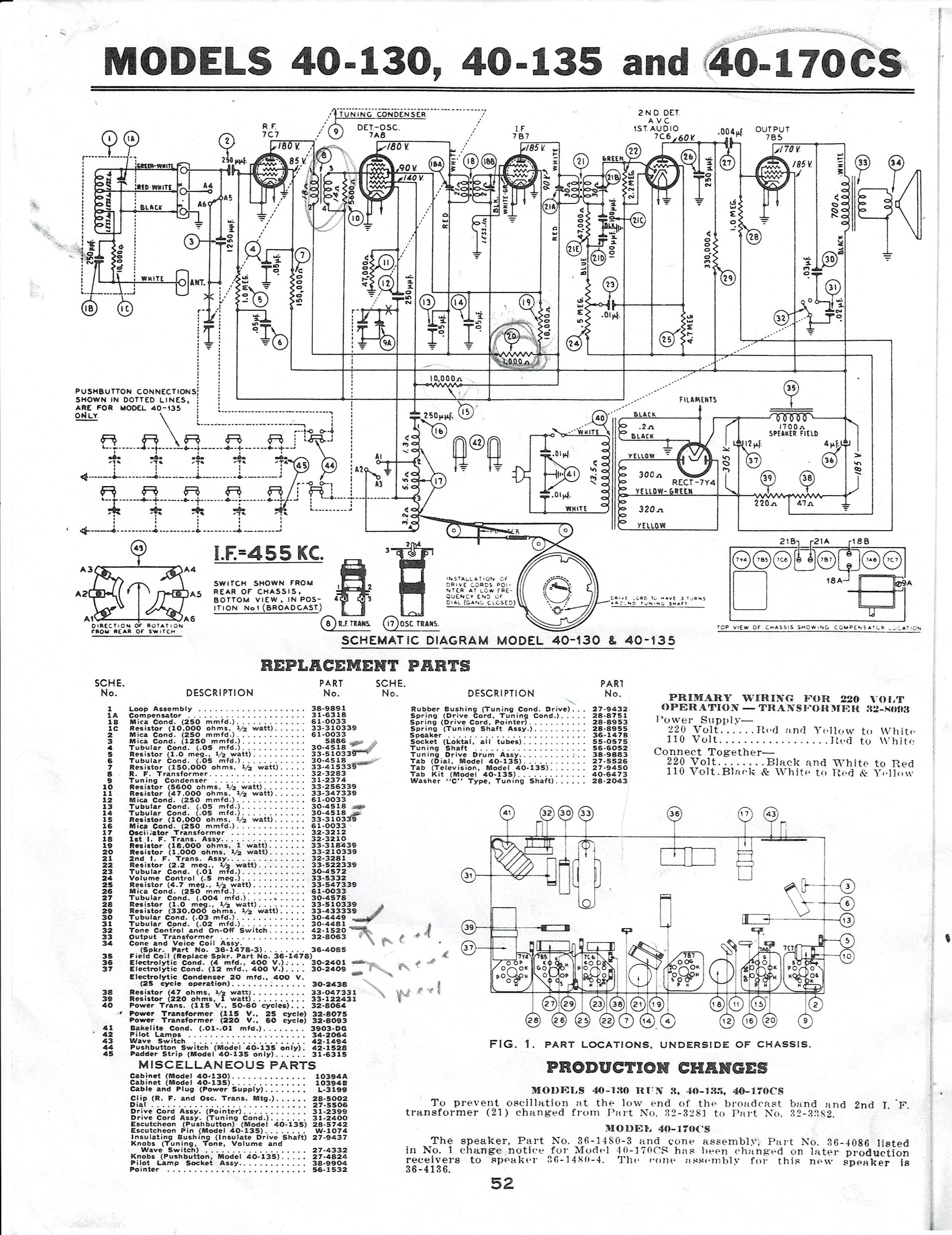

I cannot read either the Rider's sch (their numbers are illegible) or the one scanned here (it is not very sharp) so I could not say much.
If you re-scan it well, more folks could join the discussion.

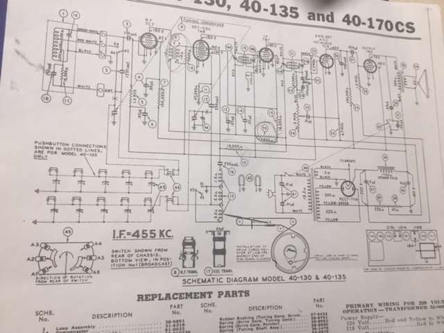

The resister and RF were actually smoking. Attached is a clearer pdf of the schemo . I will in the meantime look for shorts.

Or https://philcoradio.com/library/download...20Book.pdf
There is no resistor 20. There is a coil 20.
Can you circle in red the pats in question?
It feeds the plate voltage to the mixer and the rf amp, 1000 ohm.
Mike, it's #27 in Rider's schematic, 1k resistor. His schematic shows the same resistor as a fuzzy 20.
My apologies attached is the correct  schemo which more closely matches what there. The Rider's one is not accurate for this radio . Don't know why
