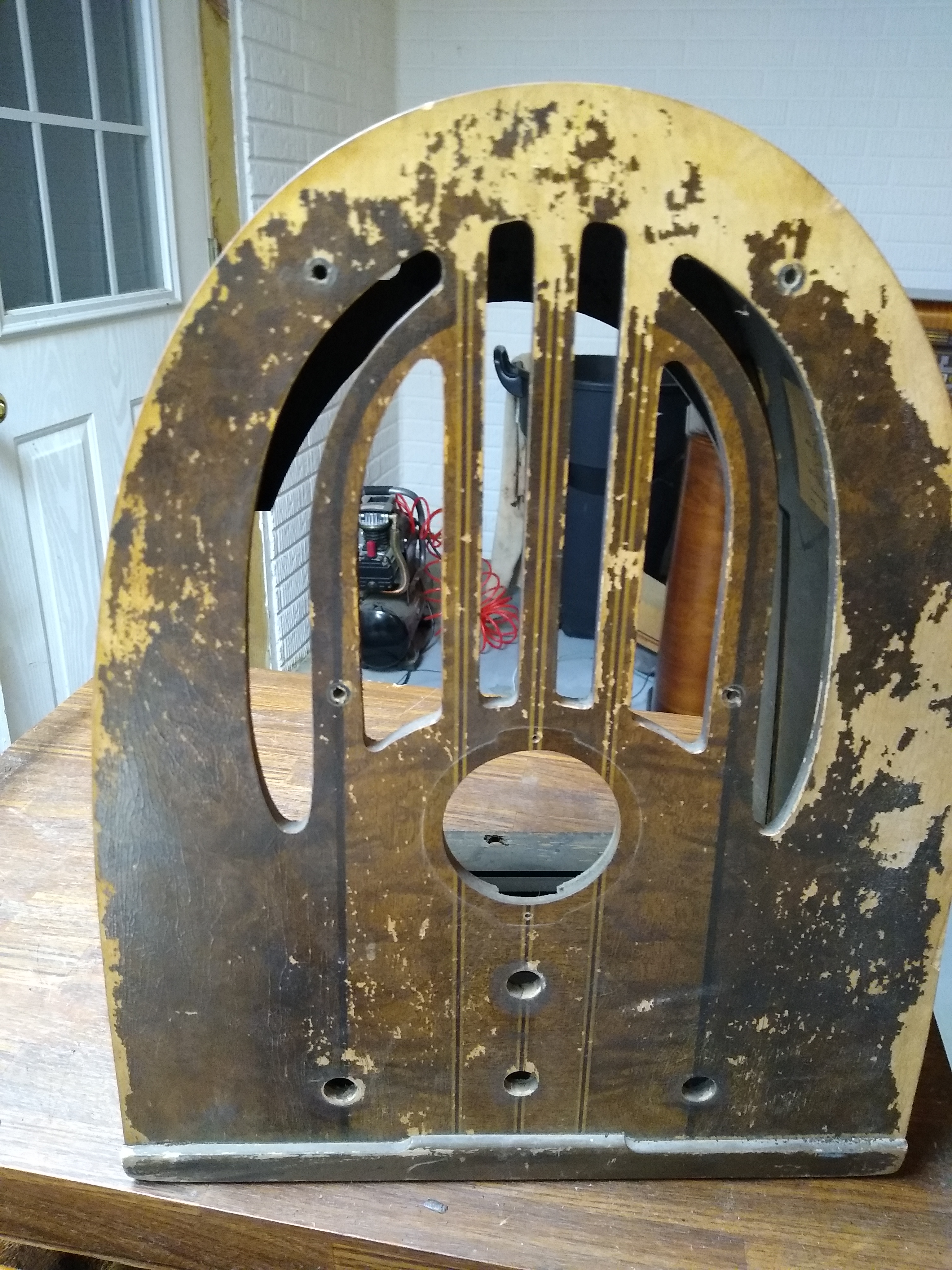

Hi  All,

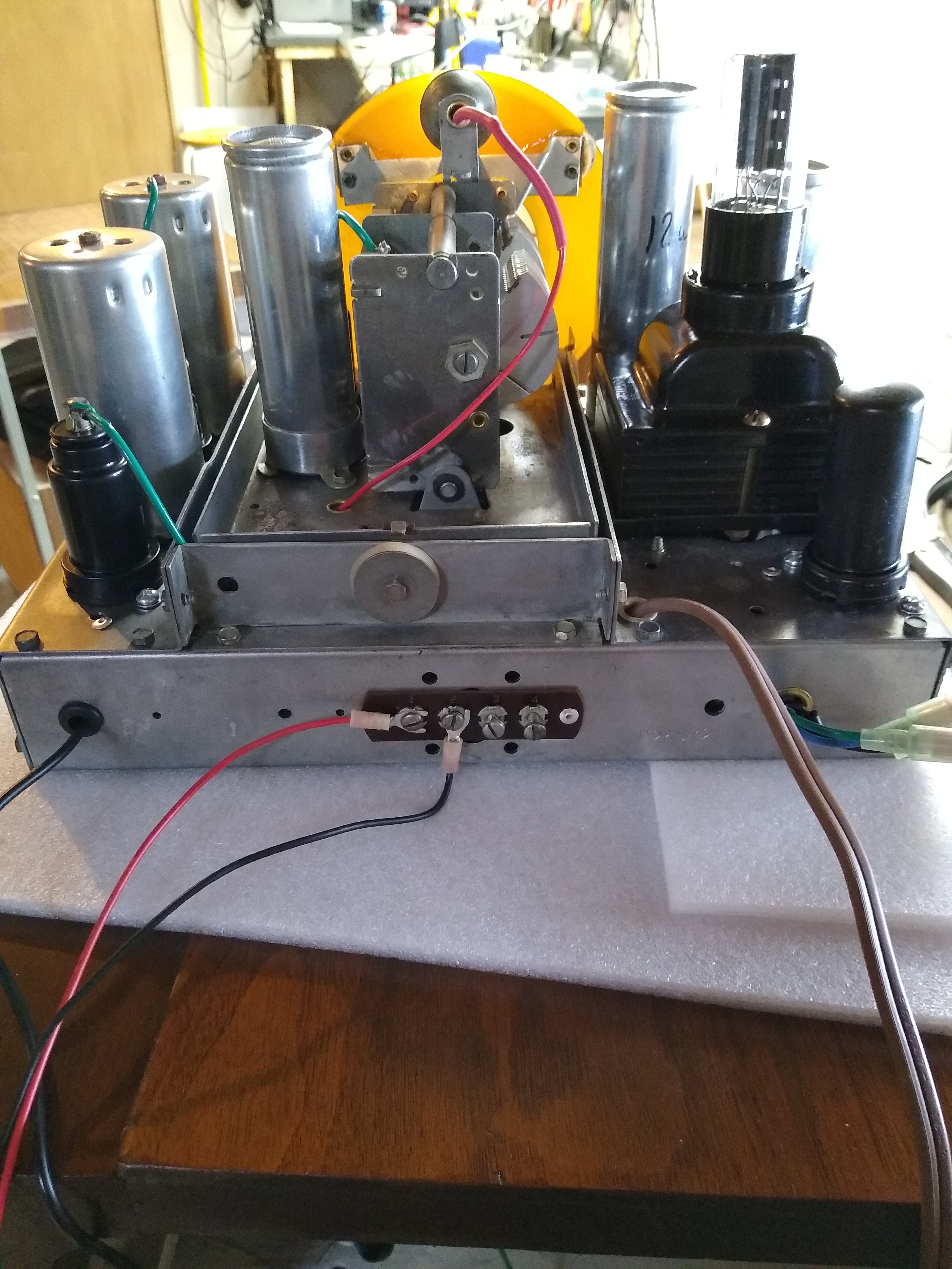

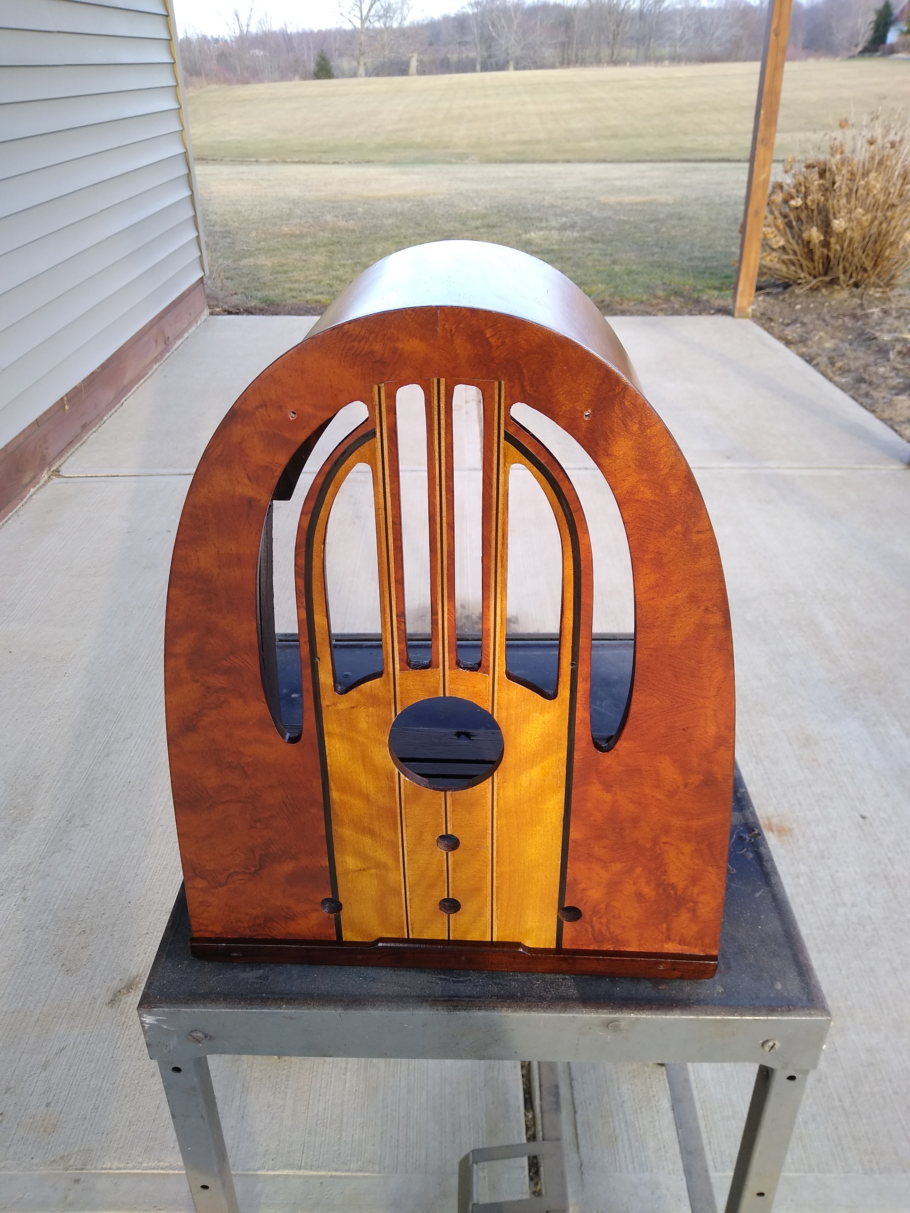

      My son got me this Philco 37-60 Cathedral for Christmas so I decided to strip the cabinet and try to reproduce the faux finish which was on the front panel.  Since no one makes the decals anymore one must do what one must do.  I got the chassis and speaker playing pretty good and they are in pretty good shape now.  Here's a peek at the chassis without the RF section.
Here's a peek after clean up and restoration
      So I used a combination of veneer and vinyl with some inlays from Rockler and I don't think it turned out too bad.  Here's what I started with
    This is how it turned out
     I would welcome your thoughts and critiques as I am always trying to improve.
      Thanks for looking

Great job, after is way better than before!
Nice!!
Excellent job !

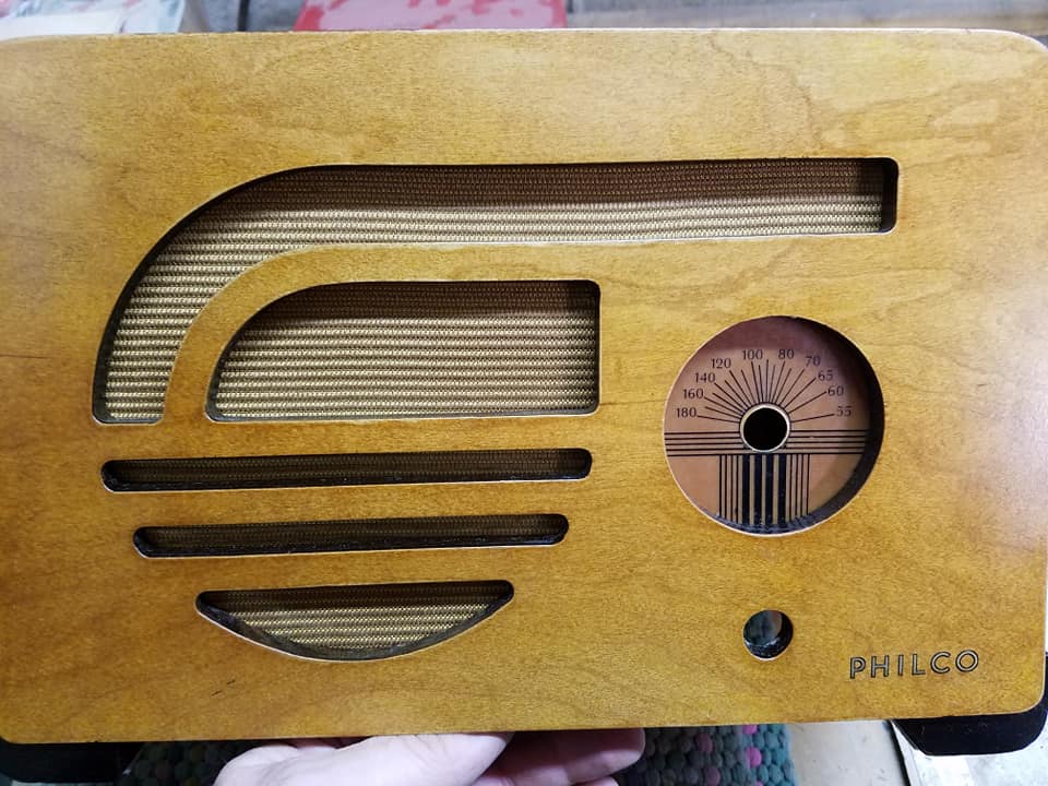

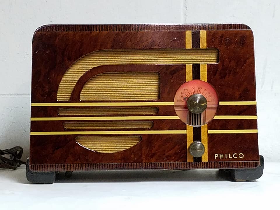

Very nice! I know what you were up against. I was faced with a similar problem last year on my 37-600 and used toners to recreate the faux finish
Greg V.
West Bend, WI
Member WARCI.org
Thank you all.  I appreciate the statements.  Greg, I love the way your radio turned out.  Using toners is an interesting approach.  Did you spray the toner on, then use a brush to get the burl look?  You could teach a lot of guys how to fix their faux finish radios.

Wow you did amazing job it looks great !

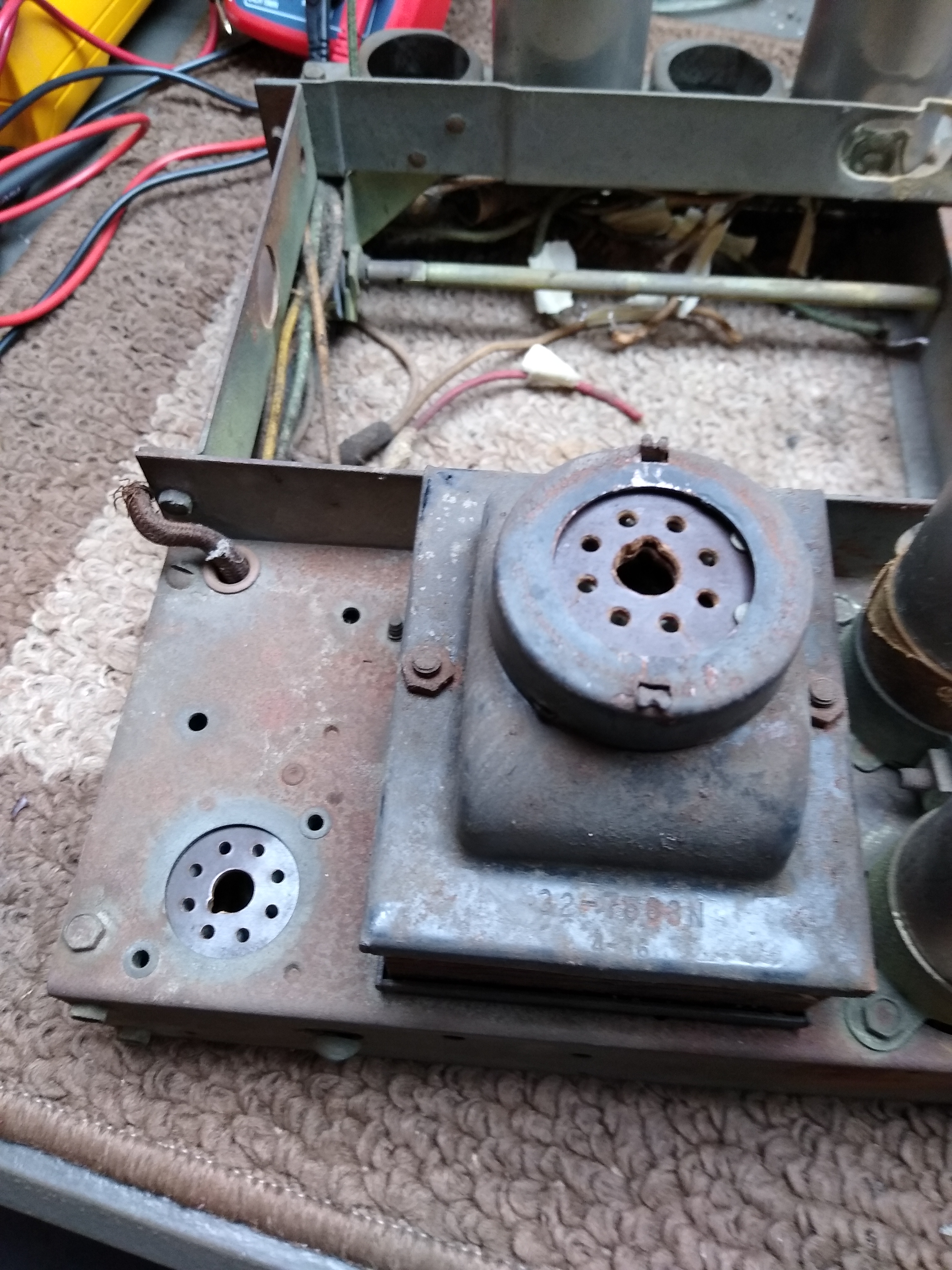

So far as the chassis what did you do to get to look that good ?
Greg ,I have the same radio and yours and I have been holding holding off on it's restoration because of that Photo finish .
Thanks Richard   As far as the chassis, I removed everything including the tube sockets.  I actually left the wiring intact for the sockets and drilled out the rivets and removed the 3 sockets and wiring in one piece.  Removed the RF section and coils and osc. tube socket in one piece and then the transformer, then took the chassis apart and soaked all the parts in Evaporust for 3 days.  Then with a little steel wool it cleaned up real nice.

Thanks, Dick. I sprayed some dark toner onto a piece of cardboard and used a piece of sponge cut to a point to get the burl look. Just lightly and quickly daubing it on.

Thanks Greg  I'm going to save this post so I can resort back and try your method next time I get a faux finish radio.  I really like that look too and that would be a new challenge.

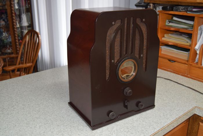

Here's a pic of Murf's 37-610.
This is the result of my experimenting with colors.
Replaced the veneer on the front, and it would not take stain evenly. Ended up with light spots on the new veneer.
So I decided to go solid color gel stain on the new veneer on the front, and antique cherry on the original body.
Looks pretty good compared to the way it would have looked with the splotchy looking front panel.
