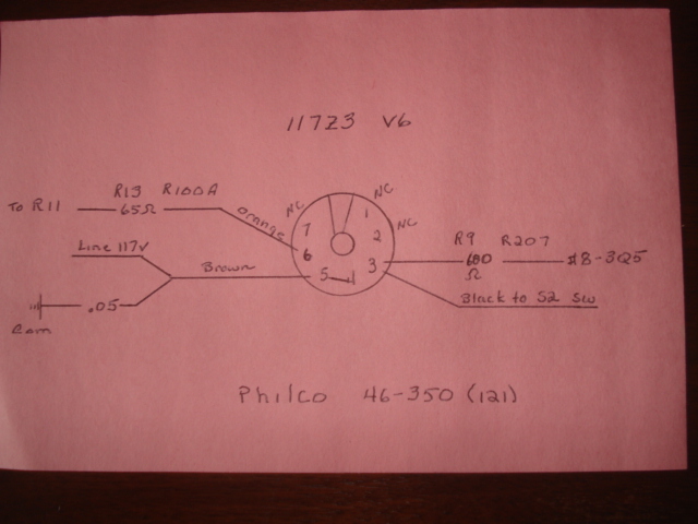

Hi guy's, I have replaced the capacitor's and some resistors and the radio is now working. Still have to check the voltages.
Based on the attachment picture how would I replace the 117Z3 with a diode. This diagram does not match up with any of the three schematic's that I have.
Also if I were to replace S1 battery/AC switch, would I just remove the battery cable and switch and then make the A/C line go directly to the S2 on/off switch.

For the 117Z3 The diode goes from Pin 5 to pin6. On the diode the cathode-pointy end goes to pin 6.
Be careful you don't overvoltage the filaments apparently they are very sensitive. A silicone diode only has about .7 volts dropped across it. Your going to get more for your money.

Why not just use the 117Z3? They are $4.00 at find a tube. Having a spare on hand, you’d probably be set for life.
If this set used a selenium rectifier, I’d likely replace it with a diode and resistor.
