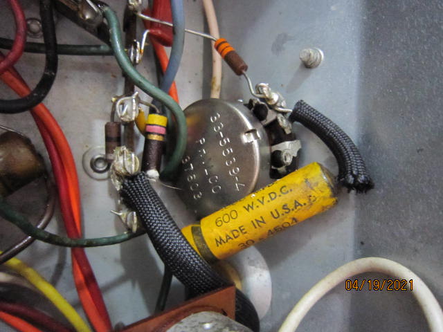

im in the process of recapping this set cleaning and so forth and i noticed the bass control has NEVER had anything more than a 33k resistor and a cap on ONE terminal.the other terminals have NEVER been soldered and a wire that would allow it to work is missing. its just there to fill the hole and does nothing. due to  the small speaker that was used in such a huge cabinet i assume that bass wouldnt be such a great idea. it also suggests that the chassis was used in console. would that be the case???
You assume wrong. The bass on the 48-482 is actually quite good, especially for a table model. I am quite surprised by hearing your description. Close up pictures would be nice. I must say yours is not the only instance of sloppy assembly found on a Philco receiver. I just found something similar on the 38-10 I restored, the two 100pf condensers that should have been in the 2nd IF can had never been installed ! As for the speaker, the original is not that small, it is a 4" x 6" electrodynamic speaker, which has a response much better than permanent magnet speakers, especially from that period. When you get this radio straightened out, I am sure you will be pleased, I certainly am with mine.
tried to post a photo buts no workee, the center tap gound is missing
so how go i post a photo? it worked on "new reply" but vanished in the ether.it said my message was too long.too bad it was a nice picture too

finally,and without further adieu
thanks ron
