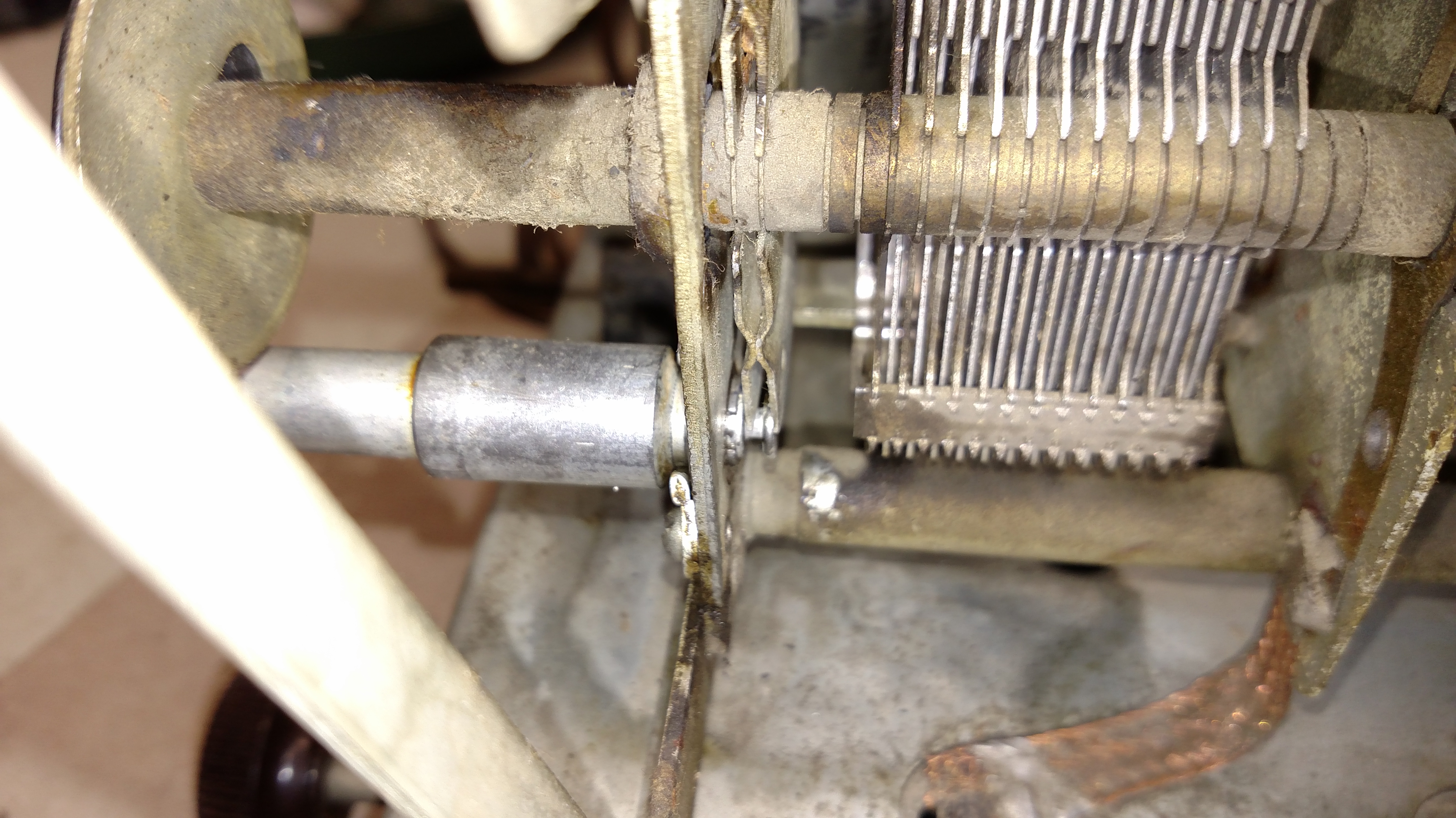

Can anyone enlighten me on how the tuning is supposed to operate? What appears to be some sort of friction wheel just slips without turning the tuning cap. The cap turns freely without effort, but the friction wheel ?? just slips.

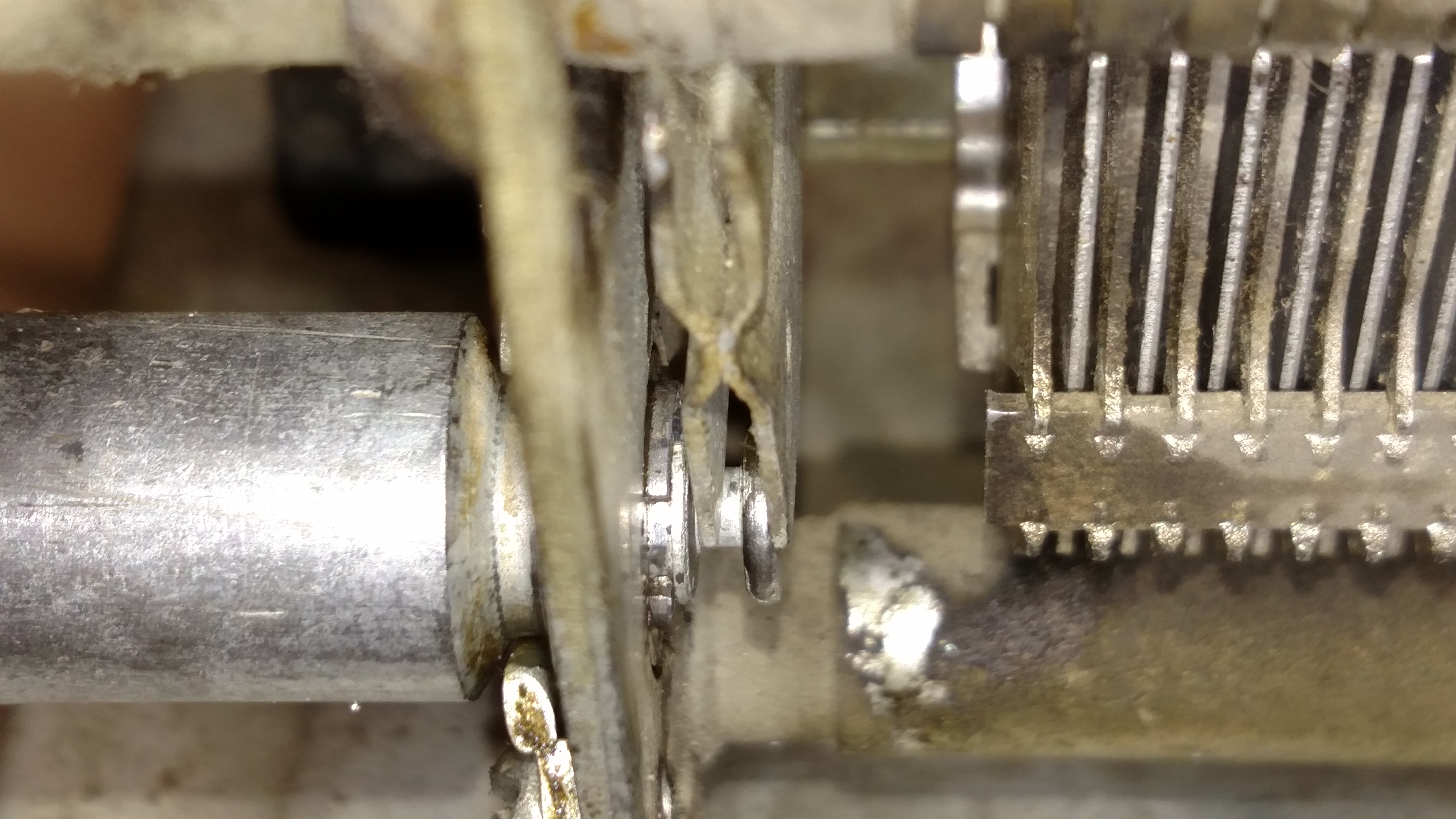

    Pics showing where the problem lies: When turning the tuning shaft the little wheel does not transmit motion to the bigger wheel.
Unfortunately I don't have any '38 Philcos with that tuning scheme around.
I would take a run over to the hardware store and check the O ring dept. Look for something that fit will over the large 1/2 moon section and that will fit between it the the small drive shaft and provide some friction.
Length isn't too important, it will need to be long enough to cover the 1/2 moon and a little more. You'll have to cut it and glue ends together, super glue should do the job or maybe you fit them into the 2nd crimp on the 1/2 moon.
Good Luck!
Thanks for the idea Terry, my tuner is now working! Now I have another question: can I, for checkout and alignment purposes, temporarily replace the shadow meter with a 1K resistor? I see that the 38-4 (without shadow meter used a 1K instead in the circuit).

I was way out in left field on the tuning system, it turns out after watching a Utube vid of the 38-5 BOTH leaves of the tuning mechanism belong in the groove shown in my picture. I caught a quick glimpse if it in the vid, and thought to my self "you dummy!" Oh well, live and learn! Also I was unable to resist the urge to "twiddle", and after a full alignment the radio is HOT on both bands!
