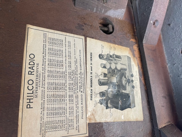

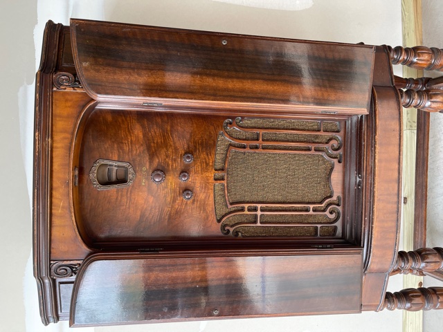

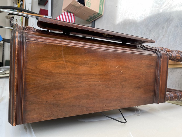

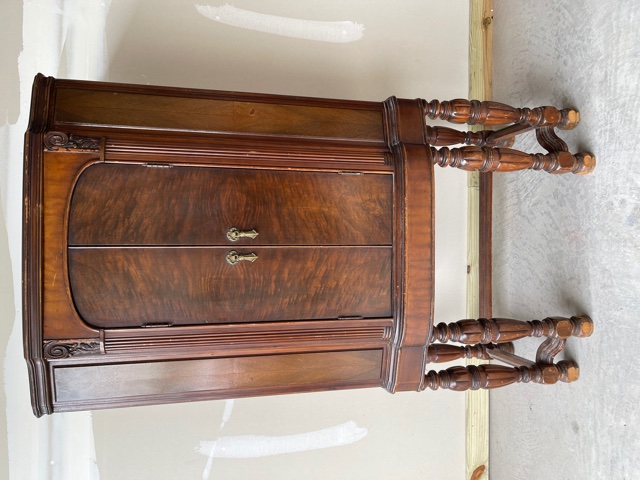

I was recently gifted an antique radio by my parents, and I'm trying to find more information about what it's worth and if / how I should go about restoring it.

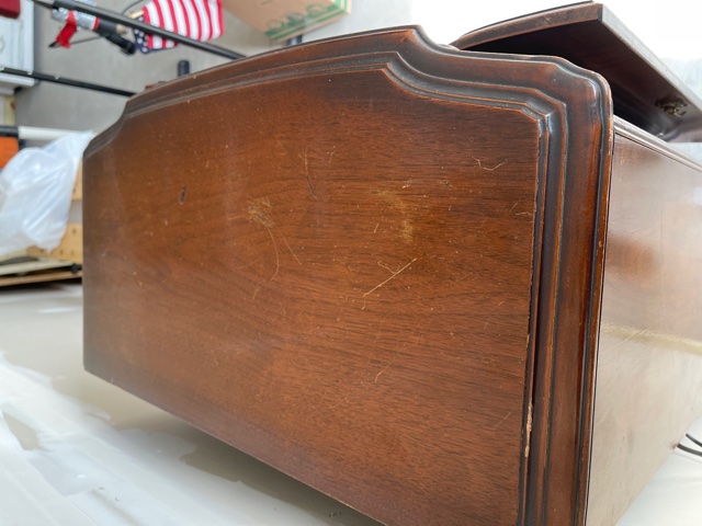

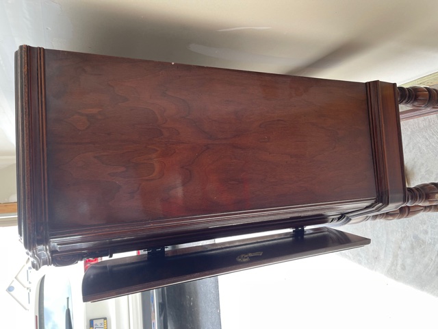

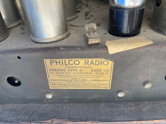

From the small bit of research I did - I found that it is a Philco 19D Highboy. It does power up, however can't get it to tune (not sure if this is user error). I do know it has a newer antenna attached, not sure if that's the issue. It's in pretty fair condition but has scratches and some peeling on the veneer.
Photos are attached, any input or advice is greatly appreciated!

That's a nice looking radio.  It will not play until the electronics are restored and its best not to power it up again before that is done.  Your first decision is whether to do the restoration yourself or have someone do it.  There are two parts, electrical can cabinet.  Your cabinet looks good enough that it may only need cleaning.  Often folks use GoJo (the version without the pumice!) to clean the surface of the cabinet.  The finish is lacquer.  There are techniques to just refresh the surface and cover to some extent the scratches and veneer can sometimes be glued down again.
The electrical chassis will need the electrolytic capacitors changed, all the paper capacitors replaced and there may or may not be other issues that need to be checked.  Read through some of the restorations that are found in this Phorum to get an idea of what this might entail.  Another good overview for beginners can be seen in Phil Nelson's website.  If you decide to tackle it yourself then this Phorum's electrical section is the place to start a thread for your radio and ask all the questions you want.  Folks here can help you through the process.  Its not a full tutorial but I have a thread for a 91B restoration that has the same chassis as yours.

As far as value, its harder to assess but as it is its probably a $50 to $200 radio depending on whose buying, where its sold and its actual condition.

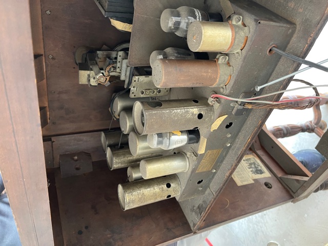

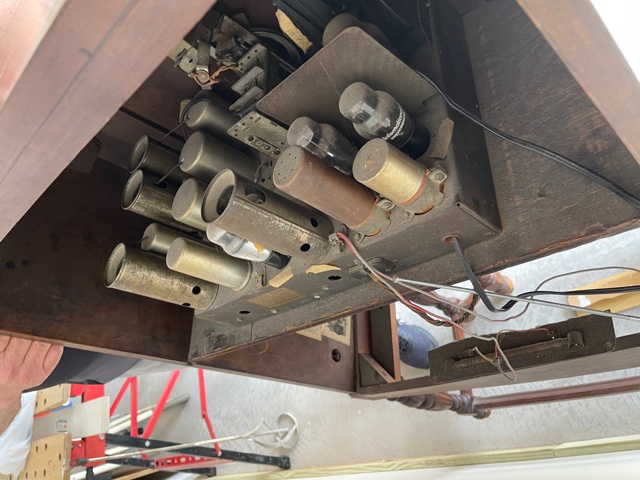

I would remove the chassis from the cabinet and have a look at the underside. That's where you can see what work has been done to it over the years or not. Refrain from turning it on as it can cause damage to internal parts or cause a fire...
To remove the chassis there are 4-3/8 bolts under the chassis that have to come out. Remove knobs by pulling straight out. Loosen or remove the small screw that is above the speaker plug on the back of the chassis. Remove speaker plug. Slide chassis out. Flip it up and take some pics. Post them so we can get an idea what's been serviced.
Worth, if your thinking of fixing it and selling for a greater profit I would sell as is. As a rough number I'd say about $100 as is. Maybe $150 in good working order. Have to find the right person for the highboy cabinet set.
