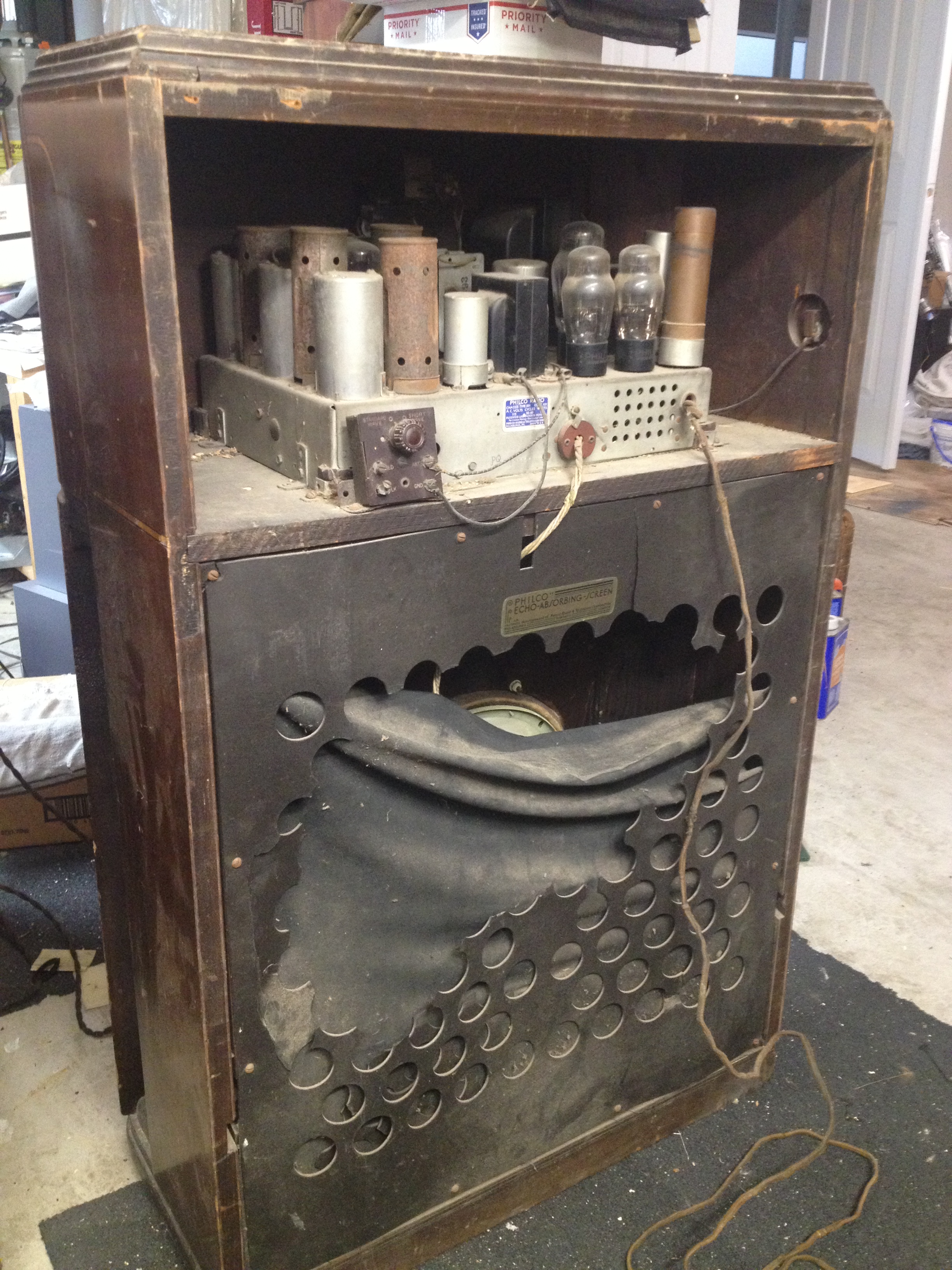

Part 1 About 6 yrs ago I picked up a 200X @ Ktown for a reasonable price. Got home and gave the hairy eyeball to find that the chassis had been significantly modified. All of the IF transformers had been replaced with standard replacements (no tertiary windings), no IF trimmers under the chassis, and no 10kc filter. This means no hifi. So being the optimist that I am I'll see if I can find some original IF transformers. That didn't work out. Then I started to look at the 201. That might be possible the frequency is a bit higher (175kc vs 260kc) but if I could get the osc coil too that might workout.
Part 2 Started on that. Gary over at PTOTP had a 201 chassis and I asked him what he would want for it. He said that it was too heavy to ship what parts did I need? IF transformers and osc coil. Ok. I asked if he was attending Ktown and he gave a positive reply. Why don't you put the chassis in your van and we'll a cut a deal for the whole thing? OK. A few months go by and Ktown is here. I get there and am hanging at the Philco booth but decide to take wander to see whats for sales around. Get back to the booth and there was 3 IFTs and a osc coil waiting for me. Later settle up w/Gary and got home. Was happy to get the hard to come by parts but still some hurdles to overcome.
Part 3 I was thinking that the phasing of the tertiary windings would critical and sorting the osc coil connections may be little bit of a task too. Mean while I had a bunch of other Philco projects going. A 116X,116B, 660L, 42-854, 16B, several 84b's, 80, 39-80, and 41-300. The 200X has been around for a while! I was talking with Kirk and found that he had done a basement cleanout and gleaned a 200/201X. Originally I wanted to borrow the chassis and or service it for him so I could sort out this 200 w/the wrong IFTs I was getting to build. We ended up working out an arrangement for it.

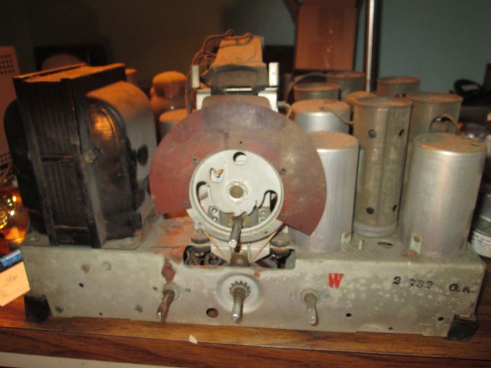

Part 4 The condition this set well the chassis is pretty good. It's had some repairs done over the years but all done neat, nice and well. The cabinet is kinda rough like a keg of ribbed drywall nails. That's the bad new but the good news is that I have a 200X parts cabinet.

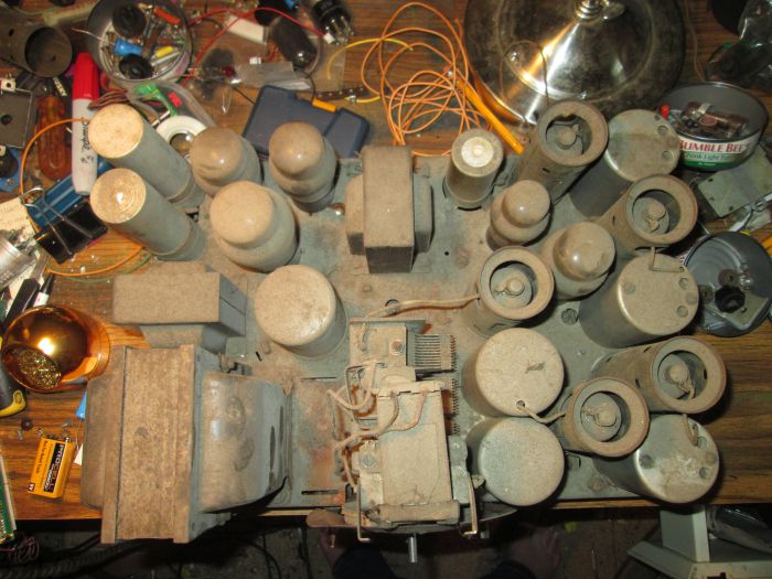

Back to the electronics side of things. There is two different chassis configurations for the 201. One has a bunch bakelite blocks. The other has a phenalic board in the center with a half doz tubular cap on it. This style is the one that shown it the service information. I  found a clue that there was a service bulletin on this set. Eventually I posted over on arf and EGG (Gregg) helped find the sb which was in our library. Just wasn't listed by model but by date first. It's #209 https://philcoradio.com/library/download...es%202.pdf I did find out that there are couple more of the odd sets around. Waiting on some parts to come over the bridge from NJ before I get started on it. Fun begins...

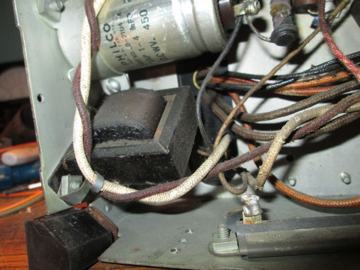

Big order from Sal came in so to thought I get started on the 201. Cursory look told in was pretty good but I was a little troubled by # 98. It's a 70H 10ma choke that supplies the B+ up to the mixer section. Connected right after it is a 4mfd cap.
Looked kinda burnt and didn't smell so hot either. Check online and found this:  https://www.aliexpress.com/item/4000879432503.html Philco used high inductance low current chokes. Ron was looking for one years ago for a 600 series set.

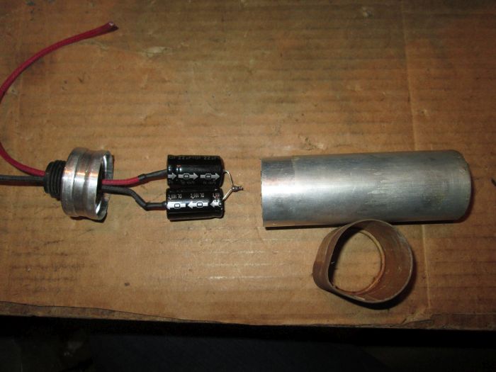

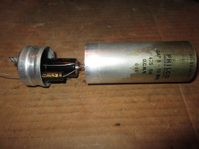

A little dusty.     Gotta get some oms after that dial      Got #102 out and cut it open. It was a C/D replacement so no tabs on the bottom. Replaced the innards with a pair or 22mf in series yielding 11mfd @ 900v. Just did it to raise the ripple current rating. The answer to the next question is I'm impatient and lazy. Hopefully in the next day or so I can get the 8 electrolytic caps rebuilt.

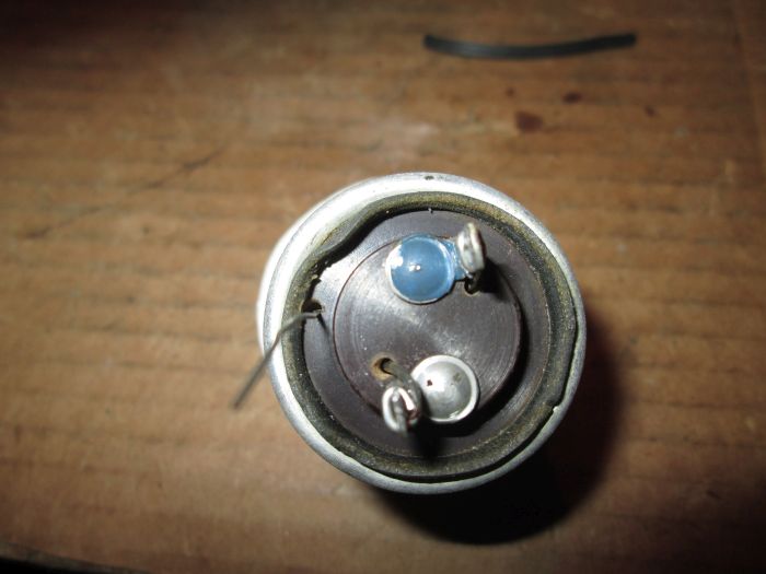

Here's #101 it's the tricky one. Blue terminal goes to the + of the 8mfd cap, the silver terminal connects to the junction of the - of the 8mfd cap and the + of the 10mfd @ 50v. The - of the 10mfd @ 50v connects to the tab/shell or to the ct of the hv winding.

I'm working on the 201X in another thread that has the 10KC filter, where the #70 choke was eaten up by a 4 legged critter. Any chance any of those donor units has it ?

To answer your question truth be told I do have an original choke. With being said I'm not sure what is going on with the 201 that I'm work on. It has an iron core choke in it's place. Not sure if it's a updated Philco part used on the later revision. Didn't see a part # on it so for now I think I'm going to hang on the spare.

I saw the iron core tranny you mention, in the photo you posted. I thought that might be part of the 10 KC filter. That's interesting, since I don't see that as a change they made in any the service bulletins I got from Chuck, hmmm   Any chance you have an inductance meter to measure it with ??

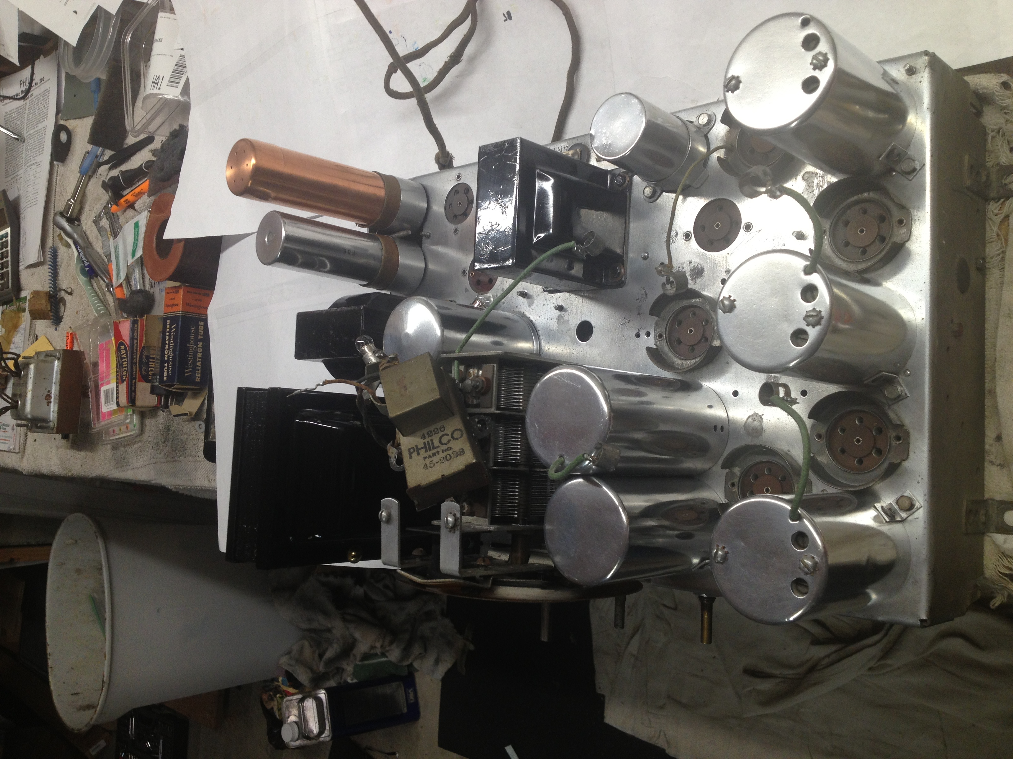

If your going to clean up the chassis, it was quite the chore on mine.  A couple of the RF/IF cans are riveted down and others have the classic Hex head screws ( not sure why). To make cleaning easier, I drilled out the rivetted ones to remove the cans, then used some hex head screws from a bone yard philco to mount back down, They match the others perfect.

Mostly servicing and cleaning as needed. If the IFT grid lead's insulation is failing I'll pull the cans off replace the wiring. Clean the dirt/dust from the trimmers and use a soft Scotch Brite pad the remove the corrosion from the cans. I want it to look pretty original if possible. Will replace the known foul players e cap and foil/paper caps. Check audio transformers, resistors, chokes/field coil, and sm coil. Even though the 70H 10ma didn't look so good nor smell so good it was ok. You are lucky those 6-32 screw in the tops of the IFT can be a little devil to get out without breaking the screw or the ceramic.

Have been waiting on some parts to come in but in the mean time tested the tubes. All better than 75% except for the 37 open heater, 6A7 usable as is the 75. The dead 37 wouldn't have been a show stopper just would prevented the shadow meter from working. By all appearances the chassis had been well maintained over the years, just sat round for a long time. The cabinet is a different story.
Still have a couple of blocks to do and a tubular to replace. After that I've the a cloth cord and acorn plug to fit. Then the fun really begins...
After taking a long sabbatical I've gotten back to the 201 chassis. The up date is all the caps are done and resistor are check/replaced. Powered up w/o 5Z3 and the lights in the room didn't go off when the radio when on. Had 410vac either side of center of the hv winding which is good. Tubes lit as did the dial and the sm. Plugged in the mighty U7 with Homer attached to pin 1 of the 5Z3 and the chassis. This is just to see if anything catastrophic a second or so before it happens.
No big surprises. Hv went high up and drifted down to about 385V. A nice hiss was emanating from the speaker. What the heck hooked the 120' dipole to the ant post and had stations galore on BC and SW.
It's been playing for about 4hrs w/o a hiccup Took a look at the voltages on the 42's (output) 365v plt/scn -37v cg.  A little more juice than the average table radio. PT is running cool.

I did have a question. I'm missing the shielded wire and switch for the bass control. The parts aren't the problem but I'm not sure where wire exits the chassis. Does it come out by the dial drive? I know it connects the block by the volume control. Does the wire run under the chassis?
The Cousin been on for a bit now coming like he's in the room.
You may have figured it out already, but that shielded wire for the Bass control comes out the side of the chassis to a switch on the side of the radio (right side in photo). Seems like a goofy way of doing it. Seems like it should be a control on the front.
