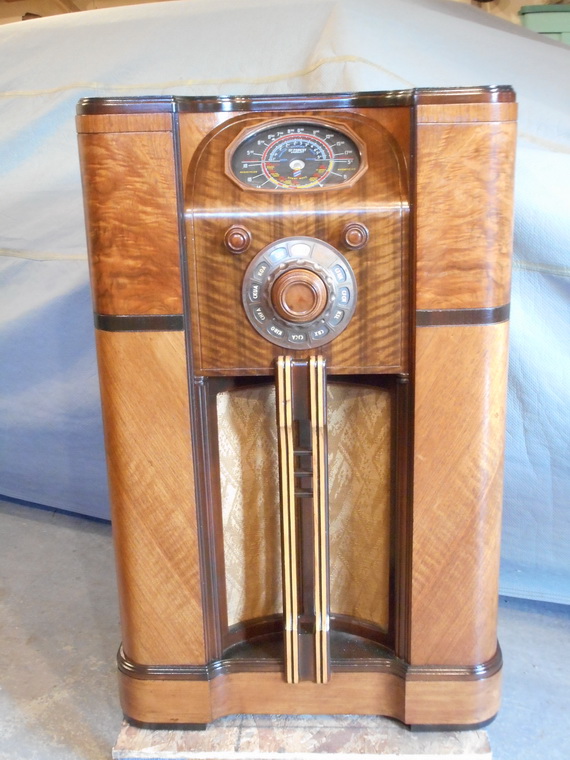

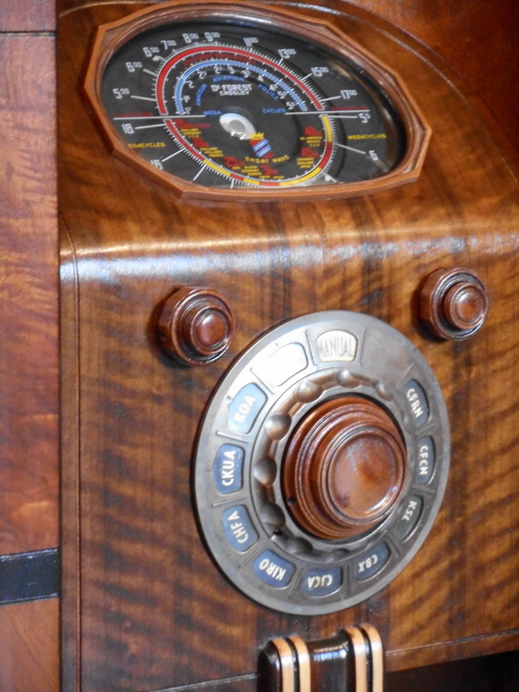

This radio was on Kijiji last fall ,and since it was 300 miles away I met the seller half way.
    It is a DeForest  Crosley model  7D932
 There was a fair bit of wiring that had to be replaced and the tuning system uses a cable that was broke.

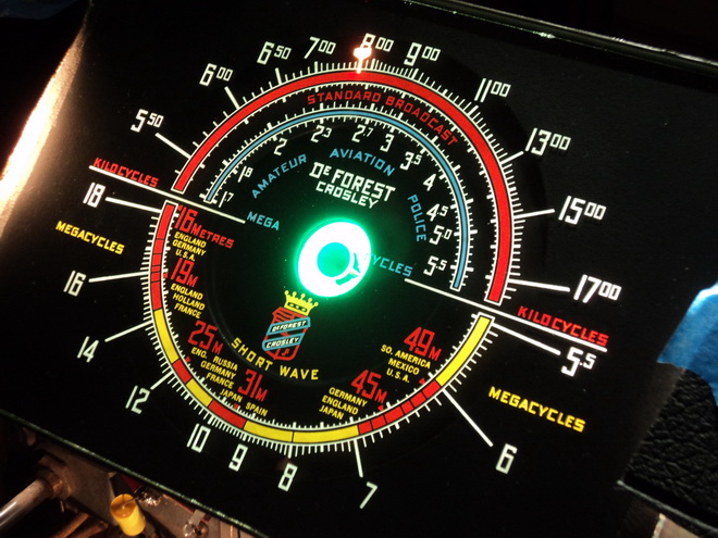

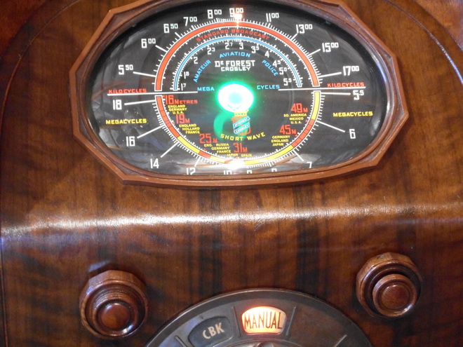

 After some work I got it all working and installed a new eye tube.
 Originally the eye tube was a 6X6 and someone had installed a 6E5.

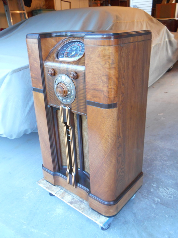

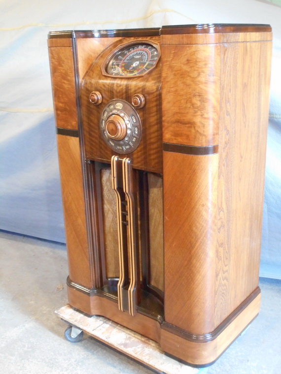

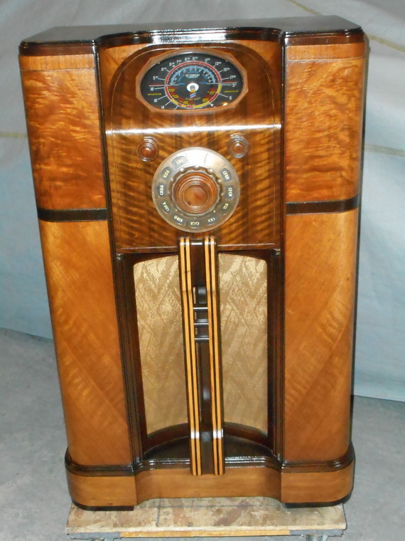

 I had to replace the whole top veneer and I am glad I did rather than patching it.
 I really like the dial on this one, because when you change bands,  a lighted pointer lights up and rotates around the dial.
    Each band has a different colored pointer.
 We finally got some warm weather  so now the cabinet is done.
 Here are the photos.
 Dan in Calgary.

Nice!!
Icon_thumbup
A very cool radio!
A real hum-dinger!
Beautiful!
Dan what a beautiful console. Hope it works as good as it looks. Let us know. Thanks John. Icon_thumbup
